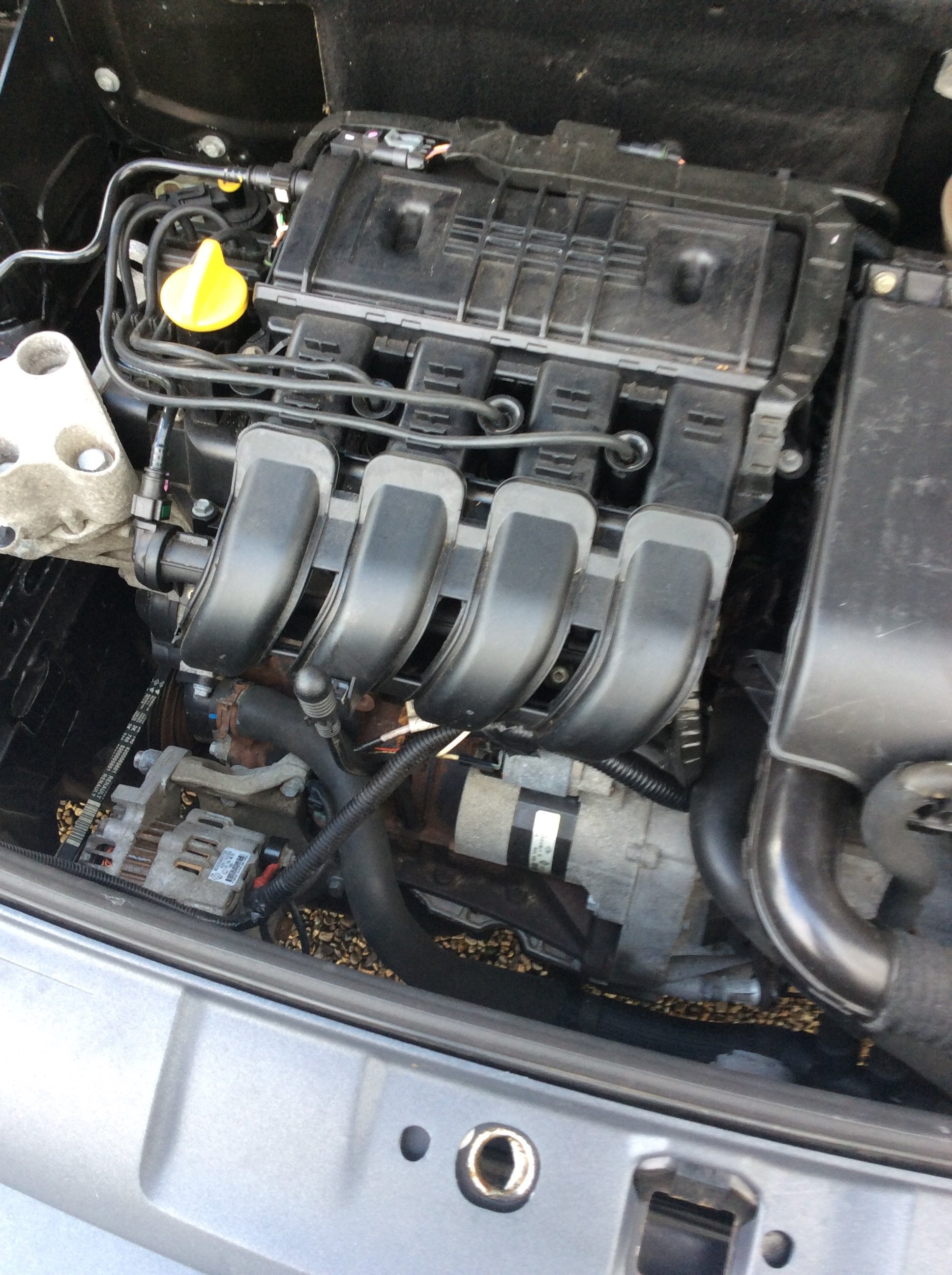

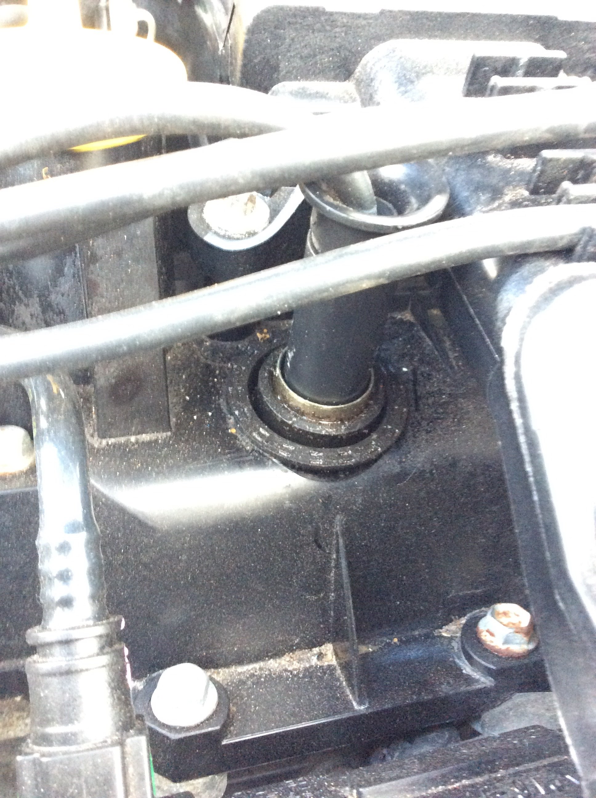

Anyone know how to remove the spark plugs on a 1.2 Clio 16v 2003? I have a 10mm 3/8 socket. But can't get it down the hole. This is what my engine looks like. Looking down the hole I don't even know if I can see the nuts for the sockets to go on. Made me think I had to remove the circular thing in there too.

Hi, yes pull the ht leads up by the plastic body not the lead! Then you need a 14mm spark plug socket not the common 16mm one. You can buy the socket online. Give me a shout if you want a link to the right one.

Are you using a 1/2 inch socket? Here's an item number to the tool you need so you can see it 221197587139 (ebay)
