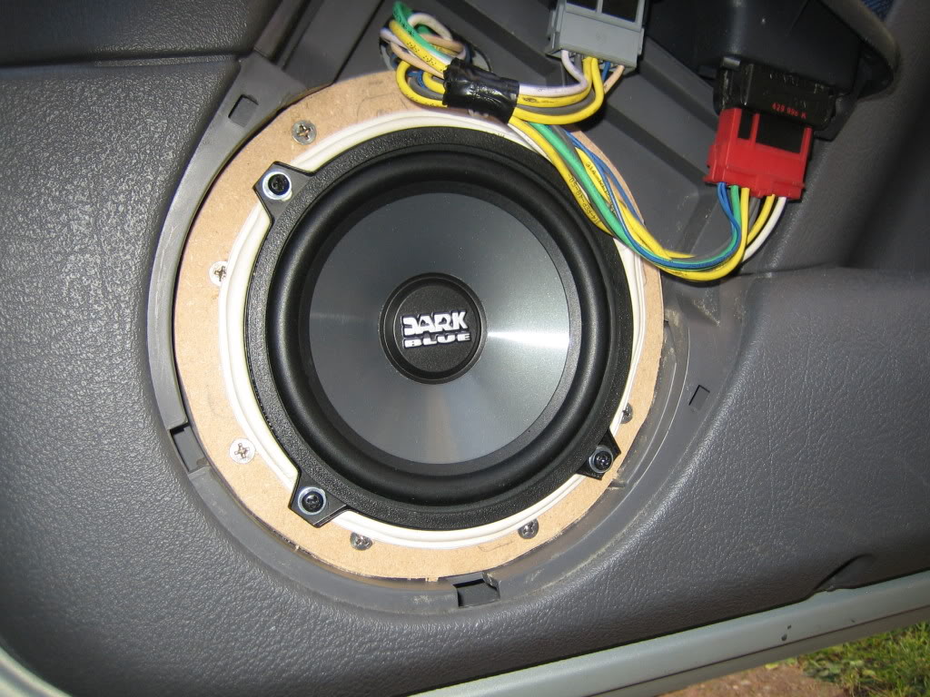

Fully boxing in your mid bass speakers will make them sound pap.
They are typically designed to work in 2 cu ft of air ( that of the door )
And MDF baffle is a piece of mdf attached directly to the METAL of the door (means cutting away the existing plastic) to provide a tighter fit, ensuring better mid bass response.
Deadening can be beneficail aroudn this baffle. However it's nothing compared to doing the entire doors. I persoanlly wouldn't bother with deadening unless doing al the doors.
A good solid MDF (or equiv) baffle if a good step, it also can allow a larger size mid in place ( upto 6.5) (thats what i have in)

Thanks for the reply and picture its very helpful. I'll have to look into doing some baffles then. Do they make a huge difference?

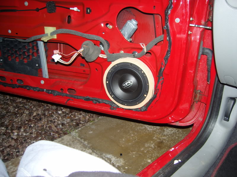

you can buy them off ebay or a shop pre made but could be pretty expensive. i just made a template of my speakers and cut them out with a jig say and cleaned up any edges with a bit of sand paper. they obviously have some tiny wobbles here and there but it doesnt effect them attall they still work great.
i was only fitting 13cm components and didnt really want to cut away the plastic of the doorcard so i siliconed them to the plastic and put 8 selftapping screws through the baffle and through into the metal inner skin of the door. countersunk them too so they fit in there snug and the speaker can go in too perfectly.
defineately make a difference so id reccomend doing it.
i also have some draught excluder on the rim too. not sure if it makes much of a difference i just wanted a good seal onto the baffle and would prevent any hissing sounds if there wasn't an airtight seal.
