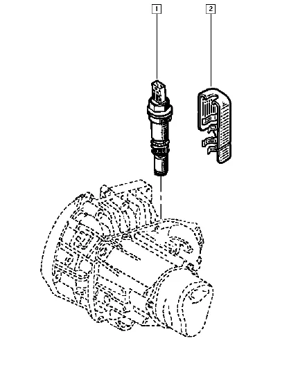

Guys, I've got a ph1 172 and the speedo has died completely after months of intermittent readings. Can anyone tell me where the speed sensor is so I can have a look at the connection?
Thanks in advance;)
  172 cup'd extreme
depends on the ph quick its either abs sensor or gearbox speed sensor. If your car used the ABS sensor for speed then it will be the near side sensor thats needs changin if its the gearbox sender then you will need the gearbox sensor its at the top of the gear box as illustrated. the gearbox sensor is £30 and the ABS sensor is £150 and is a tw^t to change

The phase 1's all use the gearbox speedo sensor. Some early phase 2's use the sensor in the gearbox but later ones (Cuped excepted) use the ABS system.
All 182's use the ABS sensors.

i looked down the back of the gearbox i cant see a sensor .. there is one but its not like in the pic above its on its side under what looks like a metal plate with to wires on the plat one thick one thin.. bolded to it with nuts and bolt.. under this is a black sensor. i can just get my fingers on it put my hand down and then to the left is this the sensor?

hs anyone gota pic of the speed sensor in a 1.4 16 valve renault clio itson the gearbox but cant find it anywhere.
