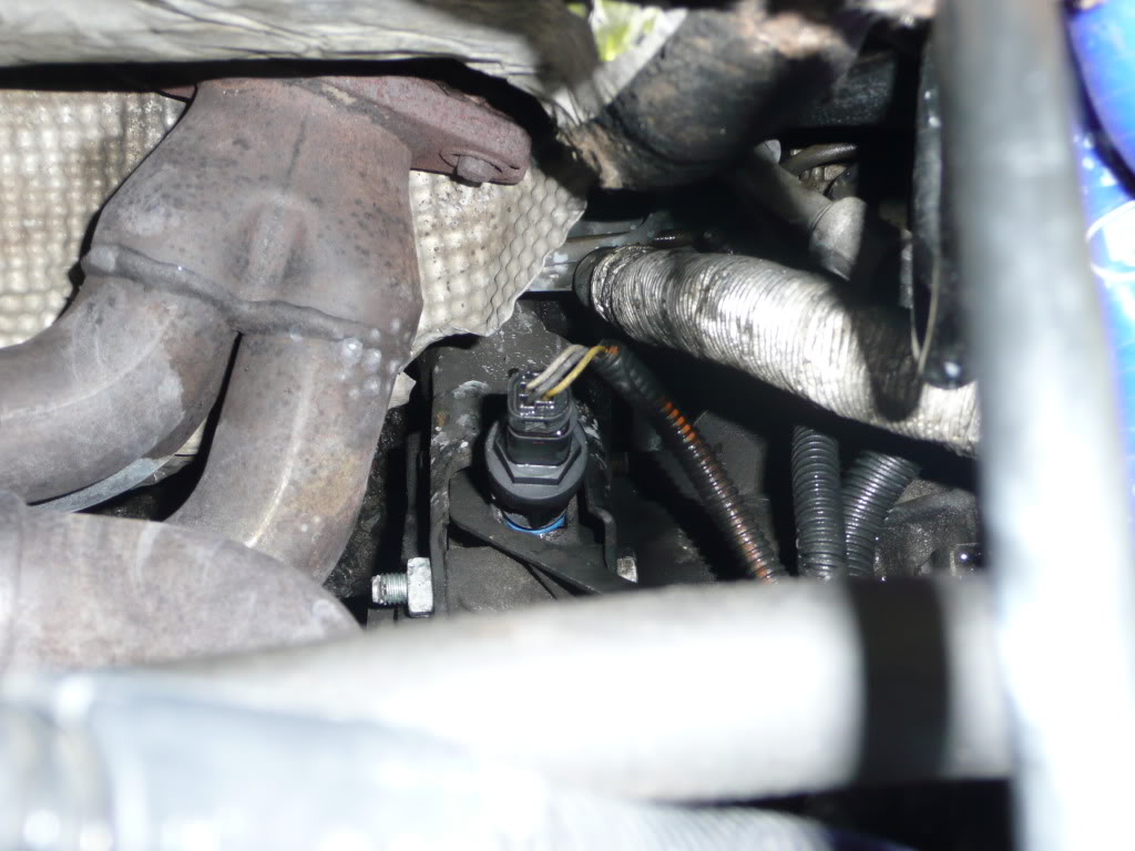

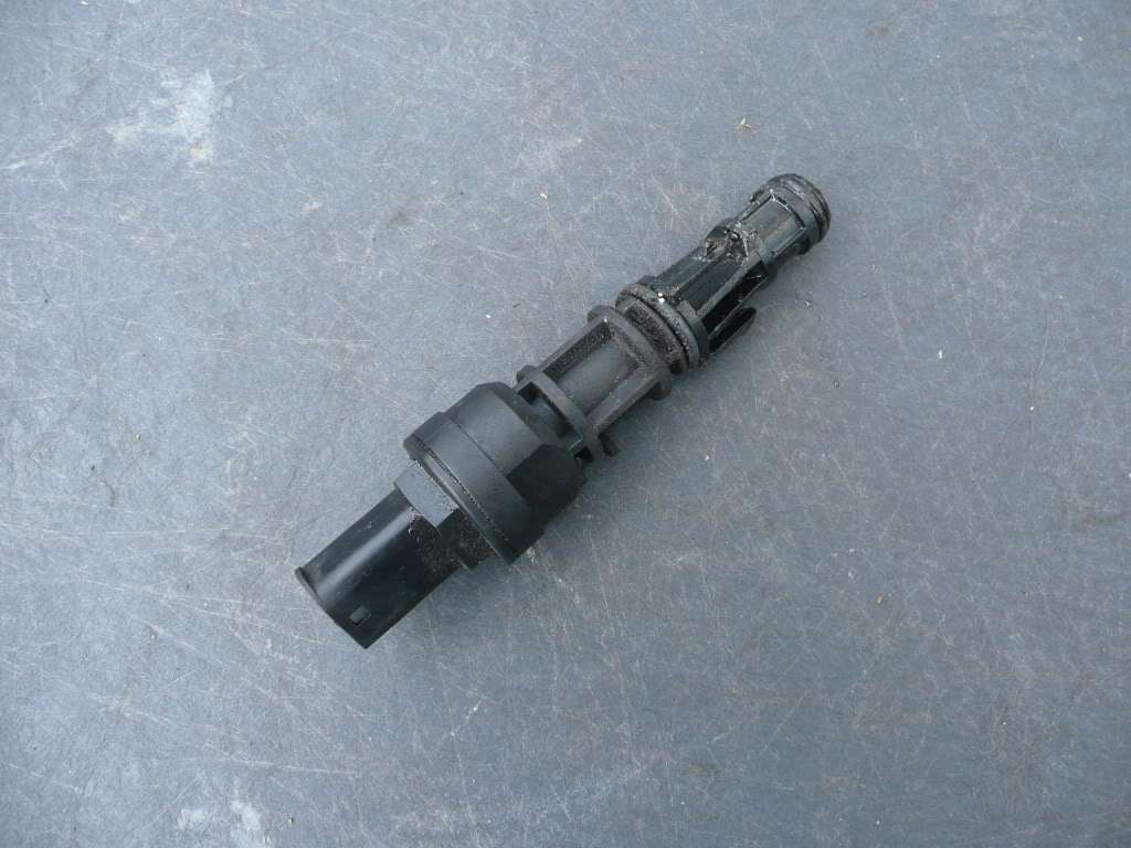

I've got the same problem on my Ph1, has anyone got a photo of sensor so I know what I'm replacing, Also exactly where it is would be good.

sensor
an where its located, on the right next to the manifold
