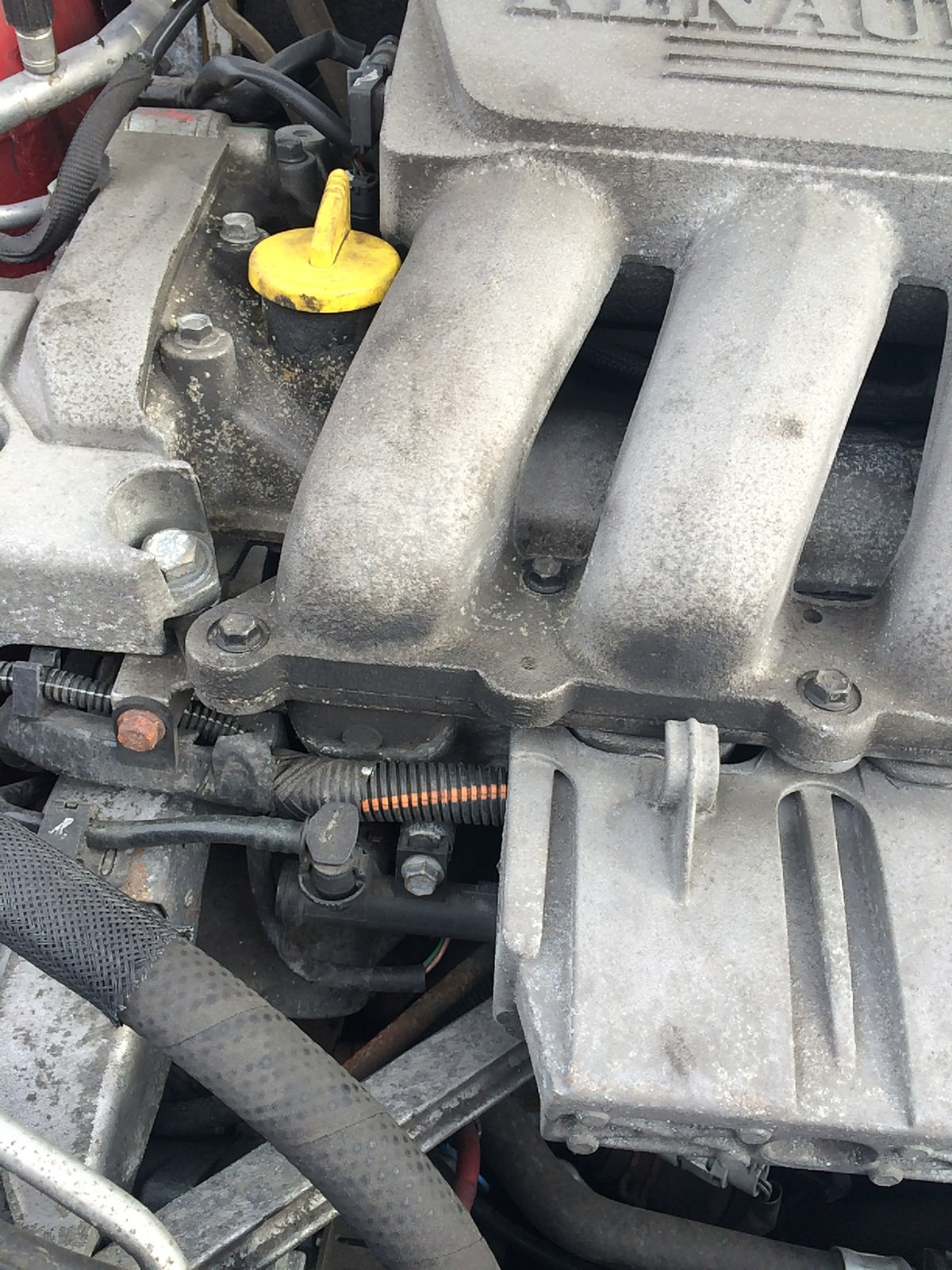

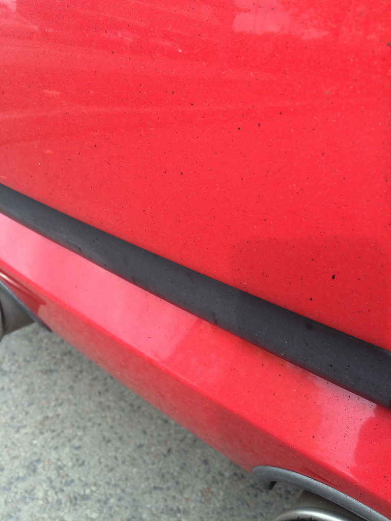

Does anyone know what might be up? It drives completely fine, no warning lights or anything but at idle it sounds like crap. Also, I gave my tailpipes a reet good clean the other day, after a day of driving they're black again and I noticed black splatter over my rear bumper. It could just be stuff picked up off the wet roads and I'm being over cautious.
does it smell like burning oil,im no mechanic lol but ive had this on a saxo it was running rich i was told,i would get it checked somewhere though
It's just dirt. I've noticed this in my engine bay too. It's probably not related and I'm being overly-cautious but there are two dark patches at the bottom of the inlets and also a bit of oil coming from the VVT solenoid (I think that's what it's called).

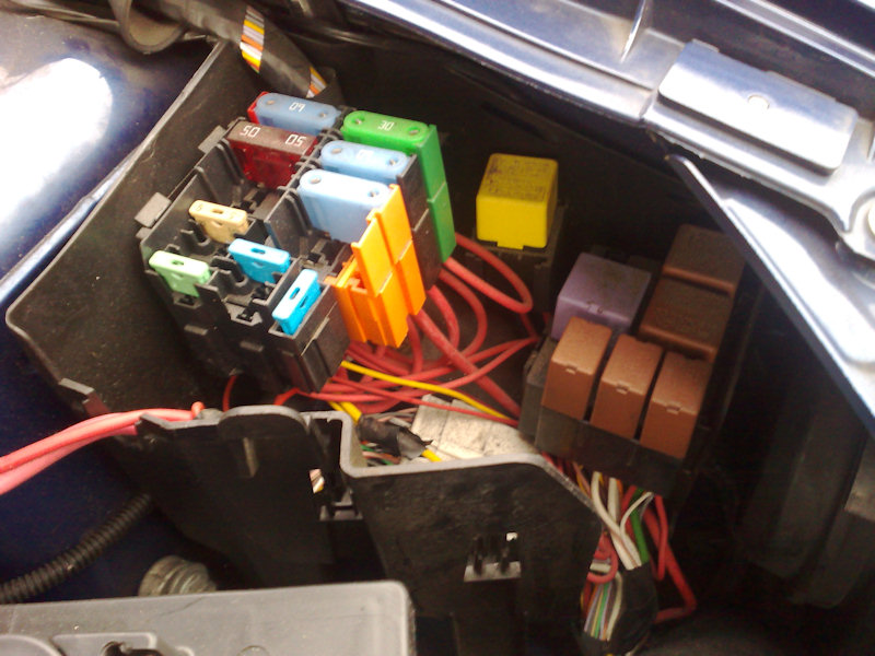

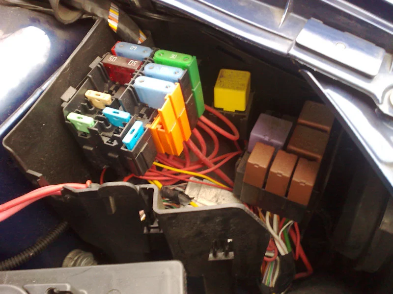

Might sound silly but check your relays. I had a lot of corrosion on mine, I cleaned the contacts and replaced the relays and it ran a lot smoother.
Worth a try... where/what are they?

Also re. relays (mind the pun) and I'm sure an auto-electrician would laugh at this explaination.
In laymans terms, they switch a low current input i.e. the supply from a dashboard switch for your fog lights, to a high current output.. i.e. the current needed by the fog lights themselves.
I replaced mine as they all looked a mess and one was certainly dead. The big square ones can be found in halfords and the rectangular ones on eBay.

Relays will not make it splutter on idle, there is no inline filter on 182 clios.
Mine certainly made a difference. I never had the time to trace why, I changed them because they were all badly corroded. I'm guessing possibly comprising the supply to the coil pack.
