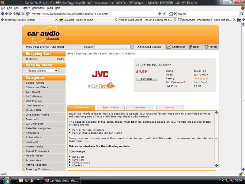

Theres also the incartec options which you don't have to remove the dash for and imo are far better.
  172
INCARTEC CONTROLS
again you need a patch lead specific to your radio AND a vehicle adaptor
Patch lead
sony
kenwood
pioneer
alpine
jvc
blaupunkt

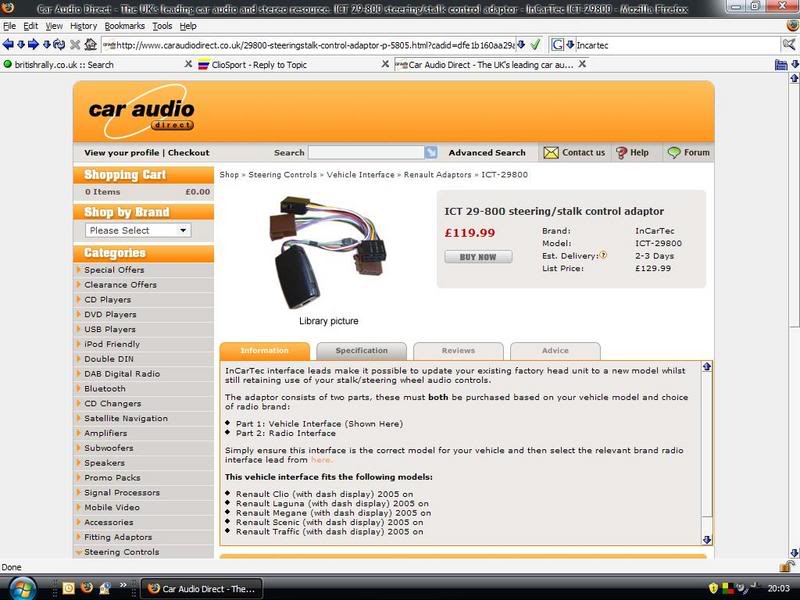

VEHICLE ADAPTOR
29-800 clio 05 onwards (with display)
29-652 clio 3 98-05 (with display)
29-601 clio 1 90-90 and clio 2 98-00 (no display)
as bmh.01 has said these do not require the removal of your dash in order to make them work :)
autoleads can be bought from halfords,motorworld and many sites
incartec are from www.caraudiodirect.com
christ £125
do these both control the factory stalk and the clock display???
  BMW M135i
Nope stalk only, display will just show JVC and which function you pressed. Hence my £££ comment.
