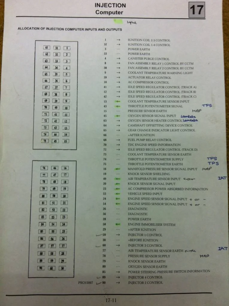

I have the spread sheet from ktec that shows you what wires you need to move for the gen90 to work with a ph1 loom, it gives you the info on the standard pin layout as well as the gen90

Ignore the notes etc....
