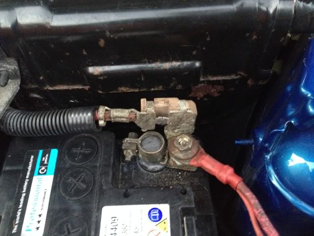

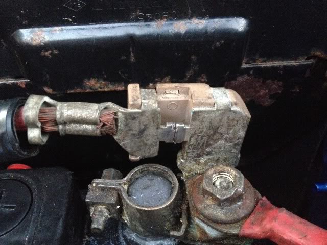

Got a wee issue where my positive from my battery touched the exhaust and blew the fuse that's built into the cable, can I do away with the fuse or how do it get a replacement? Anyone know the rating of it as it's not very clear to read.

it looks like this

120A and officially you have to replace the entire starter cable as Renault will not sell the fused link/crimp on its own.
You could solder the link or just cut it off all together but the link is there for a reason.

not to worry guys .... I have had a red plastic cover the whole time was only off for the picture. problem has been solved, I managed to get a replacement original part from a breaker and made a crimped join in the cable and the cars is back to life, and back on track to being prep'd for its next mod... cheers again :)
