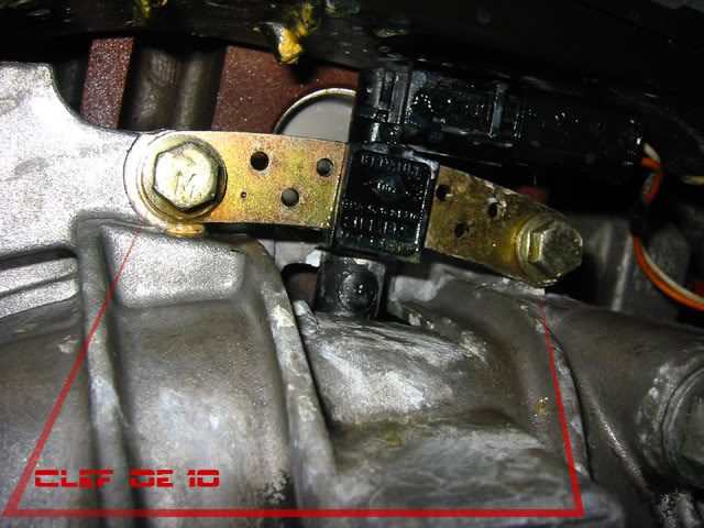

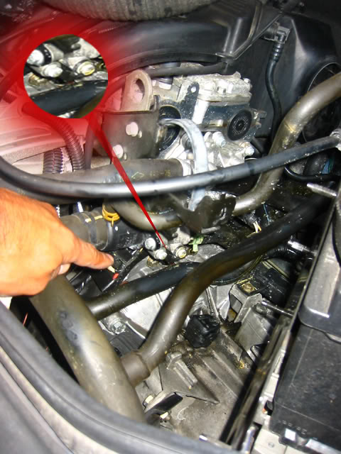

TDC Sensor, Not my pics dunno whos they are had them ages.
This is where it is on all Clio models
This is what it looks like
Basically, turn off igniton, remove airbox - bit with filter(2 X10mms, pull it forward & up) You should see the sensor it runs from front to back, undo both 10mm bolts - don't drop them in the bell housing, unclip sensor and away you go, chances are it'll be dusty as anything. Tighten 2 terminals on block plug (staying on car)
If you buy a sensor from Renault you'll get a loom aswell with 2 ready togo solder joints, you'll need a small blowtorch.

TDC sensor was caked in crap, so gave it a really good clean and replaced it. find out tomorrow morning if its done the trick as it only seemed to have the problem in the morning after being left a long time.

ok well, to report, after cleaning the crank shaft sensor everything seems to be ok (fingers x'd).
it started first time on the key yesterday and also this morning.
