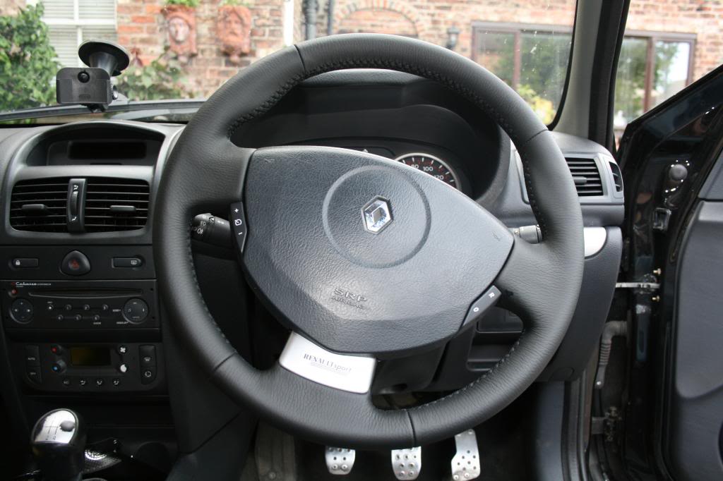

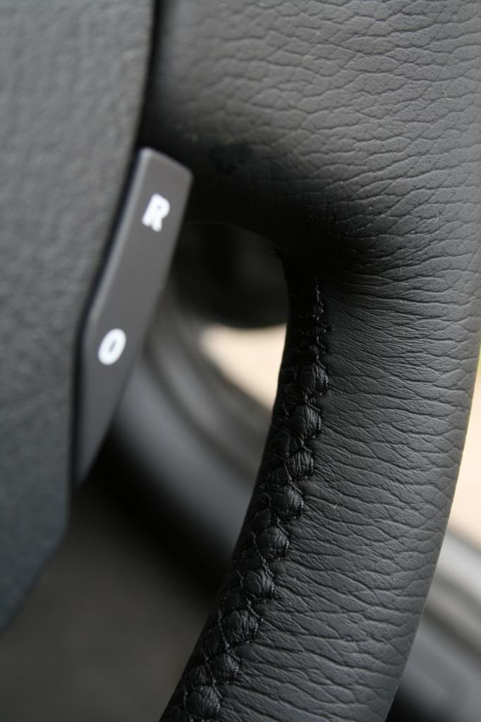

Ok, both you cynics, (ha ha) here are a couple of snaps.
Shameless plug it maybe, but it was intended as an oldie enthusiasts (raced in the 5 TS championship many, many years ago admittedly as a backmarker, but had many 5's as road cars inbetween including gordini turbos, and a 172 before returning to the marque just for a bit more fun with this 182) recommendation for a really good product which deserves extra attention to similar adicts.
Make up your own mind from the pics, I have nothing to loose or gain.
Must say, working out how to upload the pics is a real pain. Why can't it just be attachments like other sites ?
Hope it convinces a few to at least browse the website.
Regards
Simon

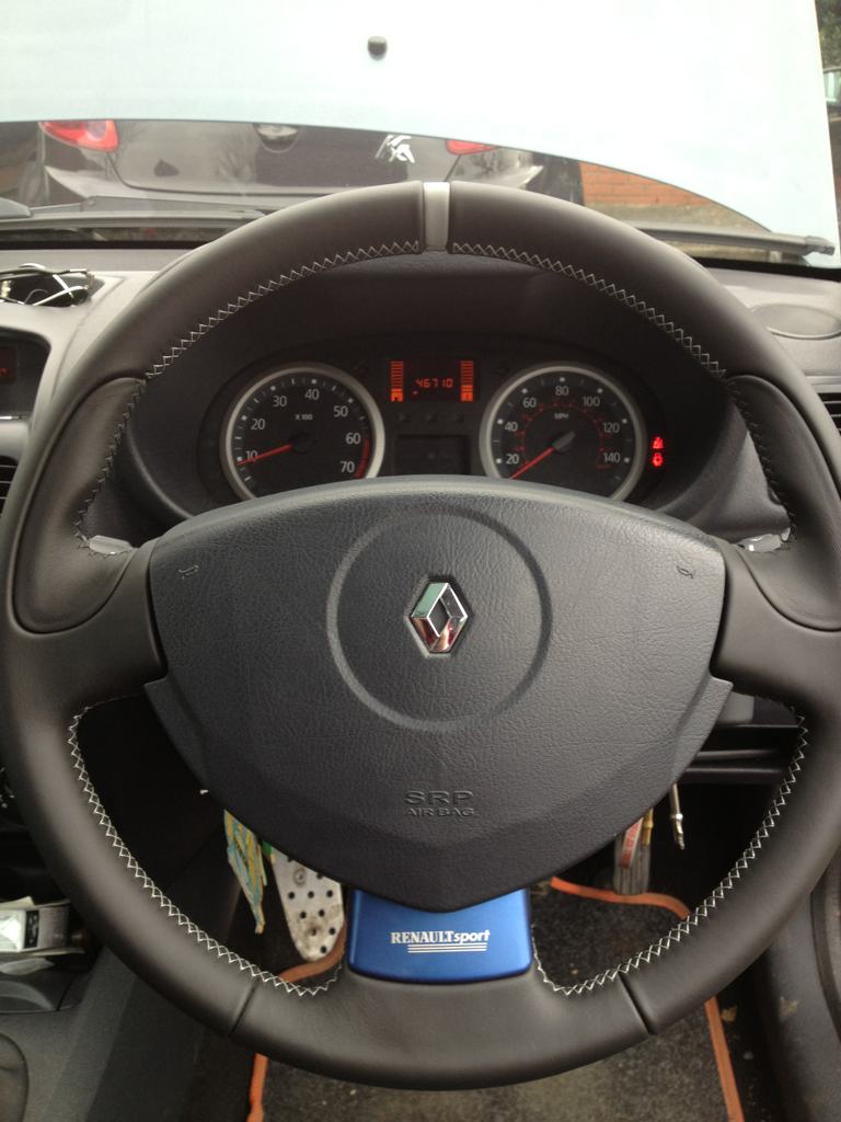

Looks like its been put on over the top of the existing stuff.
As the thumb grips don't look right
This, looks decent quality with the stitching etc.
But prefer the the one Dolan has posted with the centre marker.
