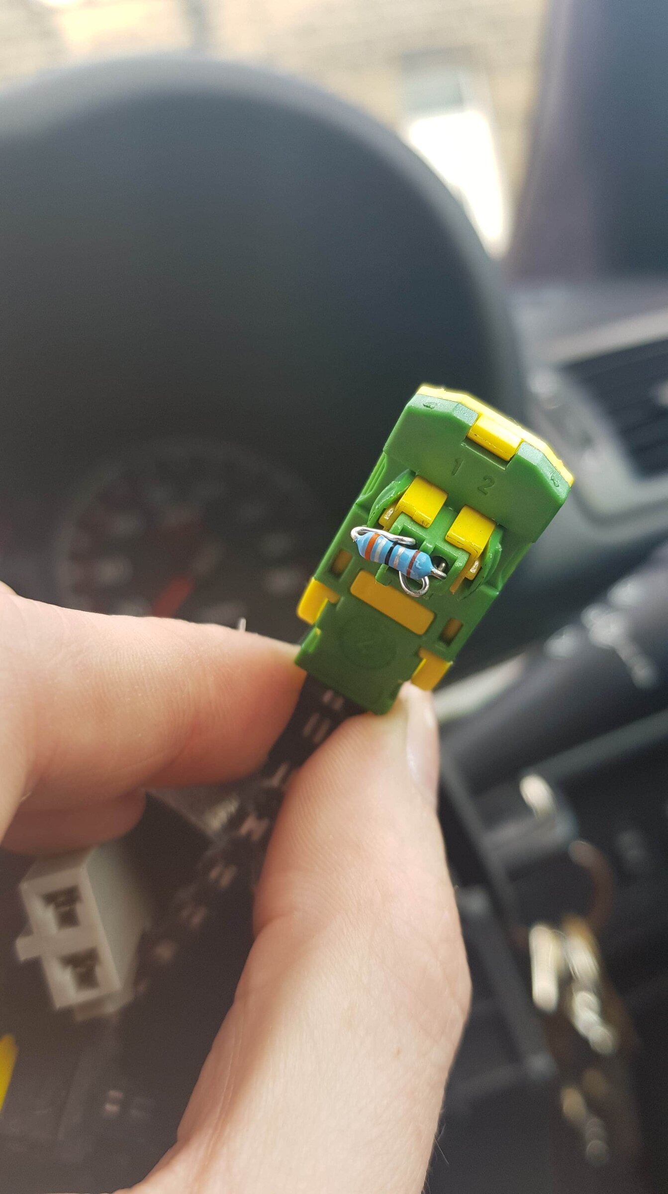

Edit: also in terms of airbag removal, guessing i need some sort of resistor to stop airbag light coming on? Am I right if so any links to which resistor I need? I can’t stand dashboard lights being on.

You'll want some 3.9ohm resistors for your airbag. You triple over the legs and then push them in.

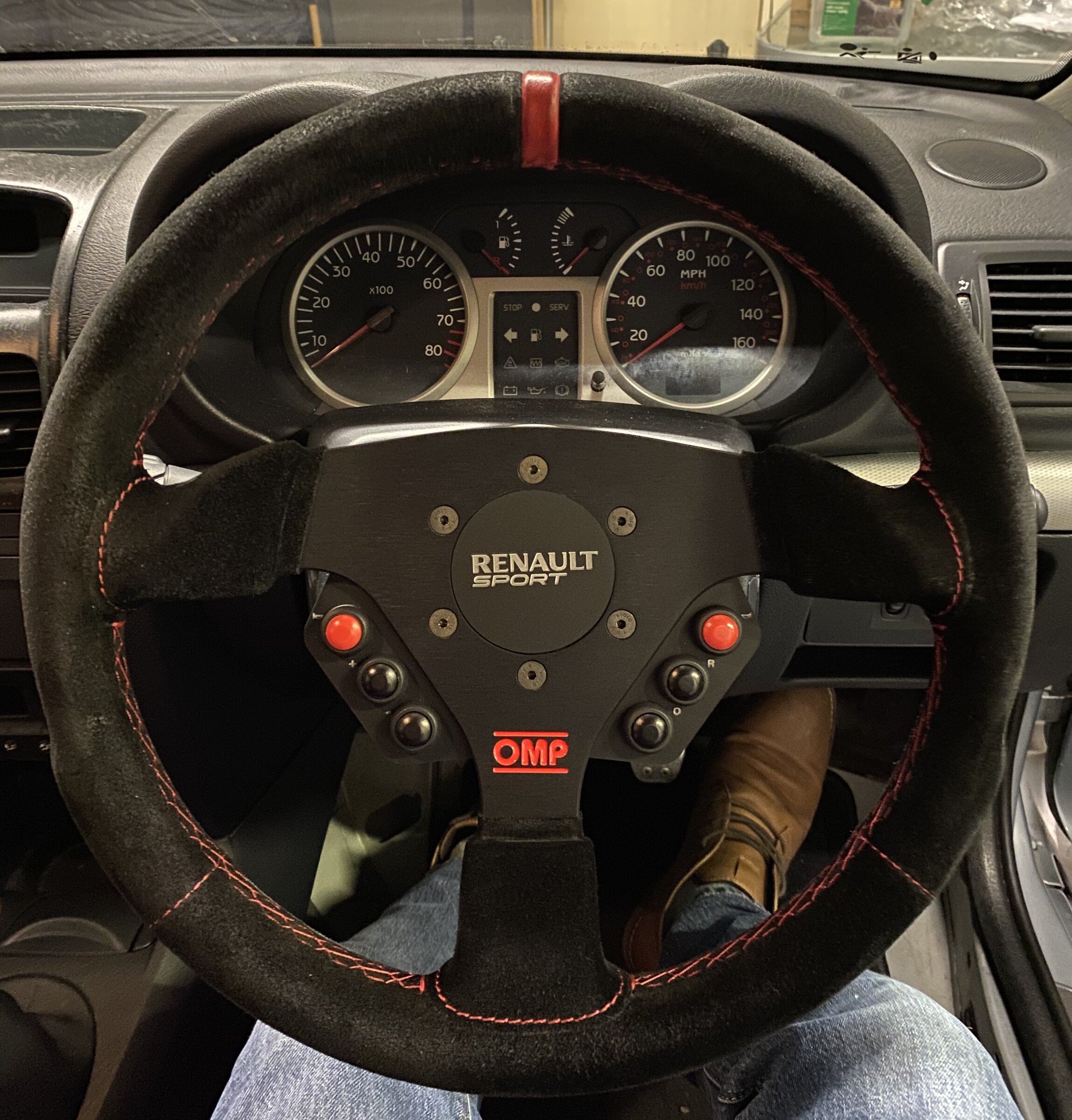

This is what I have. It's a Volantech panel with cruise and speed limiter. The red buttons are for horn. The boss is a momo one. It's best to get a specialist to turn the airbags off on Renault Clip, saves having to use resistors. Wheel was from YB Racing. I think it's a Targa 330mm Diameter.
