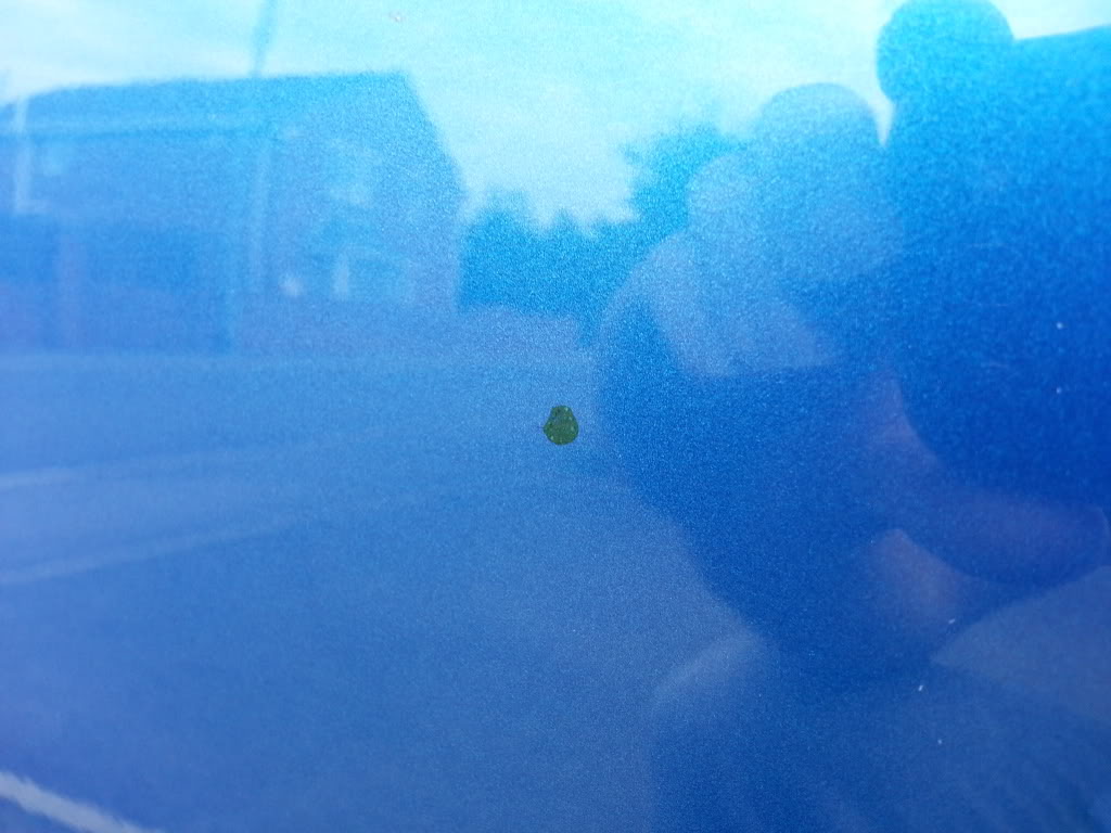

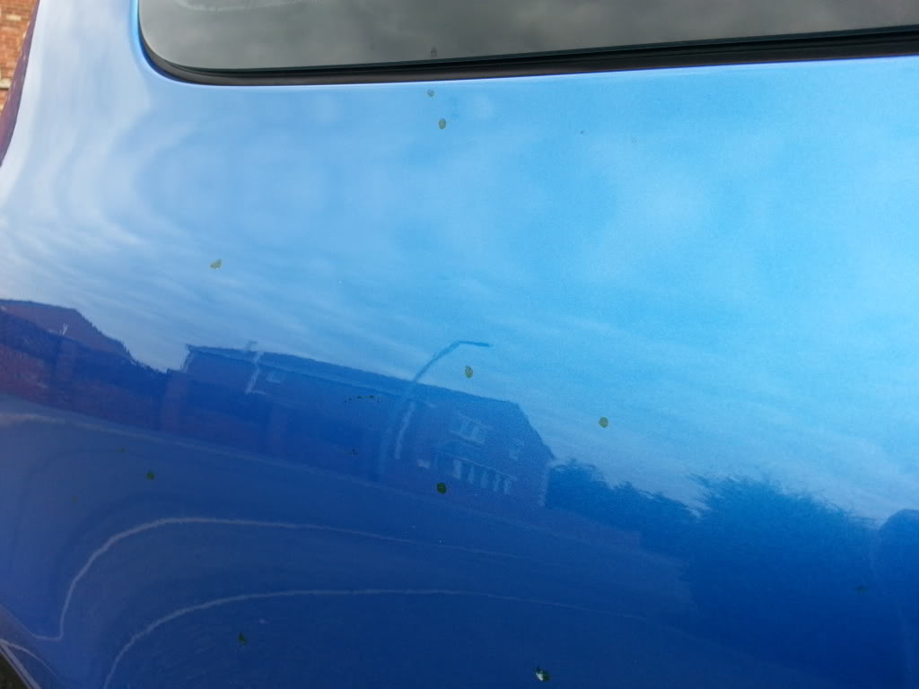

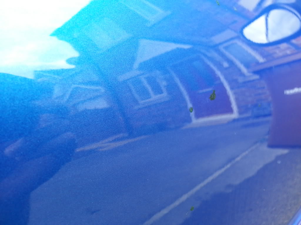

Hello, Wondering if anyone can help. Just cleaned the car and noticed that some strange green spots have appeared on the drivers side. Does anyone know what they are and how to clean them off?

When you zoom in on the first picture it looks like the spot of green stuff is bubbling.
Can you pick it off? Is it wet?
  Pearl Black Ph2 172
If it iis paint, water based paint can be removed usually with hot water, oil based with turps sub or similar. Tar remover is another option.
  BMW E46 330i Touring
I'd say tar remover or clay. My Dad's car had little flecks of yellow paint all over it from parking in an airport "at his own risk" a few weeks back. Tar remover worked very slowly, clay (possibly due to the tar remover softening it) pulled it all right off without any hint of it ever having been on the paint.
  Golf 7.5R & Clio 200
Soak a bit of kitchen roll in tar remover and leave it on the car for a few minutes so it can really eat up the green stuff. Sould just wipe off after that.
​If it doesn't, maybe try paint thinners?
  AB182, Audi A5 3.0
Paint thinners is a bad idea imo. Stick to tar remover or clay bar.
