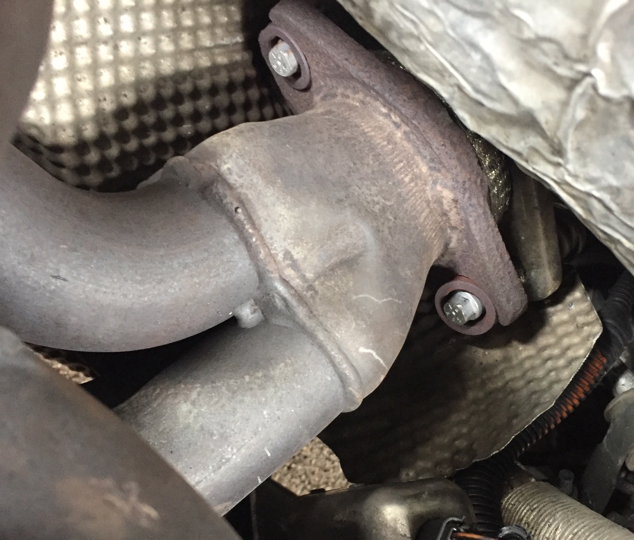

Could this be causing it? Doesn’t look like the exhaust manifold to cat has been connected properly?
there is a thing called cat to manifold whistle....
ticking could be resonance have a peep at the heatshields.
that right cap/plug/washer thingy is not seated properly aswell
Thanks for the tips mate - I will take a look under the car and see if any of the heatshields are touching. I'd say it's more of a rattle than a whistle but if it's not been seated properly, this could be my issue.
Dose not even look as the cat pipe is fitted over the manifold gasket is it a cheepie cat?
It is a cheapie cat (well decat pipe) but it was fine until I got the engine swapped. Hopefully I can get to those bolts and tighten them up a bit
