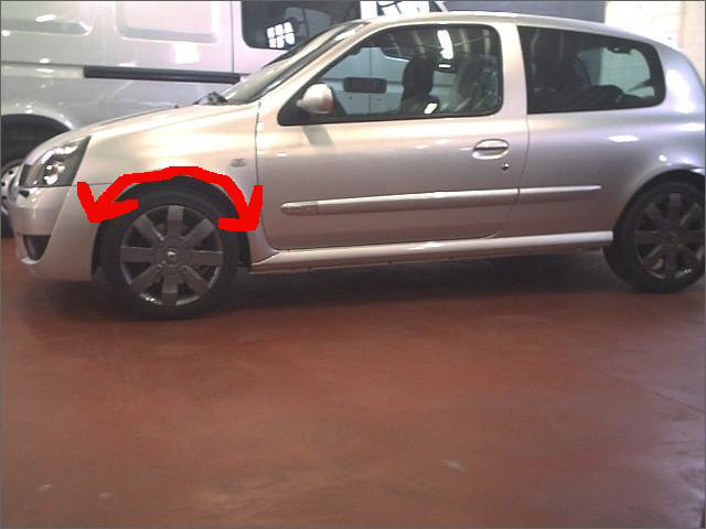

I'm driving and it sounds as a bearing. Vibrations in gaspedal and in brakepedal also. Sounds is faster and harder as I drive harder and less when I drive slower.
So I jacked up the 182 on my bridge, 4 wheels up. Rolled the front wheels, but I can't hear anything!
I've shaken the frontwheels in every direction and one movement made a hard rattling sound. Is this normal or is this not normal?
This is the movement (short shakes to the left and the right):

It could just be all the various little bits of play and wear in the diff and gearbox you are hearing, provided its not excessive, thats quite normal.
  Carrera 4S. Clio 172. M5
Mmm, that qualifies as excessive then.
All you can do is work your way through.
Wheel bearings, CV joint, Dive shaft splines, Diff, Gearbox.
