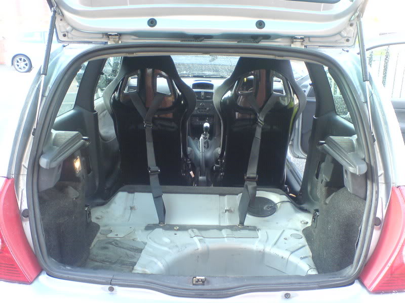

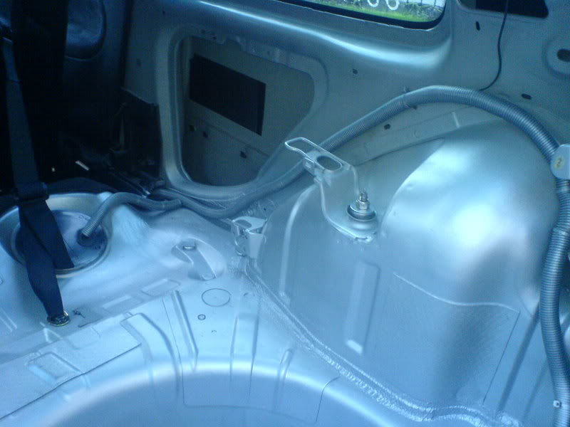

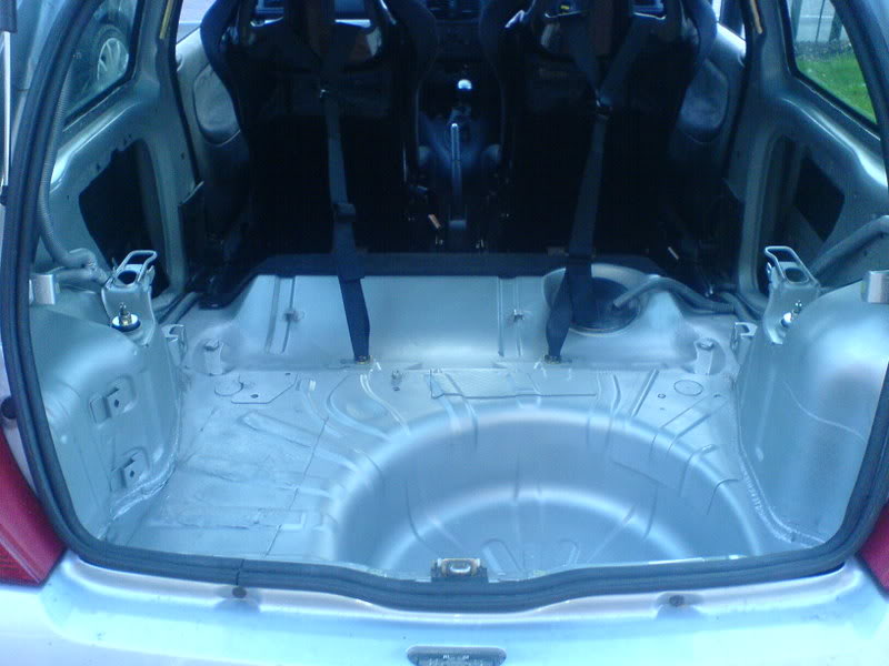

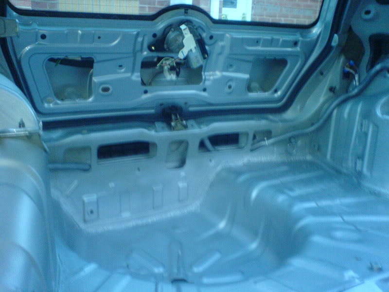

I recently stripped the rear - but not totally as I hate the bare wire look.
I however have just stripped as much as I can possibly do out of the rear. It looks great IMO.
All info and more pics here:-
http://renaultsport-clio.blogspot.com/
What do you think?
Before:-
After:-
  RenaultSport clio Trophy
How much weight do u reckon u've taken out? 20kg?
Not having a dig, just wondering.
  CTR--VX220D
In total I have:-
Taken all std seats out inc rear bench, seatbelts, pretensioners [heavy], carpet, interior side trim inc boot, sound proofing inside the car and in the engine bay, spare wheel and accesories, airbags, all air conditioning, using lightweight tyres, Speedline cup rims, etc, etc,
The seats alone weighed nearly 90kg [I weighed them] have a look on my blog for more info..... thats not including all the stuff I took out after that!
The stuff I just took out today was quite heavy when I took it down to my shed [surprisingly so] I didnt weigh them though.
