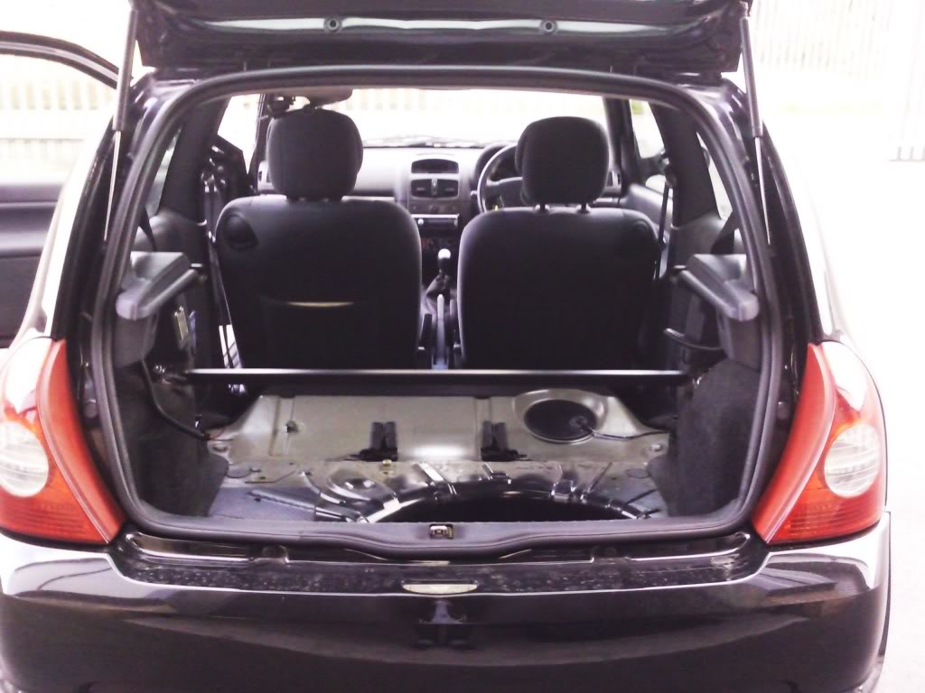

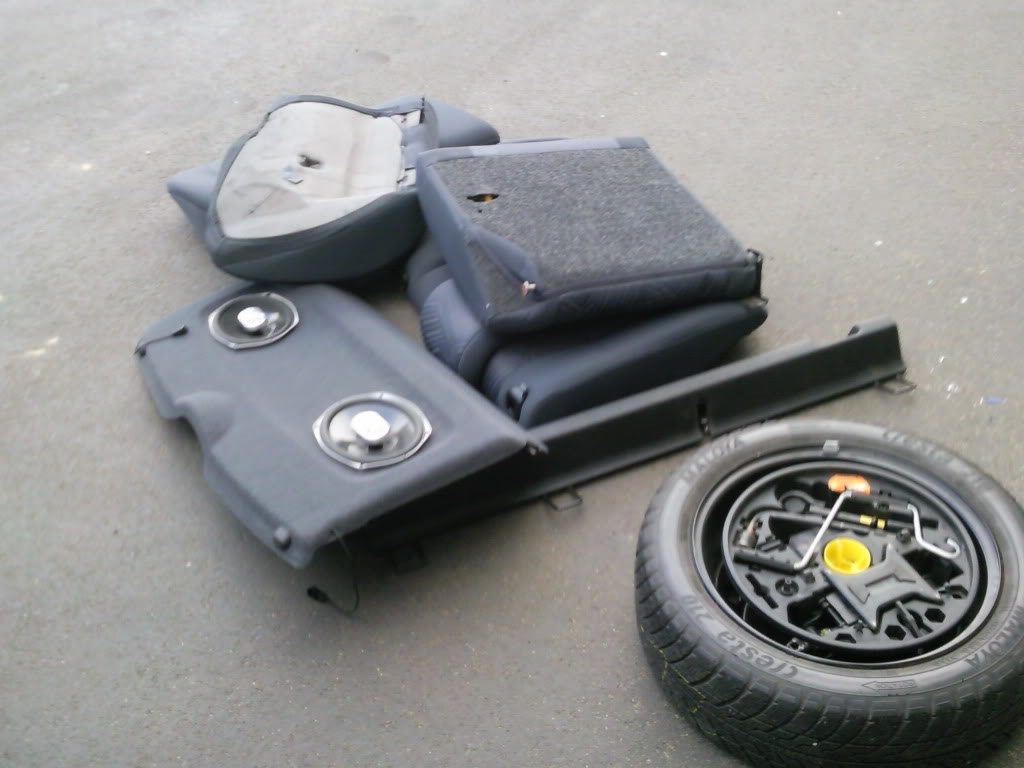

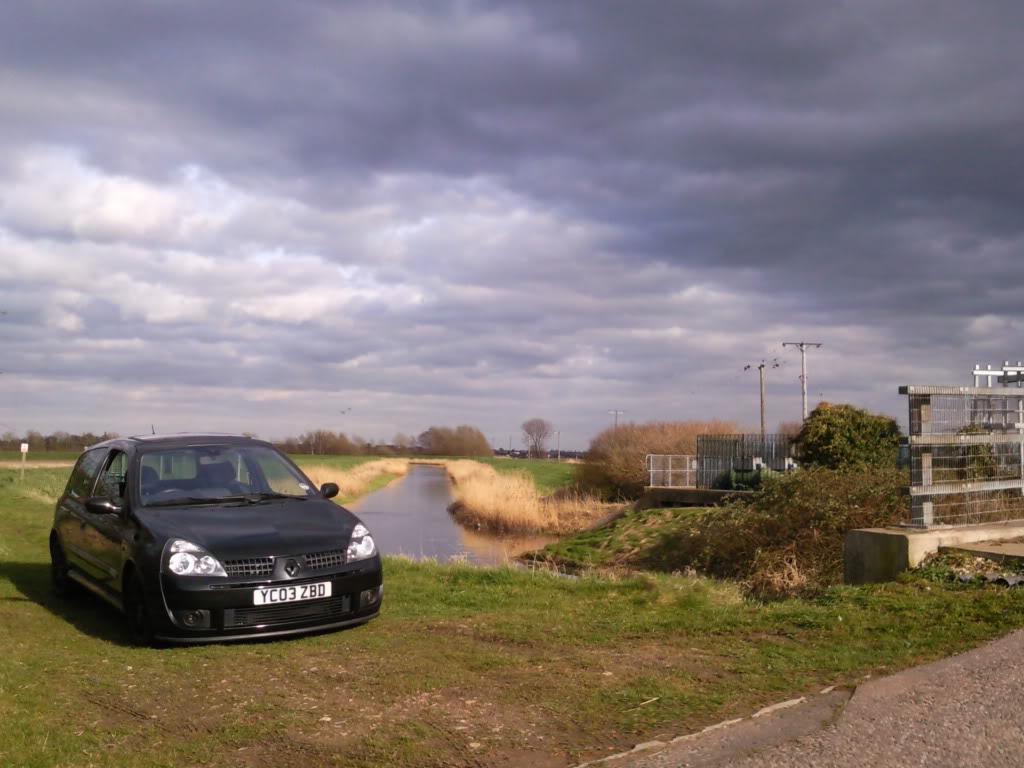

Very Bored today... and was reading through some threads on here. was looking at how much weight their was to be shed. so thought id have a go!
The Consequences!!!
The drive out
After the drive i found it to be a tad bit quicker, but not quick enough for me to keep it like this...

That's the thing... If you're not gonna do it properly then the negatives far out weight the positives imo.
  Iceberg 172
Also, another note to make is weight distribution.
I get the Top Gear mag every month (as it was my bday present from my boss!) and they done a feature this month on "lightweight cars". One of the features was a 207 GTI which the stig ragged around the track. They then stripped it and let the Stig have a rag around... his conclusion was that they had ruined the cars handling and it was basically uncontrolable once the rear let go... now I know there is probably more weight in the 207 and the car was bog std apart from being stripped but it's something to keep in mind if wanting to strip a car to make it faster in a straight line... you could be ruining your handling ability!

Yeah i sort of agree, right pain in the arss not haiving a boot. But i ended up stripping 170 -180kg off my 182 and it felt pretty quick, (now ITB'd)

i was gonna keep going but it took like hour n half just to get rear bench out, b-cus of the stupid bar bolted to the floor. what is it for ?? any one know??

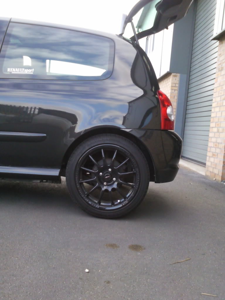

I removed everything from my 172 and it was VERY high. If you're stripping it properly you need some lowering/tougher springs right away as it made my 172 very tail happy.

Exactly... I was just making that point, as some seem to just strip their cars to make them faster at the 1/4 mile! Then in the wet a roundabout appears! Less weight could cause locking up of wheels, stupid amounts of lift off oversteer etc etc.
