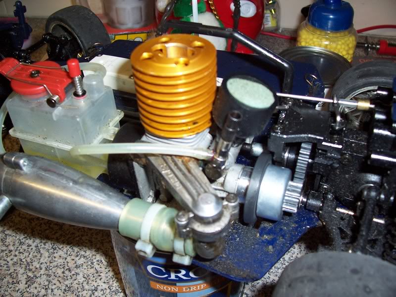

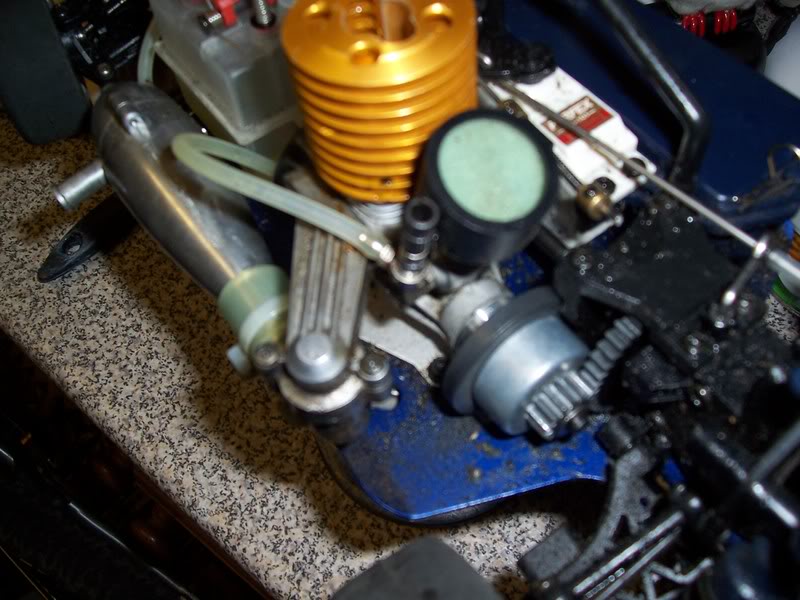

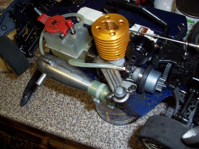

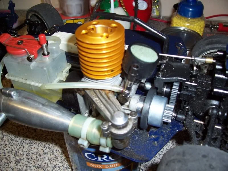

Ok thanks. There is no needles. It is a ball bearing engine. There is one screw type adjustment near the air filter and where the fuel line enters the engine. I will post some pictures.
Here is the picture of the engine.
