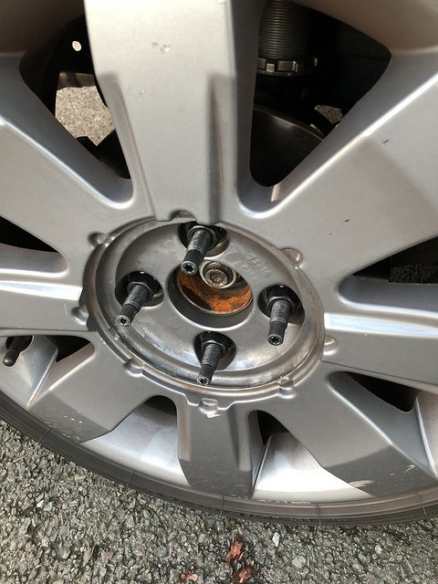

On my Clio I run studs and with standard 182 wheels I was able to just fit the covers on.
I also use the same studs to run 20mm spacers and ET43 2118S.
Can't remember the length, it's on my thread I think
This is the Pure Motorsport stud kit on standard wheels, for reference.
