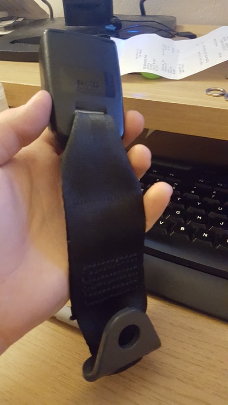

So here is the buckle I have, its off a Saxo I believe

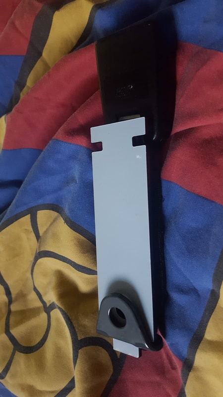

Due to the fact it's just seatbelt material, if you bolt it straight to the seat it's going to flop down, making entering the car a bit of a mission to find the buckle, so I went about designing myself a plastic bracket to hold it up, the bottom goes through the gap in where the felt attaches and it gets bolted to the sidemount all in one go. The little recess at the top is to cable tie the belt to it, this doesn't affect anything and only holds the belt up:

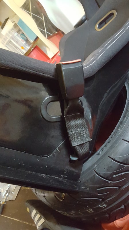

And here it all is bolted up to the side mount, however I am not 100% sure this is safe but for me its a temporary measure until I have a safe way of attaching harnesses

Spot on, thank you kindly for the photographs. I'll have a look and then report back if I can't figure anything with the OEM belts. I've got a feeling that I'll be buying some Saxo buckles the same.
