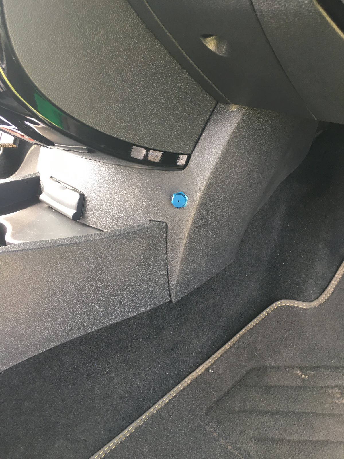

Well nothing exciting happening today, so I stripped the dash, unplugged the passengers airbag and reset the light. Not wanting to take any chances on track with an accidental activation 🙈.....

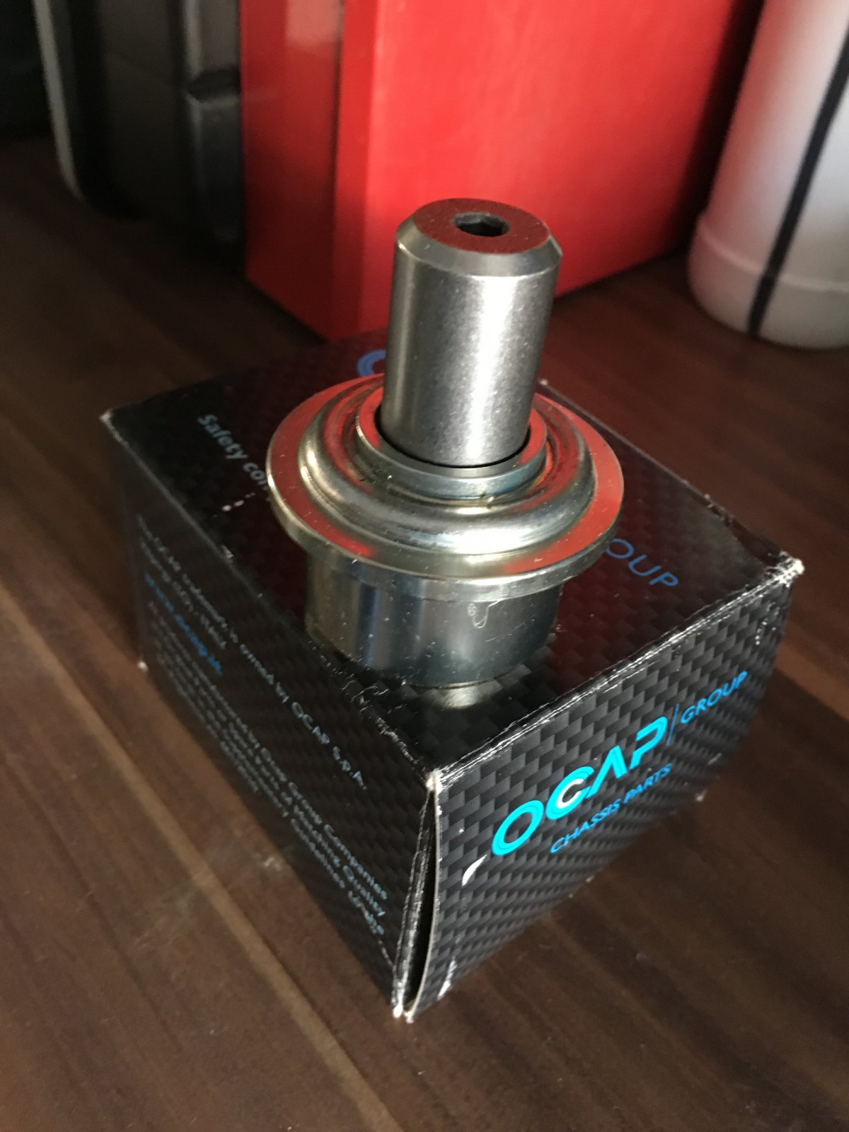

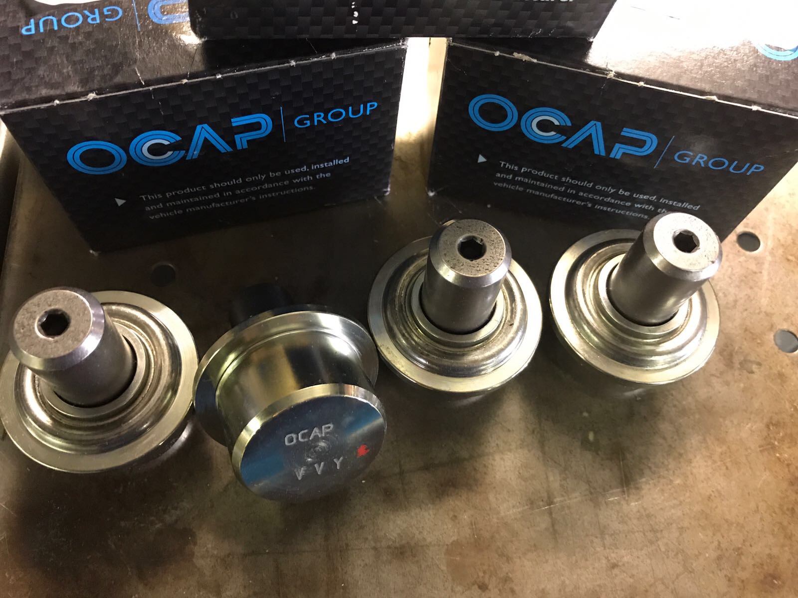

Also picked up a pair of these as I'd heard they are becoming hard to get, set I'm as well having a spare set as not!

Where did you hear that?
Megane uses the same items so ifs its true ill grab a couple off my supplier before they disappear LOL
MarcB
  Vw Golf
They are flying out the door like hot cakes. Got a pair for £80 :up:
MarcB
  Vw Golf
@MarcR™
Have you got a link for them at £80 mate?
Nope, I got them cheap at cost price and the supplier is now fully out of stock.
Im sure the RRP from the UK supplier is around £79.99 and ROFAG from eBay are around £69
I got my two for £32 each and I managed to get @cpaterson76 another two at £40 each.
I can still get 2 for under £100 for the pair but as I say they are no longer listed as out of stock
-Jamie-
I assume that's for direct oem replacement ones then?
Clio cup and Megane N4 has an uprated version which I use. I hope they arn't ended production of them as well
  Supercharged AG 200
I believe that these are the factory fit for all 197 / 200 cup or not. Assuming by the updated ones, you are meaning the cup racer parts? OCAP seemingly make these for Renault, so I would say original / OEM.
I'm sure all parts are available, but seem that they come with a 2 to 3 week lead period and much higher costs. So with track season about to start it's worth having a few in the parts cupboard :up:

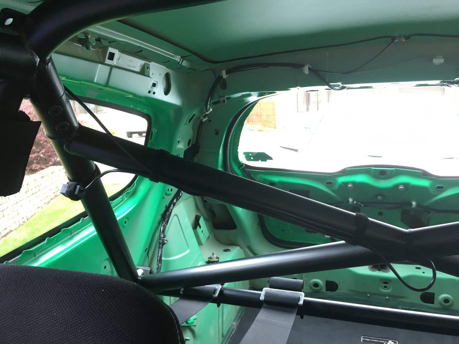

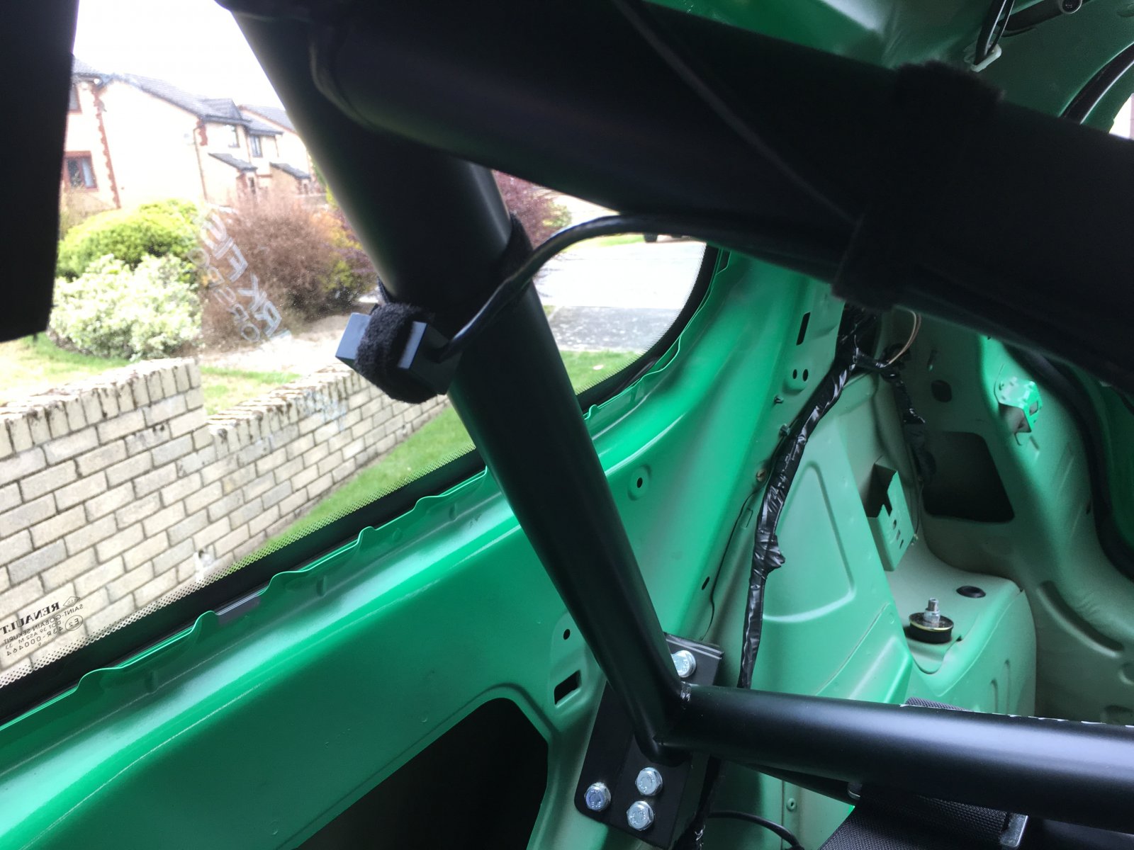

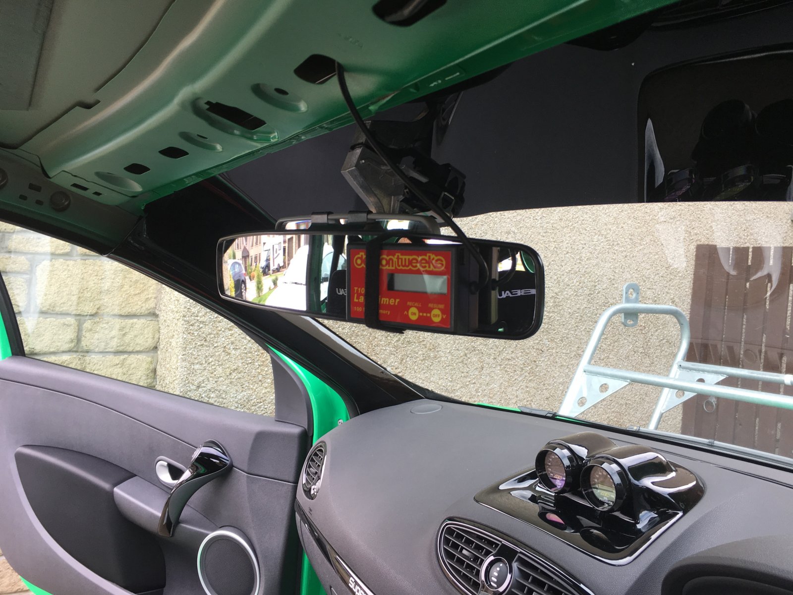

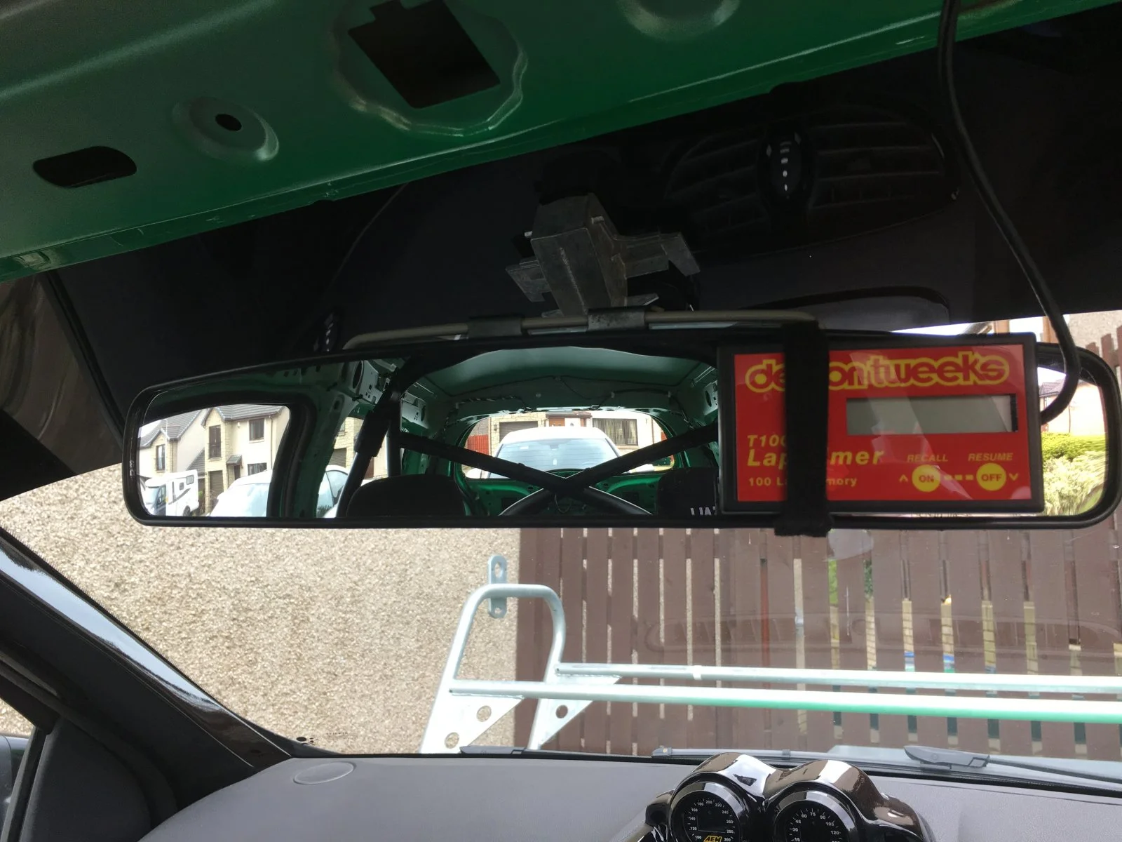

So spent today getting the last few things done before next Sunday's track day. Who would have thought that finding a place to fit the lap timer was so hard to do! Biggest issue was that the oil pressure and temp gauges, in the custom pod, sit where the clock used to! this was the key place for it in the Trophy as a quick glance meant that you weren't taking your eyes off the track! Only place that could have been an option on the 200, due to the shape of the dash was either low in the cup holder area, or in the speedo cluster. Neither of these were options as to look would mean taking your eyes off the road for too long down low and I'd be obscuring some red lights on the dash at the speedo end!!
Then I had an idea!! I'll let you know if it's good or bad after the first outing or not 🙈
I put a wide angle mirror in the Trophy, but took it off after half a session as you can see yourself in the mirror! it was good to see the blind spots for manoeuvring in pit lane and the paddock, but it was just too off putting when driving for me, so......
So I have full vision in the mirror, lap times at eye level and blind spots (rear quarters) are still very clear and no view of the driver in the mirror......... All great in theory!!

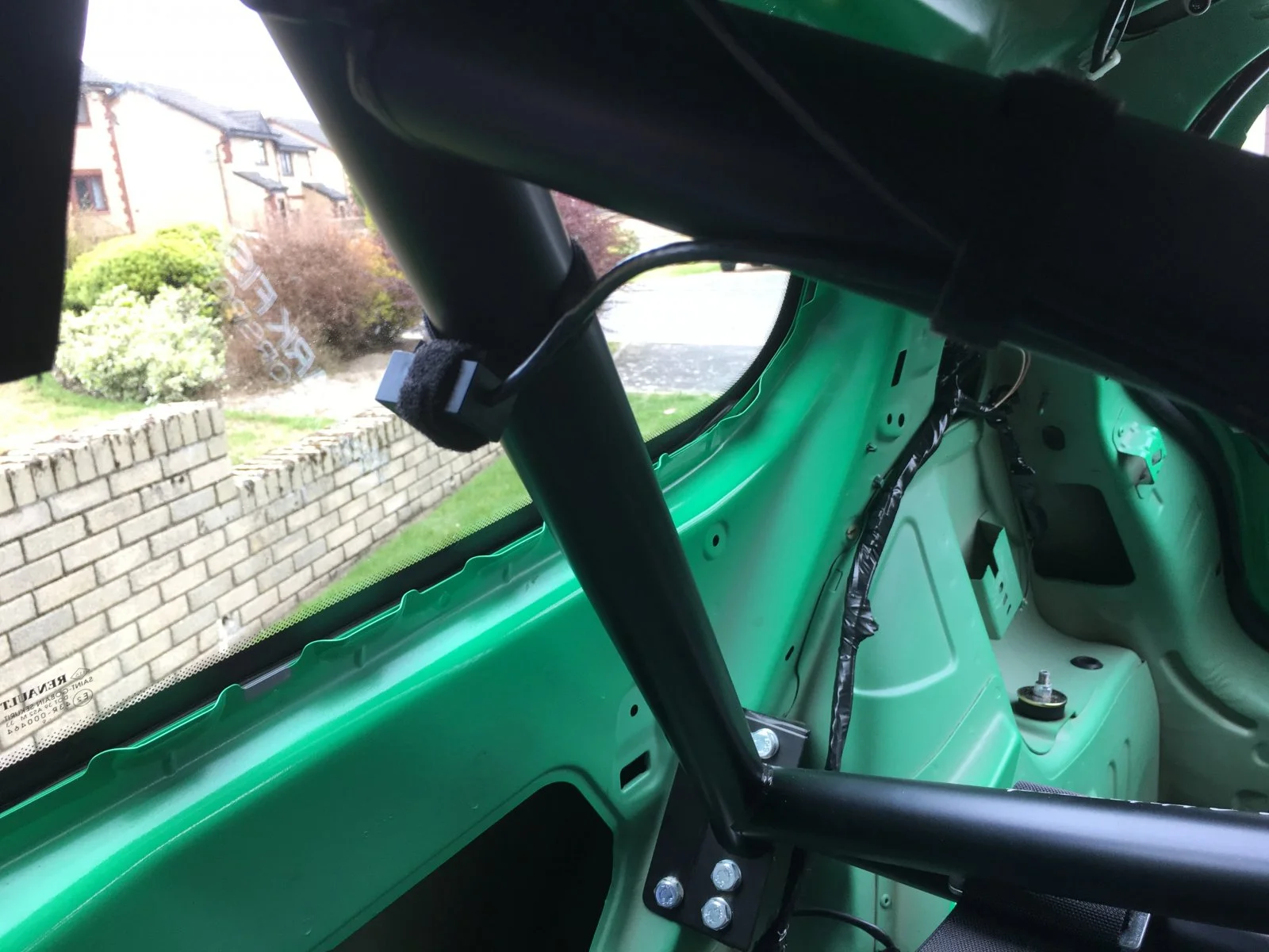

Secured with a Velcro disc on the back and a verclor cable wrap for extra security :up:
Also spent a bit of time routing the wiring so I can have the beacon sensor on either side now, so a quick two minutes and it's on either side for normal or reverse days :grin:
I'm liking these Velcro loop tie wraps as they are reusable, and subtle, but very effective.....

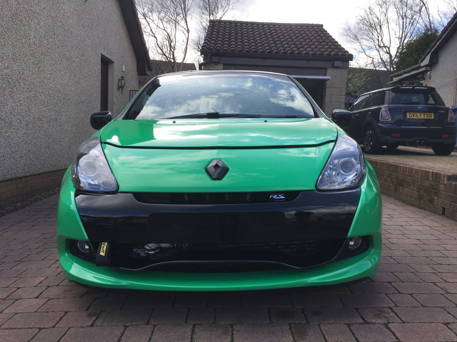

Final track prep.......
I'm sure that's worth a second a lap 🙈
Oh and added an RS grille badge to the front as I thought it needed brightening up

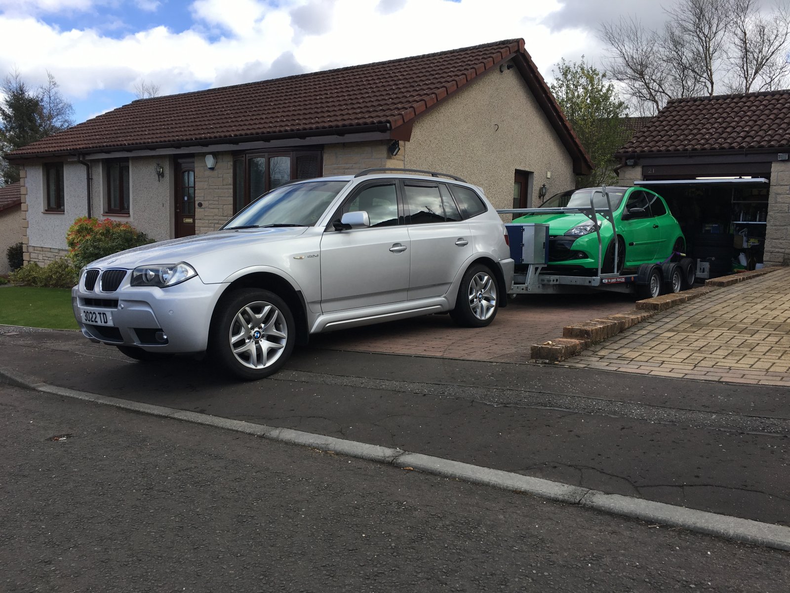

Looks awesome. Same trailer as mine.
Almost identical, mine hasn't got the wheel rack... yet :tongueout:
Have you got the rear leg supports on yours?
  Supercharged AG 200
Hi Dan, yes....
I also have the winch, 8ft extended ramps, rear legs, fuel box and the moveable chocks.... can't fault it, that's 2 years now and it's been brilliant! 2 of the mates have just bought them.... I made the wheel rack as I wouldn't pay the Brian James price for it lol. Copied their design and it works a treat :up:
Great trailer all round :smile:

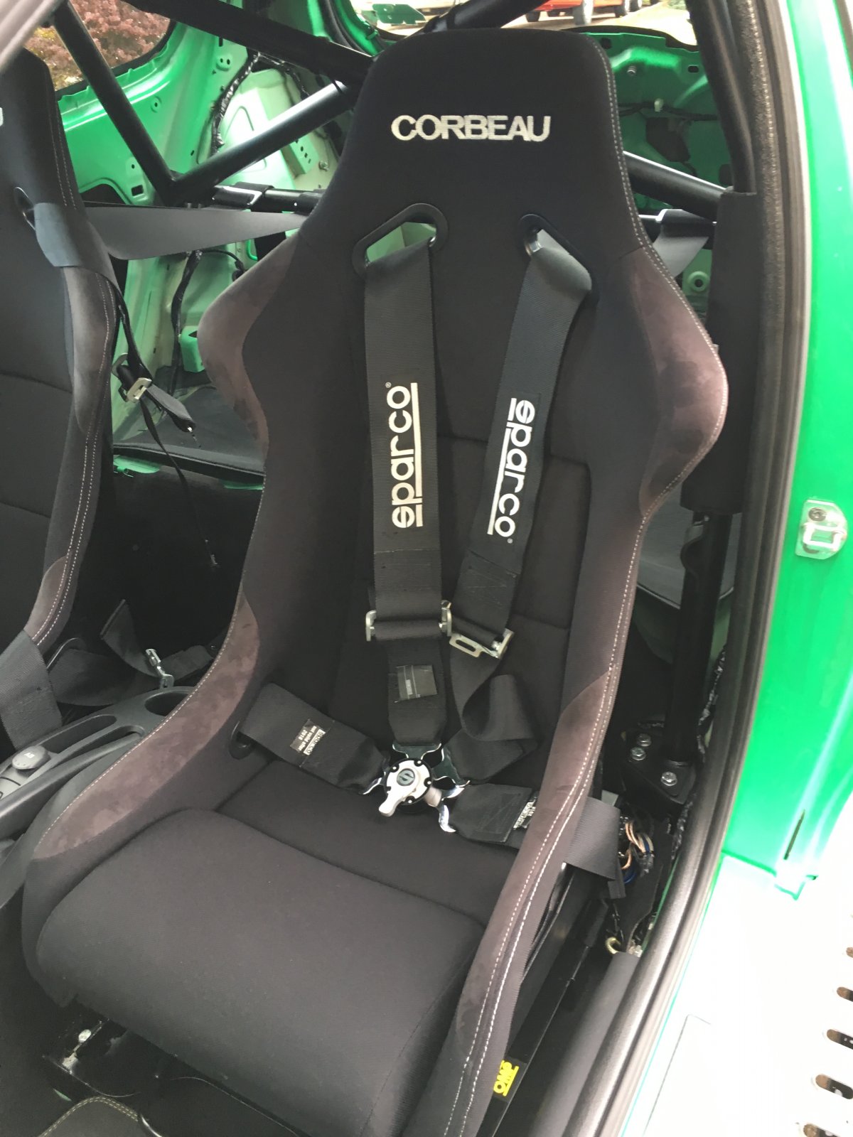

Off on holiday this week and absolutely choked with the cold, but cheered up a litttle when the deliveries started arriving.....
Club sports are out and away to their new owner, whilst I did like the look, they just were not what I'm used toforbtrck driving......

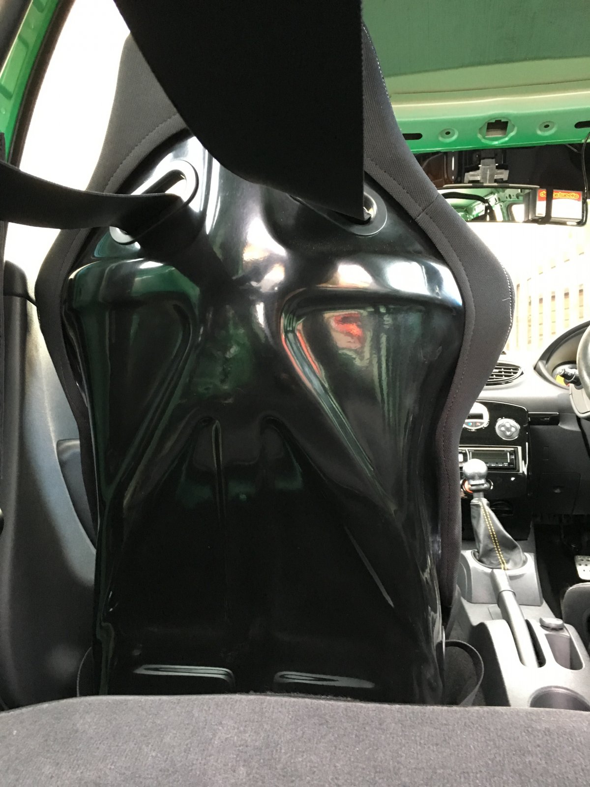

These will give mixed views, but as it will be track based, I need something that holds up in place!
Along with this..... just for added safety

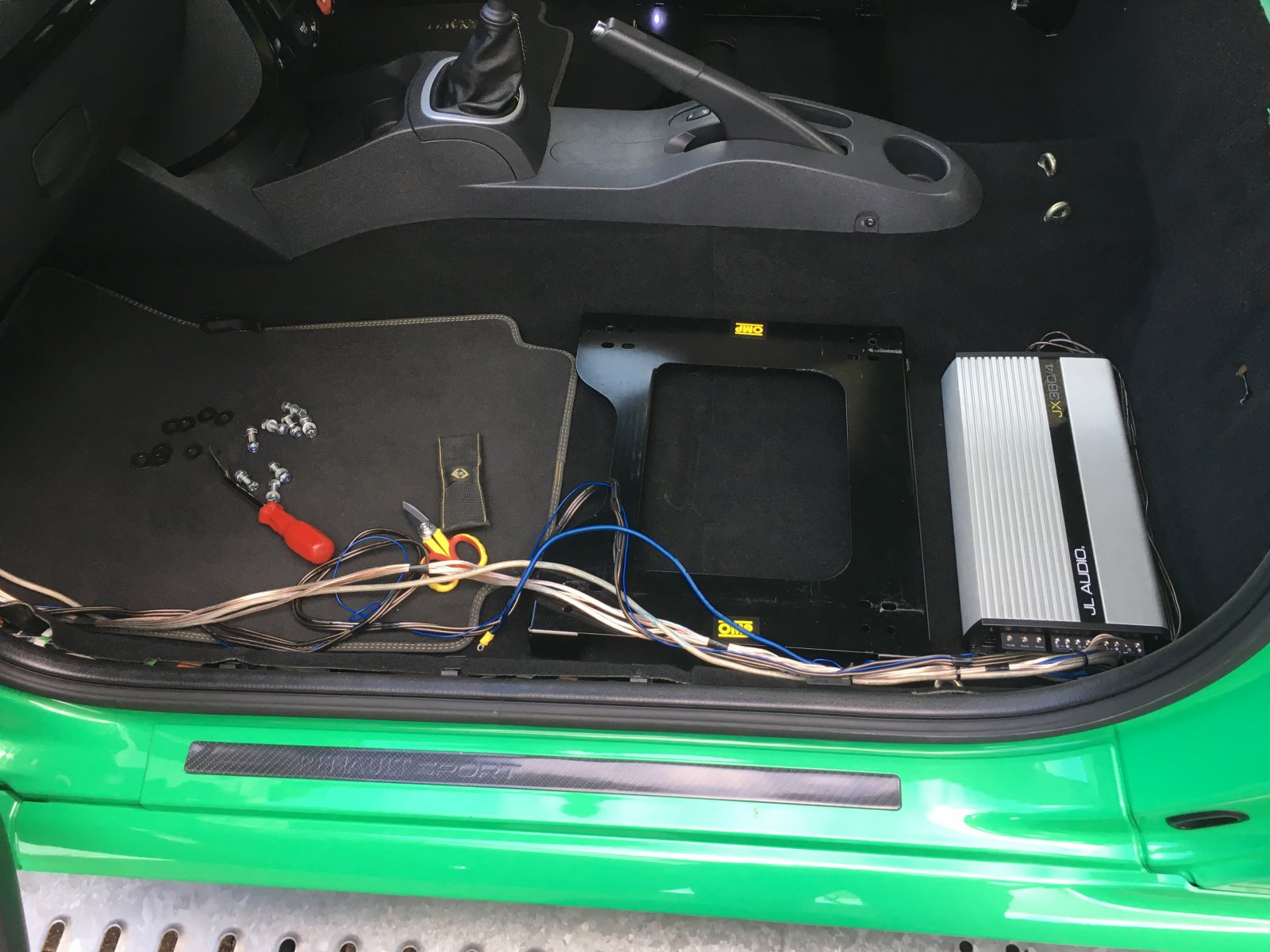

I will be retaining the carpets, as I do like the half / half look, although the amp etc has been removed to make way for the extinguisher system, but again I will retain the stereo just to have a little creature comforts :grimacing:
So amp out, ready for rebuild tomorrow or by the weekend!

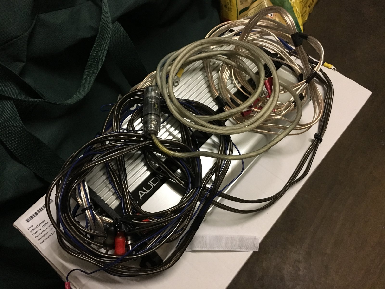

Didn't actually realise that these were worth so much cash new! (so if anyone's interested in this and the wiring let me know - JL AUDIO 360/4 :up:)

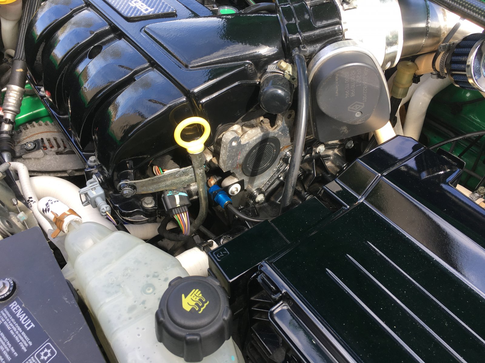

Also replaced the KNOCK and MAP/MAF sensors today, just for piece of mind!

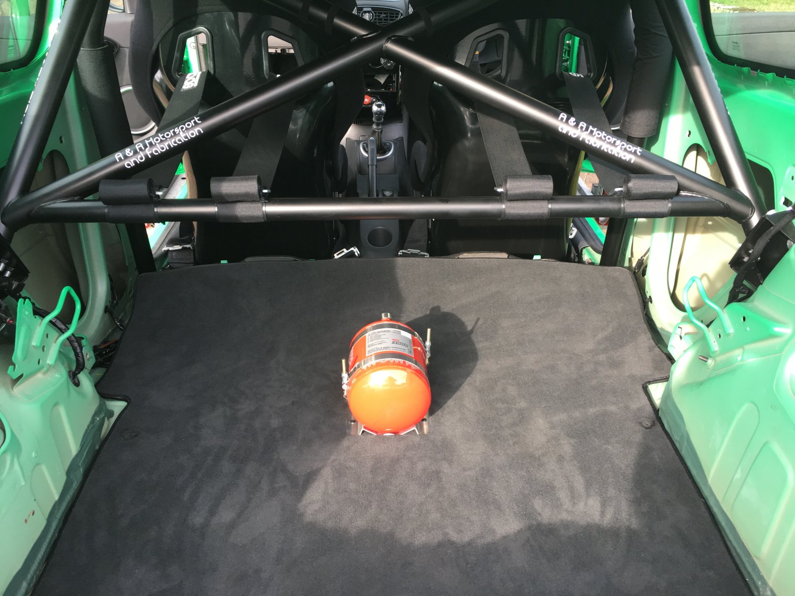

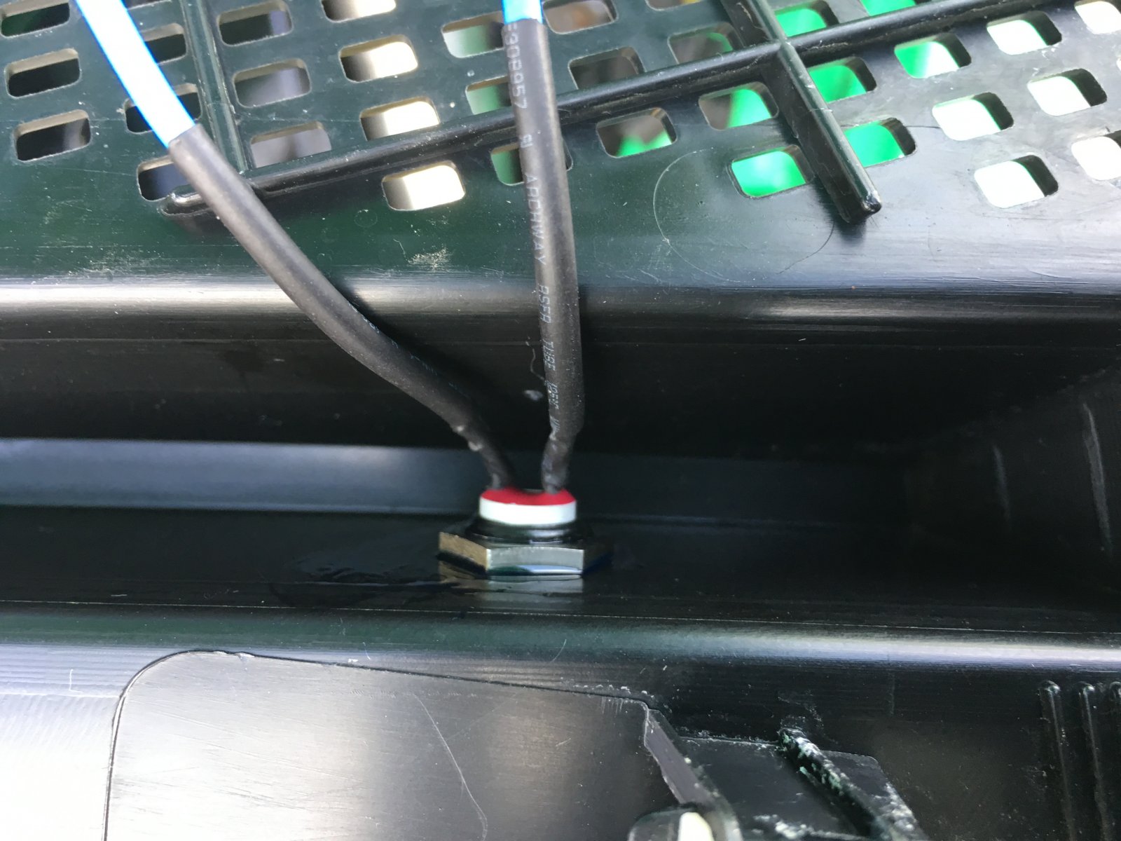

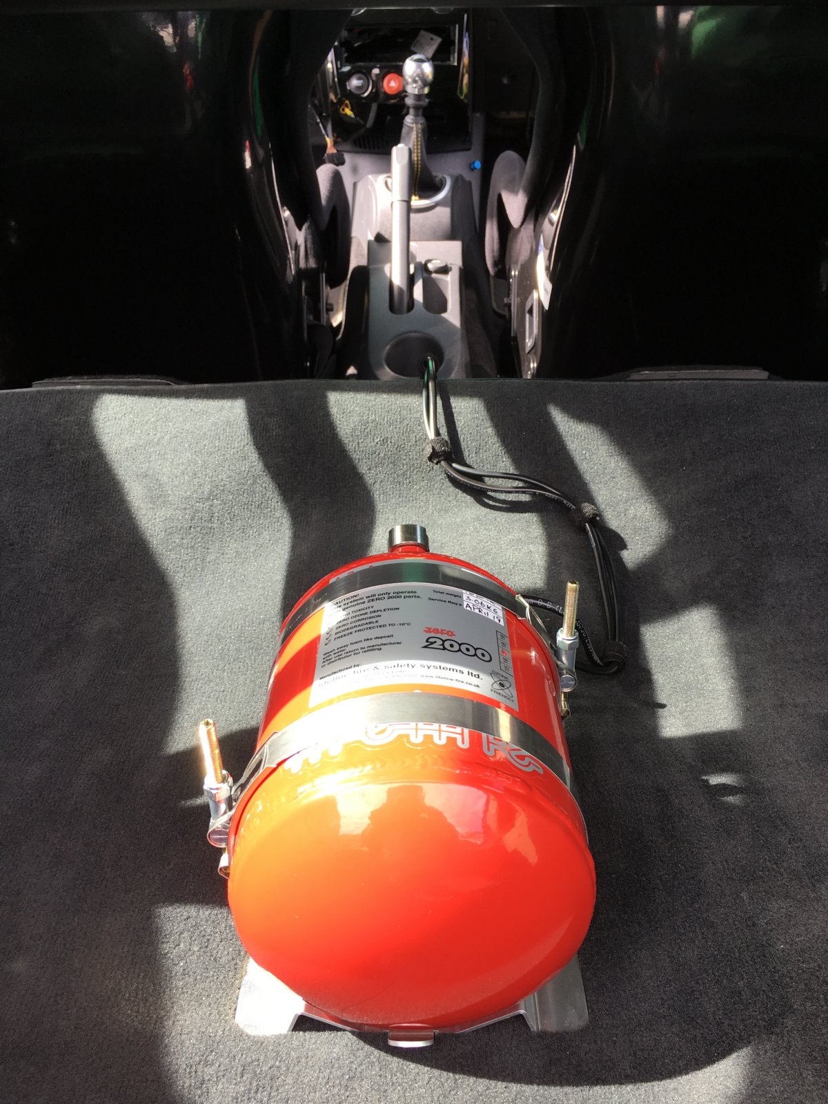

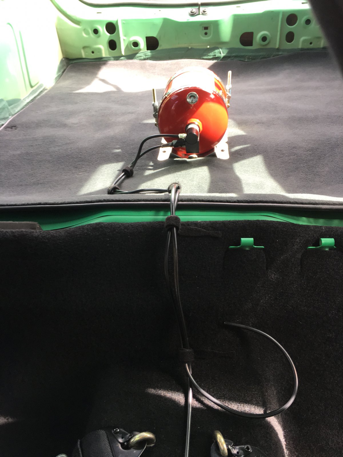

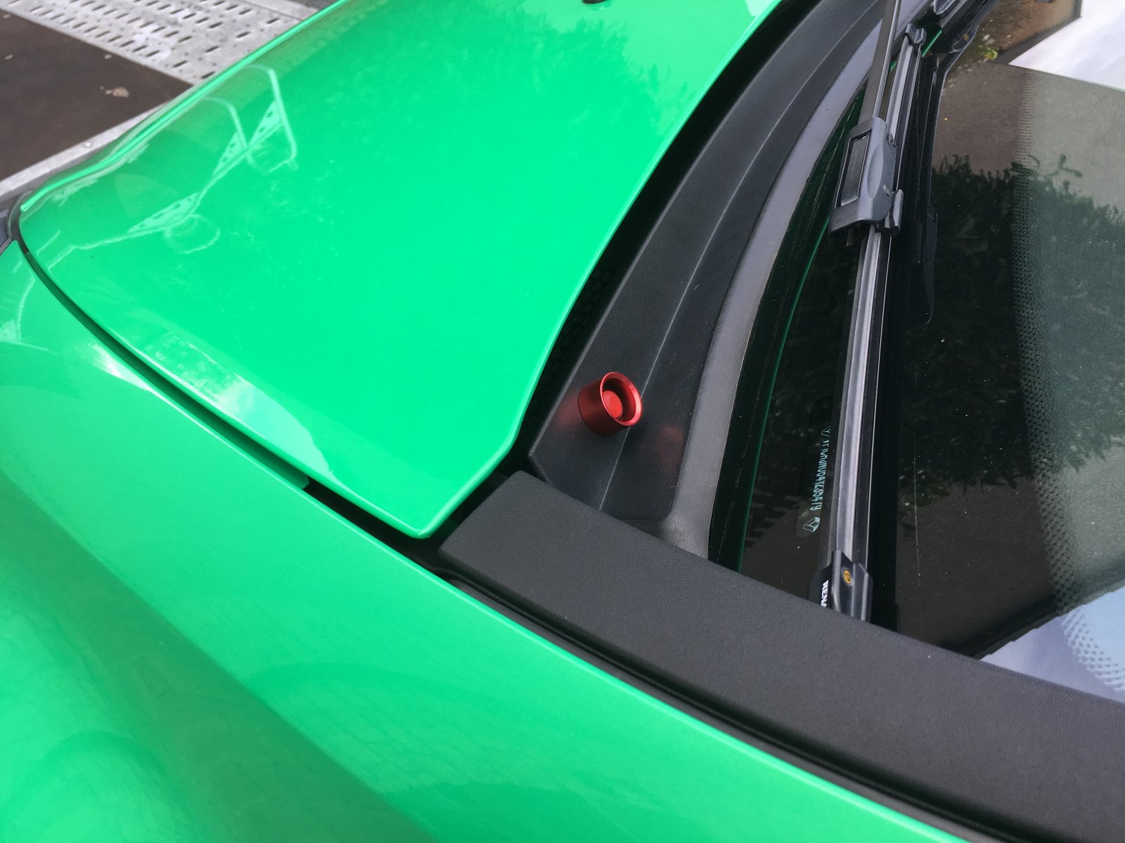

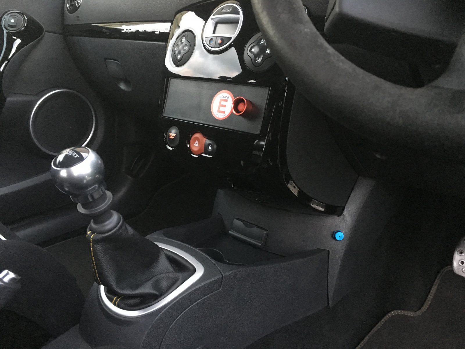

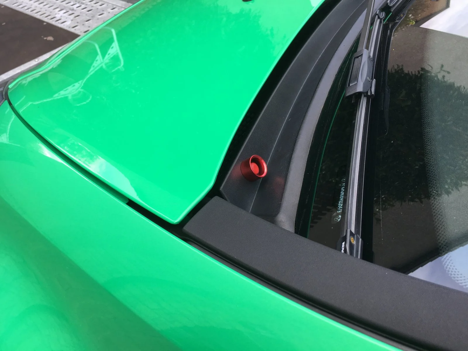

Made a start on installing the lifeline fire extinguisher system, well pretty much installed, until I get the stereo blanking plate delivered! Had to sacrifice the stereo, as suitable dash space on a 200 is hard to find and everything will fit nicely into that space as it did on the Trophy :up: Also I don't like destroying main dash panels.
Took forever as it needed to be discreet in this one, as whilst it looked great having the pipe work on display in the Trophy, this has to be accessible but hidden. Not 100% MSA compliant, but it's more for my piece of mind and certainly can be made compliant in 5 minutes :smile:
Fabricated a little bracket, buffed it all up and gave it 3 coats of satin black, to point the underbonnet nozzle into the injectors, may relocate this to cover more of the engine bay, but this is probably the biggest risk point under their! Space is just very tight under the bonnet and a point that covers all just isn't that easy to find! Was better in the Trophy as the top inlet wasn't needed and helped distribute easier.
Will get the stickers on once I get the stereo plate and install finished. All wires have been continuity tested, after squeezing them through the bulkhead, and all good :blush: so just the internal switch to wire in, in the same fashion as the external one, and plug in the control box.
If it ever comes out, 2 rubber grommets and you'd never know it had been in :up:

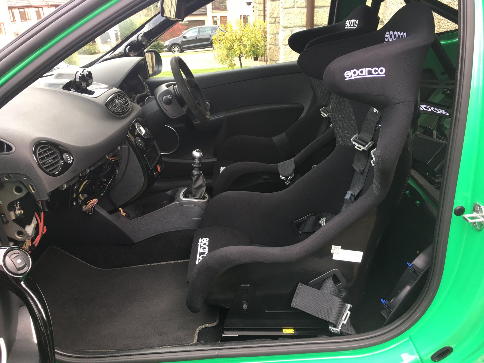

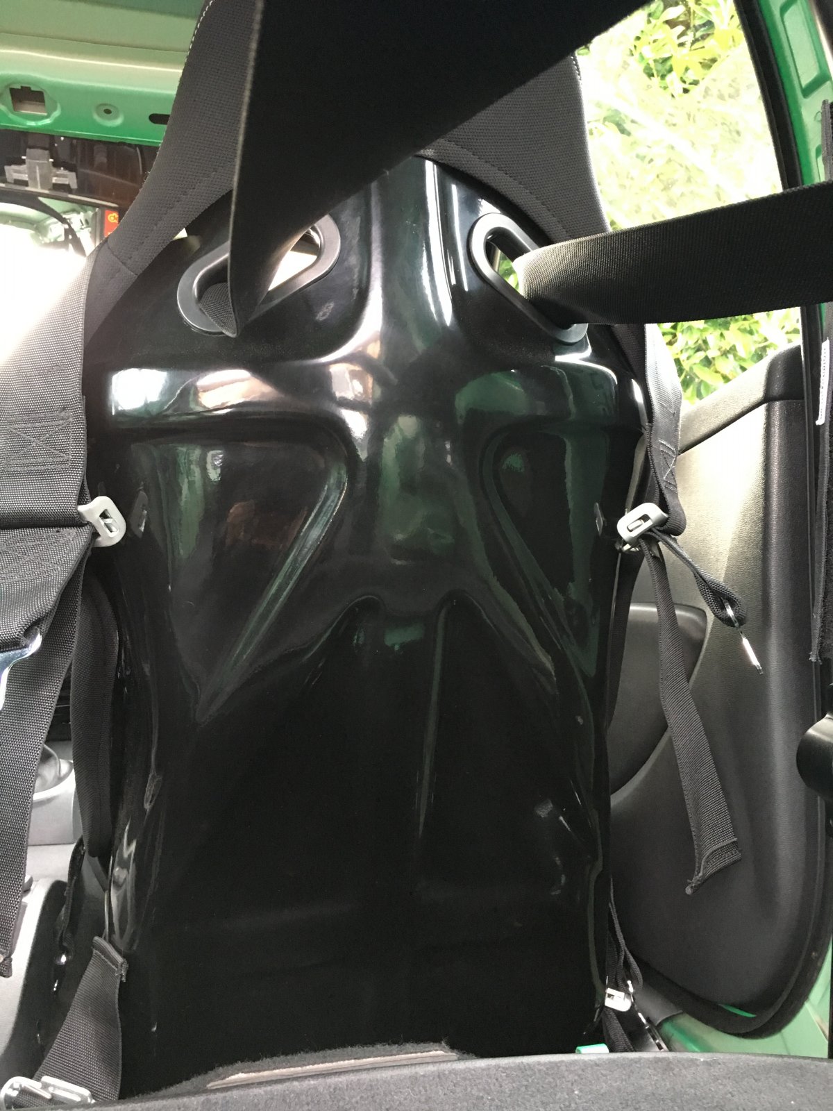

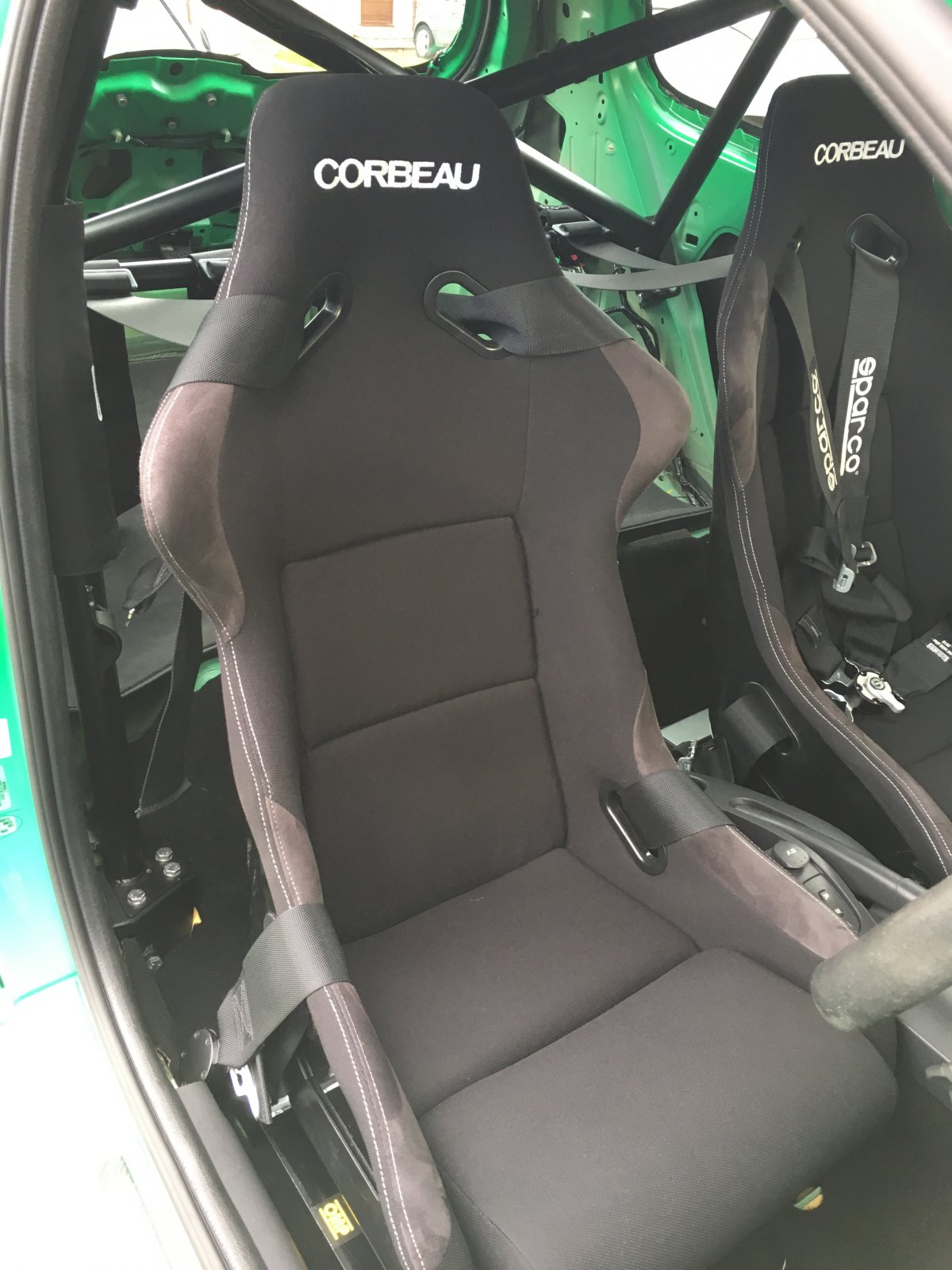

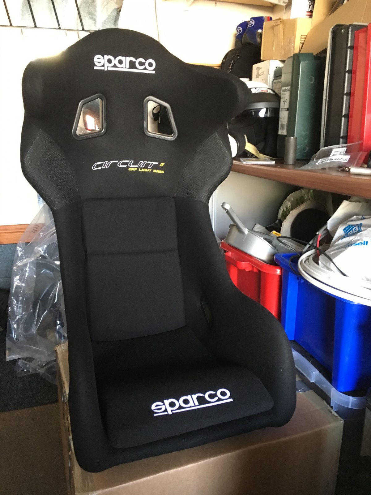

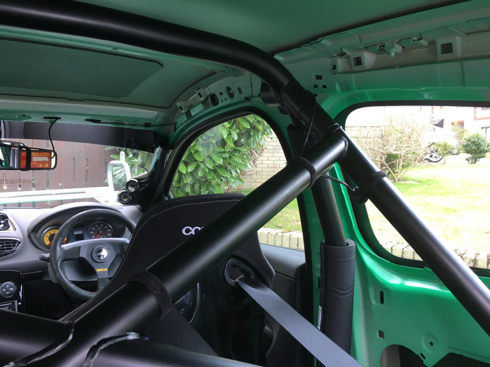

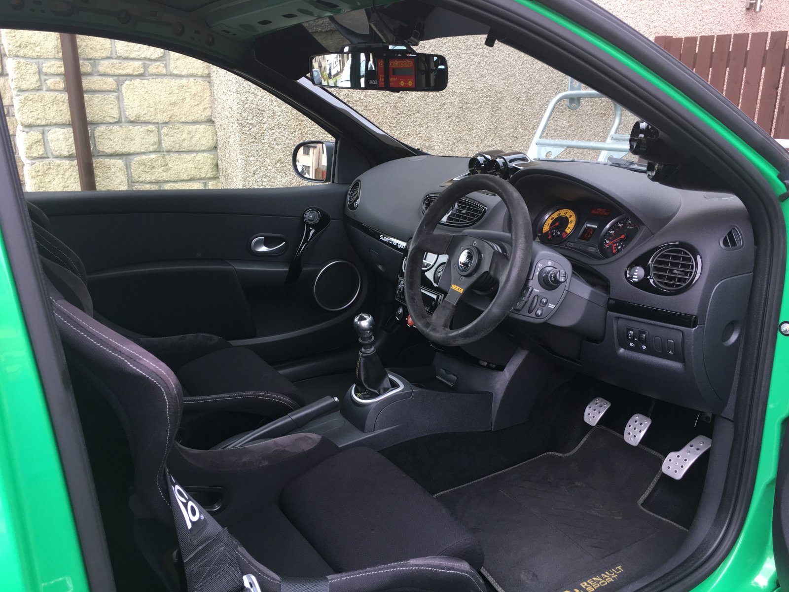

Oh and the new seats are in!
I'm possibly going to heighten them slightly.... set them at the same height as the corbeau ones, but feel this is just too low. Whilst I understand the lower centre of gravity requirement, seeing over the steering wheel I would say is just as important. I'm 6'1" and struggling as the dash height in the 200 is just way higher than the old car!
Also re set all the harnesses as the way they were set before just didn't work... all good now and tidied up :up:

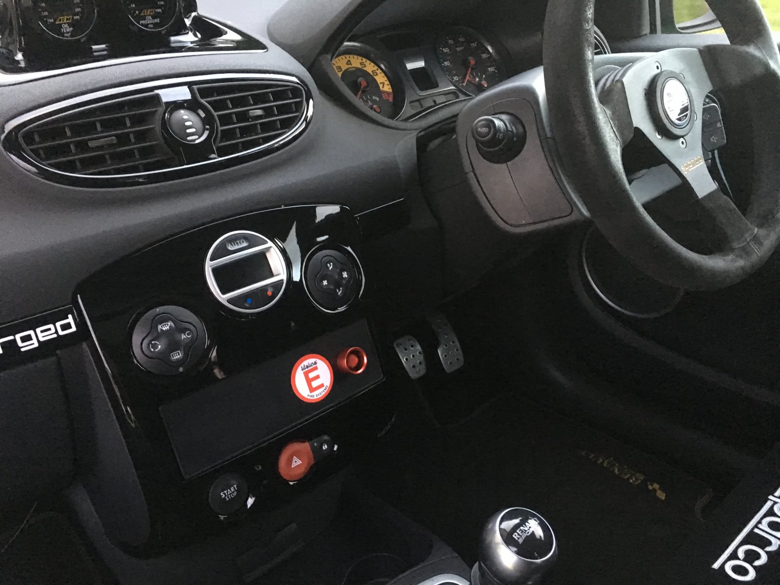

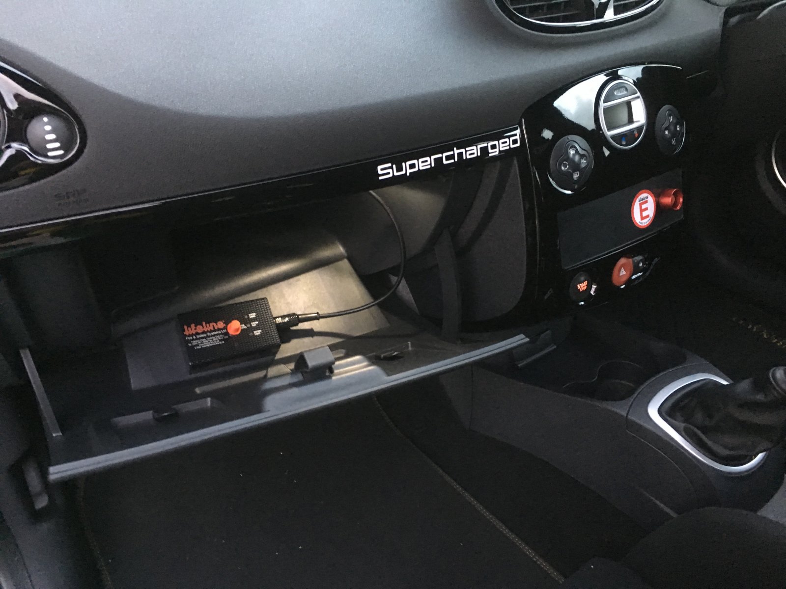

Extinguisher install now complete and kinda discreet..... MSA would like the activation box on display, but as noted it's a 5 minute alteration and I like it hidden, knowing that it's operational. Securely fixed inside the glove box regardless :up:

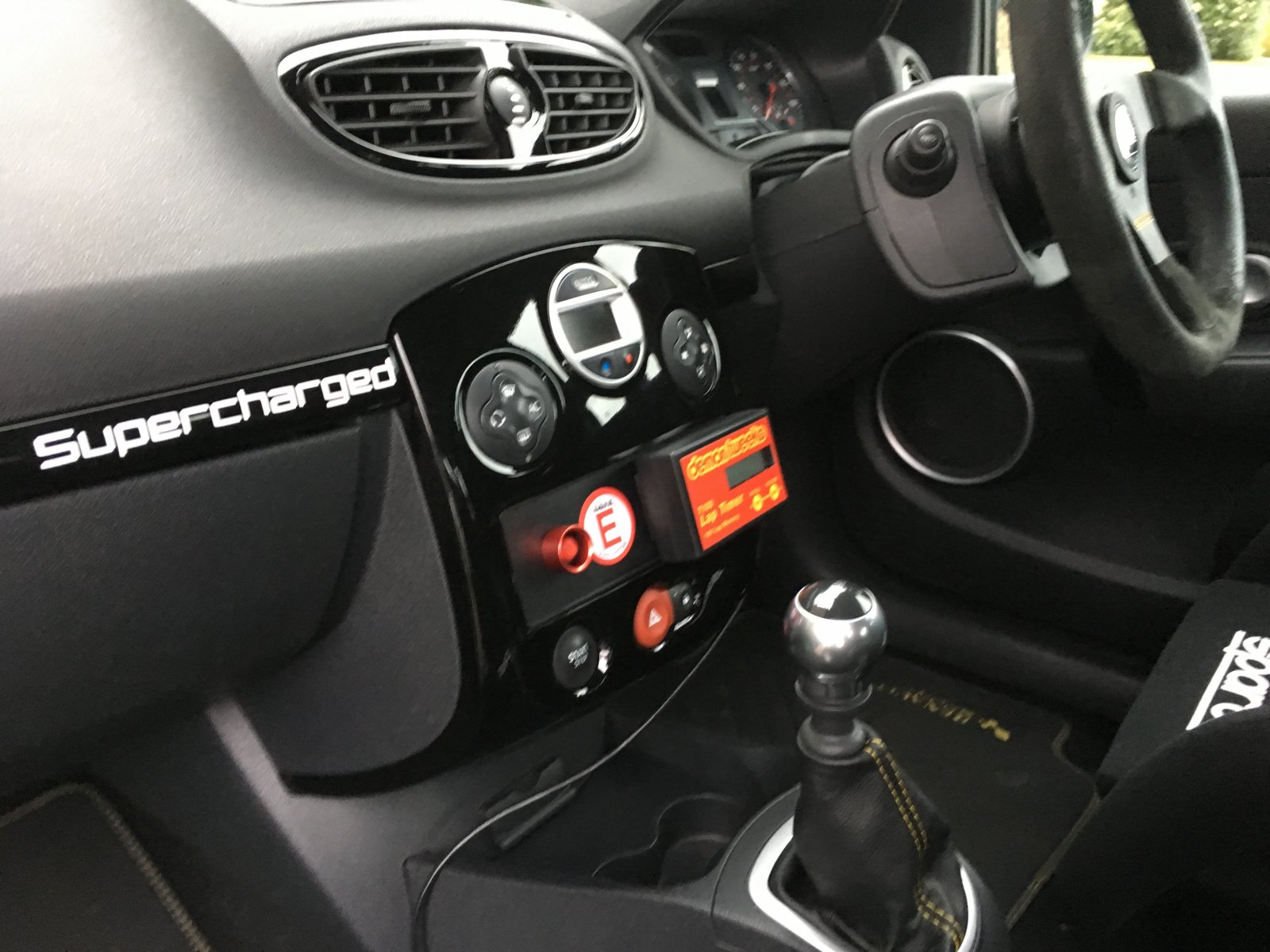

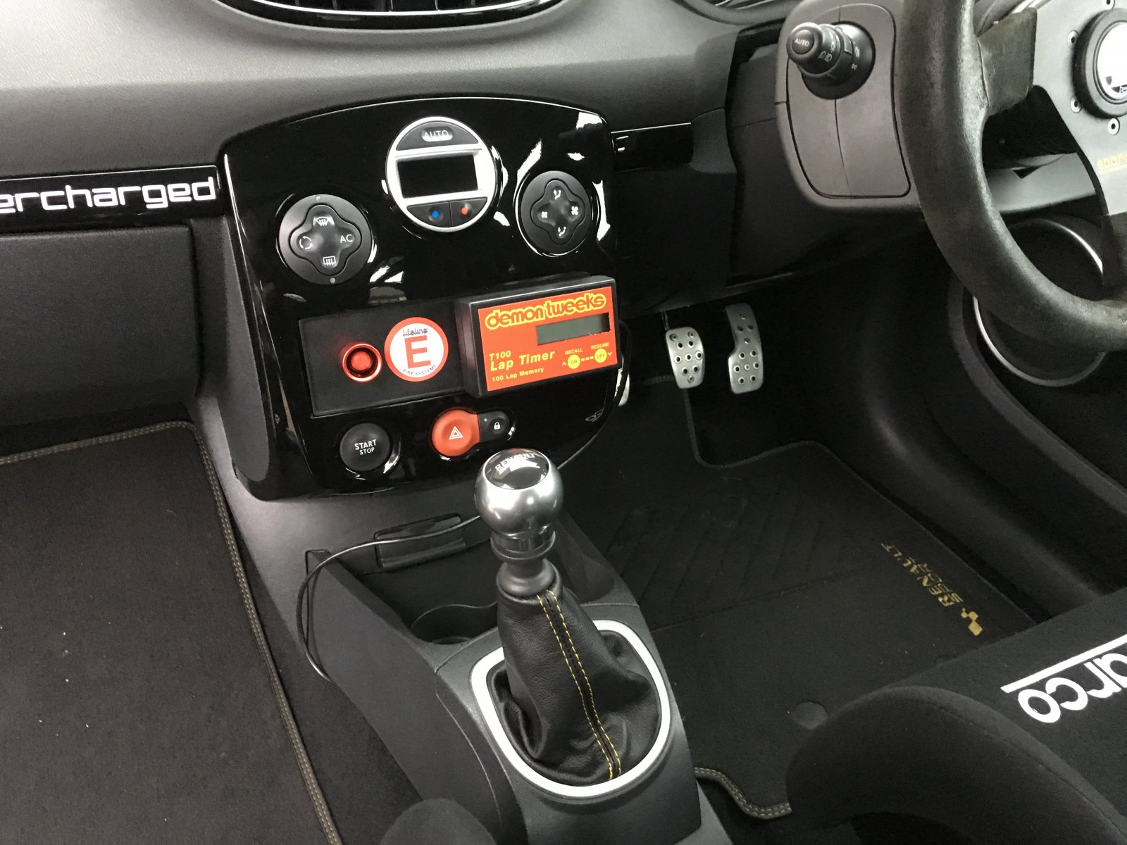

Had a slight re think in the Lap timer location....!
Whilst I didn't mind it on the mirror, the mirror itself was the issue! Just couldn't get to grips with how it distorts the distances. Anyway, a quick flip over on the stereo blanking plate and the lap timer fits perfectly... I'll work on the cable routing, but for now it's out the way of the gear stick....
