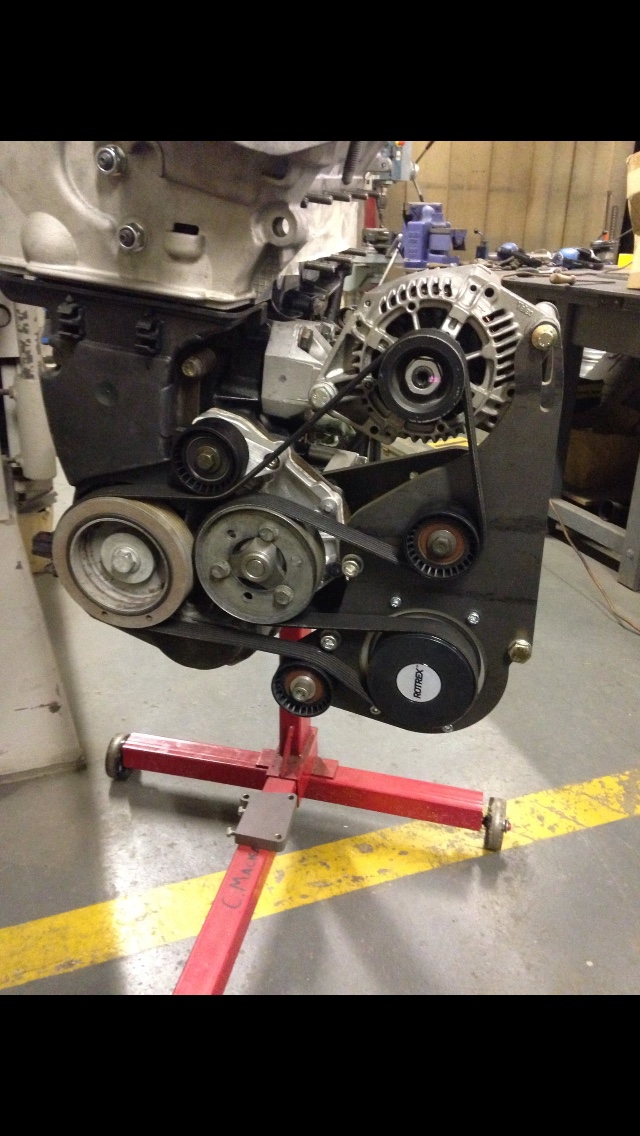

I already have the aircon deleted and also have epas steering so plenty room. Why does the charger attatch to the alternator belt? Does it not force air like a turbo? Also is it a must to change the valves like you did or was that just for reliability? Thanks
@notfastnotfurious do you have the pms aircon delete? If so you would need to convert back as the s/c can not be run on the pms kit did to belt width
The charger runs from the crank and is run off the aux belt drive as it replaces the air con pump in location
As it's a belt driven turbo in effect so requires a belt to drive it unlike a turbo that runs on exhaust gas
As for the valves they are Not required for low boost but would be a good upgrade as I had my head off at the time and running more boost it made sense

most of the hard work will be done already with the kit tbh, pulley sizes are either 85mm or 90mm depending on whats required, my kit takes care of all the belts and pulley side of things

You can also play around with pulley sizes and restrictors to tailor the boost and power band. I used a 95mm pulley on mine as I wanted the boost and power nice and low and further up the rev range as this was better for the racing.
The brackets look well made mate, I would have had some myself if they had used an auto-tensioner.
