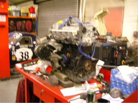

i have so far removd the AC,PAS,im leaving the belt driven water pump as its at the bottom of the block, and wont be getting in the way. i wont be having the standard inlet manifold either ;)
charger setup is all done, still working on his engine though.
Here's a nice blurry image for you, i wont be showing mounting or belt routing until its done.
A bolt on kit for a stock engine is on its way.
  02' PH1 172
so how much of a mission is it? i wanna try get someone to do it down here.. lots of work and complicated??
Its super tight, generating belt sufficient wrap and rigidity are all issues.
Not really willing to give anything away, but mount kits will be available if people want to do the rest of the setup themselves.
