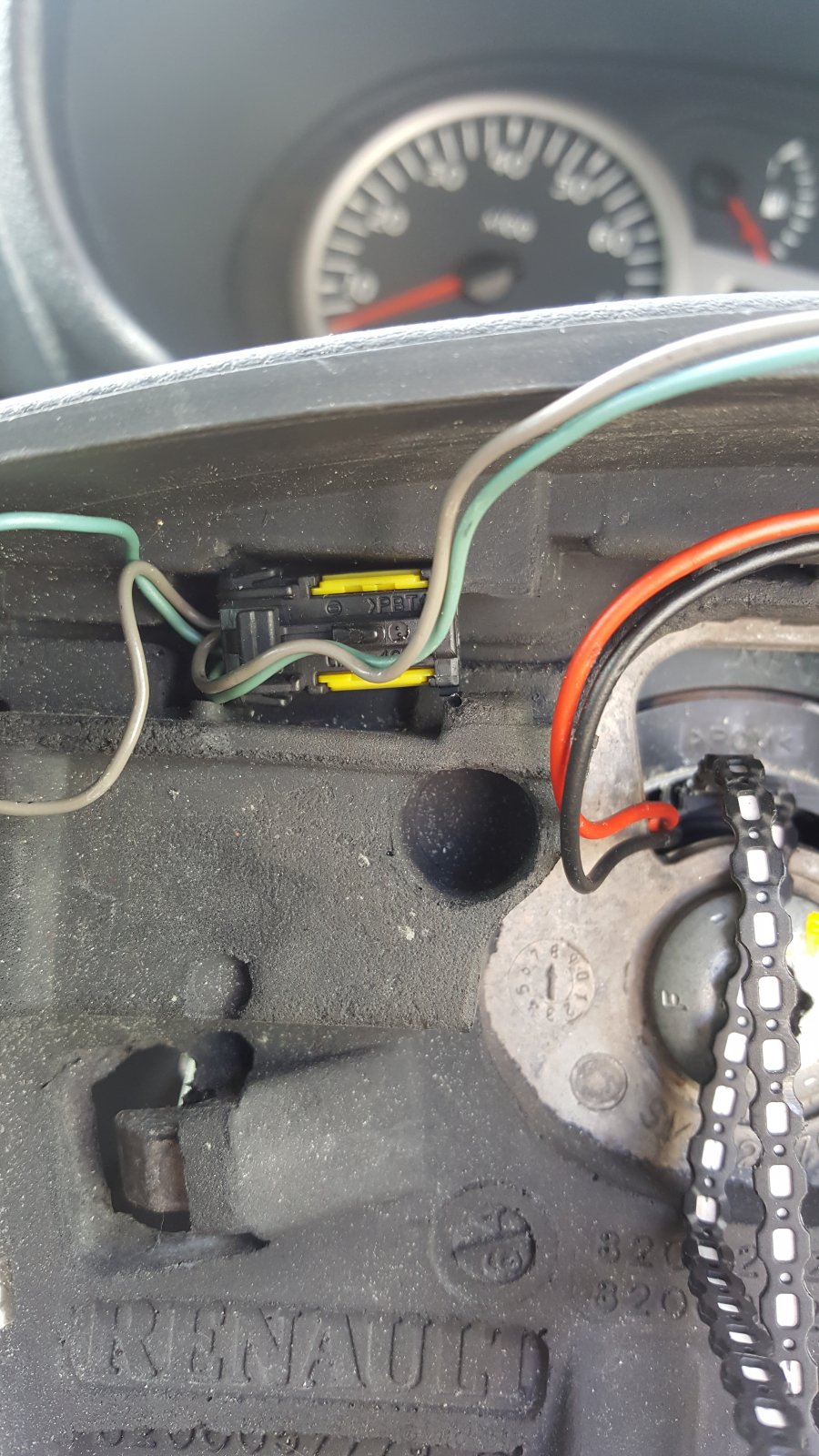

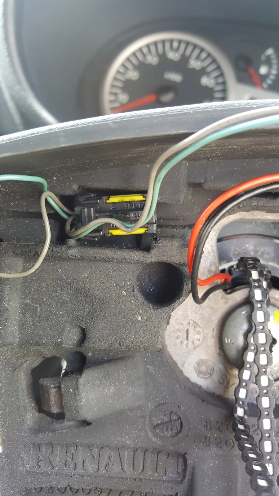

Hi all my cruise control has never worked so i rest brake switch still wouldnt work so i took airbag off and found the steering wheel switchs are not plugged into anythin i have attached photo to show.
I cant find where it should plug in and ideas. Thanks in advance.

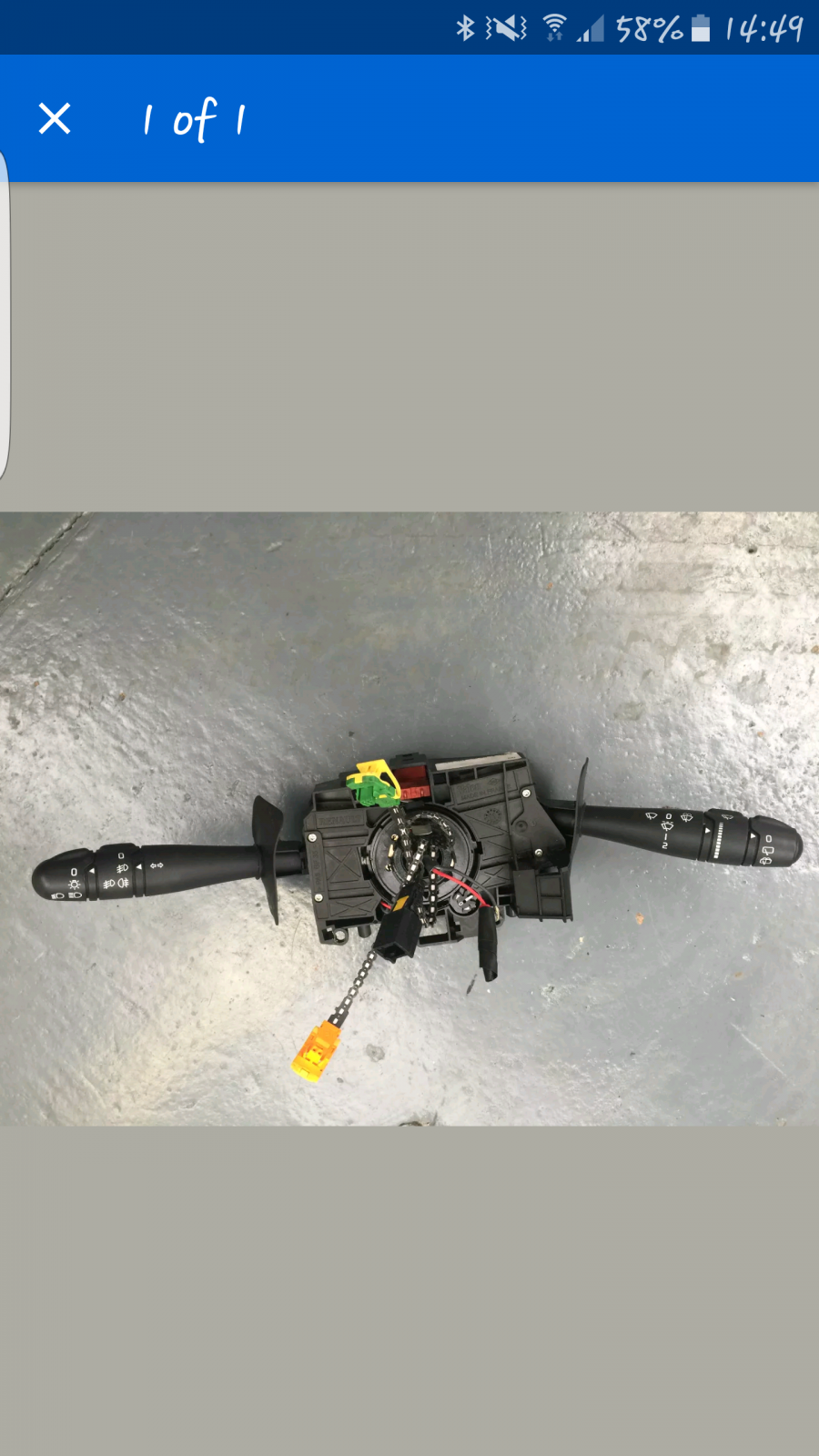

Somebody has fitted a standard squib (no cruise control).
So yes you need one as per your photo - fingers crossed that should sort it.
