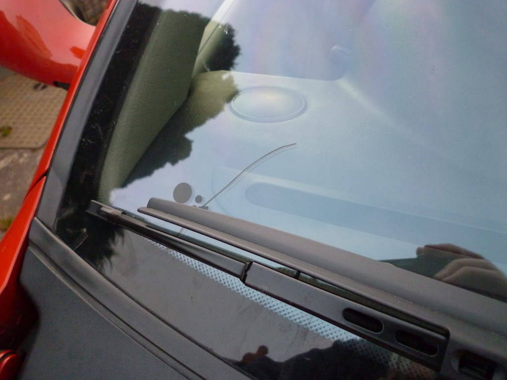

Got my MOT on tuesday and this happened today :mad::mad::mad::mad::mad::mad:
Guessing this will mean complete new windscreen? I have no faith in Autoglass being any good, anyone got any experiences?

yup as far as i know! Get on the blower to insurance, Gavin will sort you out ;)

Just keep an eye on them when they replace the screen. Make sure they strip out the old sealer, and not just bond over the old sealer.

Make sure they are very careful with the rain/light sensor aswell. If they disturb the gel pack, its goosed.

If I was you mate I'd get the yellow pages out and find a local glass fitter. A lot of them do insurance jobs just like Autoglass.

Autoglass have always done decentish jobs for me (and they offer a guarantee against the windscreen falling back out) If i was you just make sure you check the windscreen they bring and make sure it has no chips or scratches, make sure it's a thorough check you do aswell because if you spot it after they've left you'll have no comeback. I always request a pilkington glass screen as their the best quality imo and if they say they don't have one in stock i tell them to ring me back when they do.

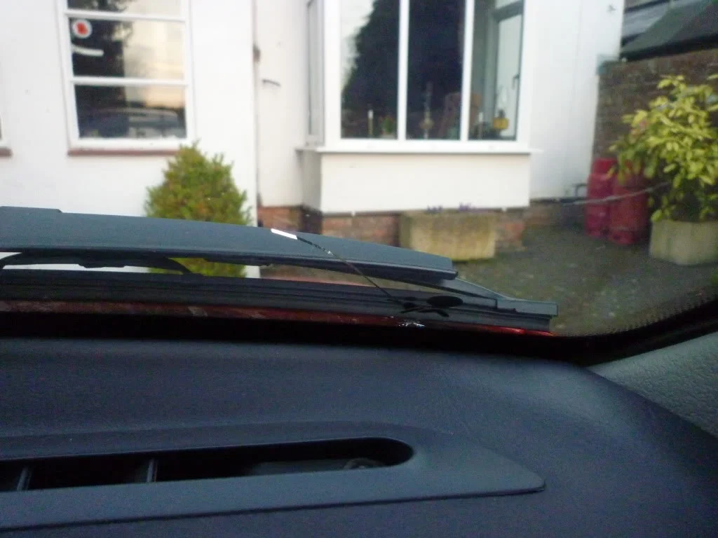

Other side is it might not be a failure but in a few days it may spread right across the windscreen...frost tonight for shropshire
