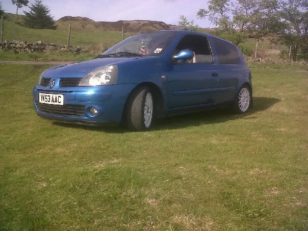

When i bought my clio at age of 16 it had tints in it and being young i thought yeah they look pretty cool, now seeing all the clios on here without the tints im thinking they look a lot better without the tints.
sorry about poor pic quality, only have phone for picturess!! :(
Any one have this colour clio without the tints so i can see how it looks before ripping them out?

it will look much better. nice looking car, its just the tints letting it down imo.
