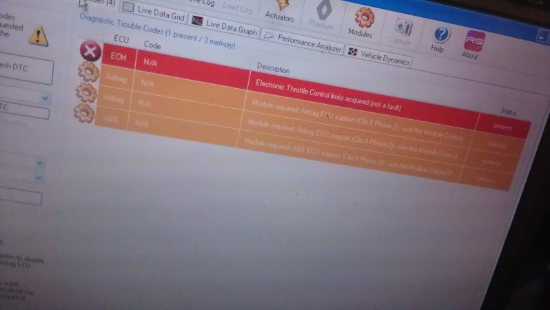

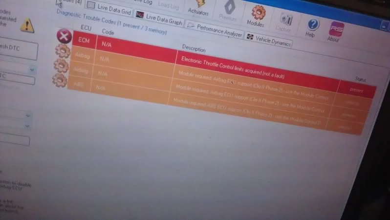

What does this fault code from an RS tuner mean?
The top one is normal, the ecu will set the max and min throttle limits every time the ecu is powered up. The bottom 3 are trying to get some more £££ out of your for more indepth diagnostics.
FFS.
