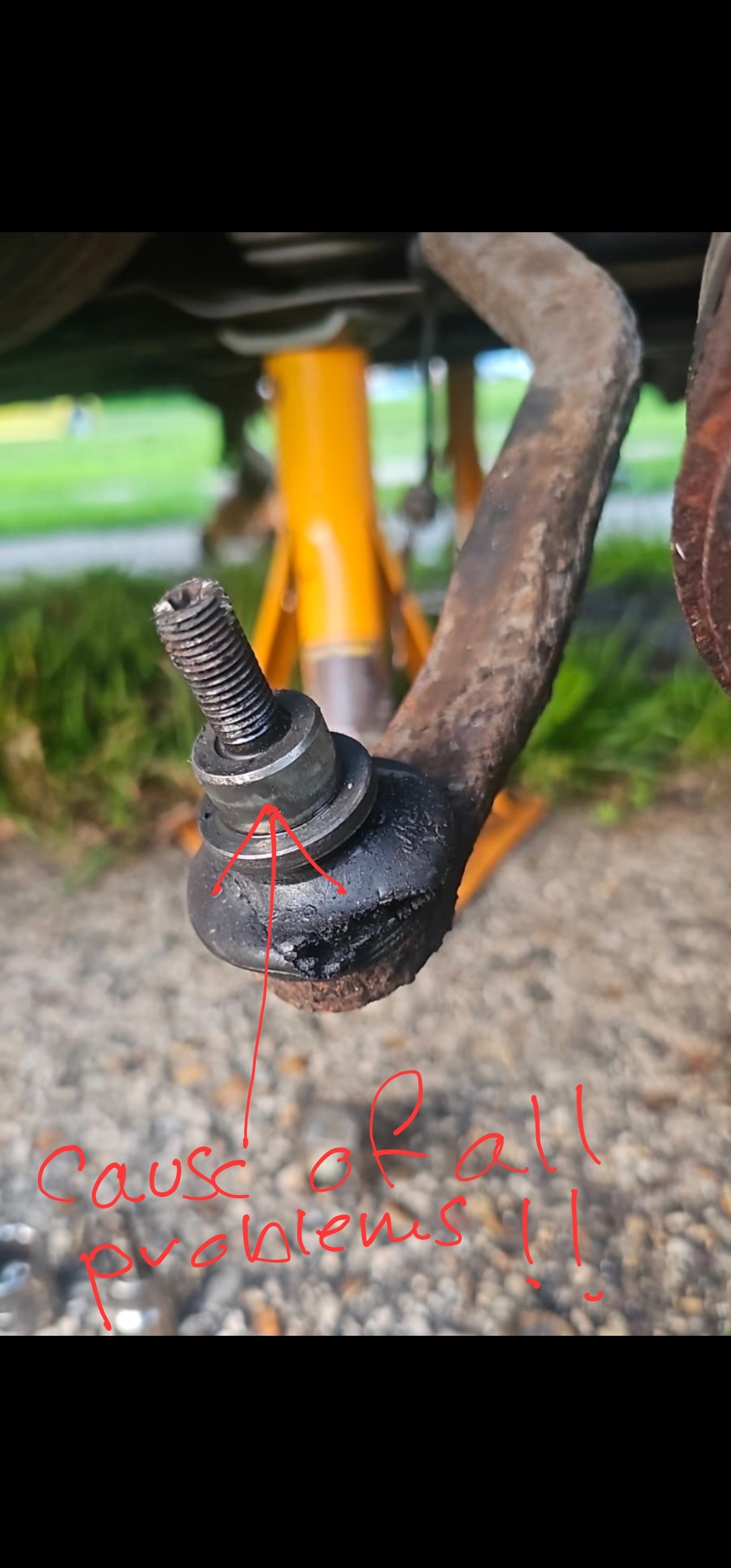

Turns out there's a metal adapter bush in the hub where the track rod end goes in.
It'd got stuck on the old trackrod that I'd binned without knowing what it was.
All fixed now!

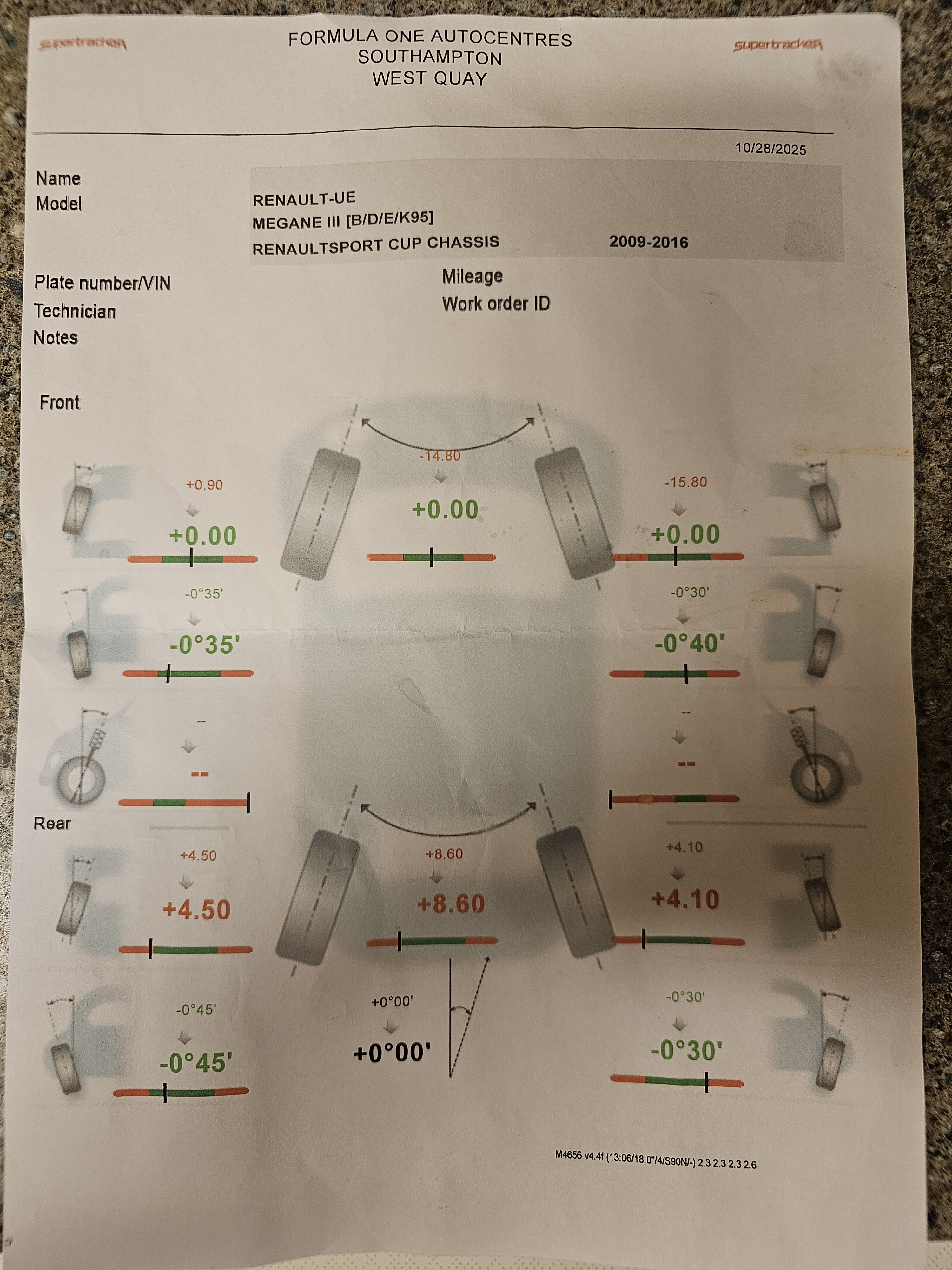

Check wheel speeds on diagnostic to see whats going on. Ive only ever had tc issues with geo out.
Any pics of the printout for the geo? A lot of places are s**t at doing it sadly, might be worth getting it checked elsewhere.

Current geo:
