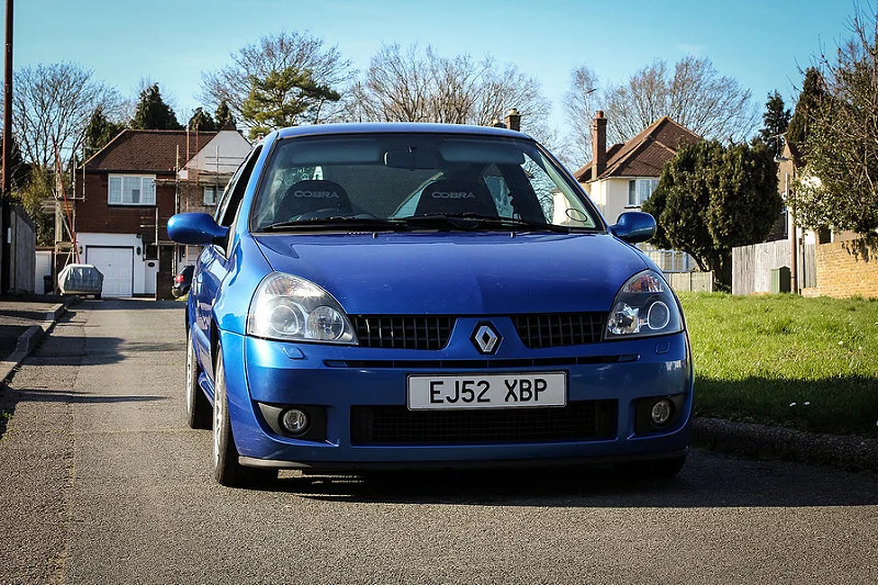

Et 35, 10mm spacers front (just to get brembo clearance) nothing on the rear (camber shims pushing them out a little though)......

Hi mate, I use 15" wheels as the car is purely track. I have clio 197 / 200 brembos. They have been machined down, where the adaptor brackets sit, by approx 4 or 5mm, generally the norm if you want to fit 15s. If you are using 16s then you are good fit them without machining (I believe). The wheel spacers are also required to give the extra clearance needed with 15s, oh and I only balance the wheels on the inside edge just the be sure everything is clear as it is tight!
As a recommendation, other than the look, I wouldn't do the conversion again. The stopping power is no advantage over the standard callipers and good pads, infact sometimes a hinderance. In the colder weather or wet I need to run lesser pads to make the callipers effective! In the colder temps harder tires mean I lock up as Carbon Loraine RC 6 or 8 pads have too much initial bite so I switch to the DS1.11 pads, or I'm locking up all the time. In the warmer weather with sticky track tyres the CLs are a much better pad, but to be fair only as good as standard callipers with similar pads, so if it's purely visual effect go with the conversion but for track effectiveness just upgrade the pads suitably as you won't need any more.....

It didn't make any odds mate, I already have 2 sets at 35 so a third were sensible, especially for resale as well, so a safe bet. I had thought about the 25mm but it was pot luck with Team Dynamics (not too impressed with them). I ordered 35 offset and after an 8 week wait (quoted 3 to 4) 38 off set arrived, which doesn't seem much of an issue but et 38 did rub on the brembos in the 1.2 style. Had I not already had the 35s I would have went 25.....
