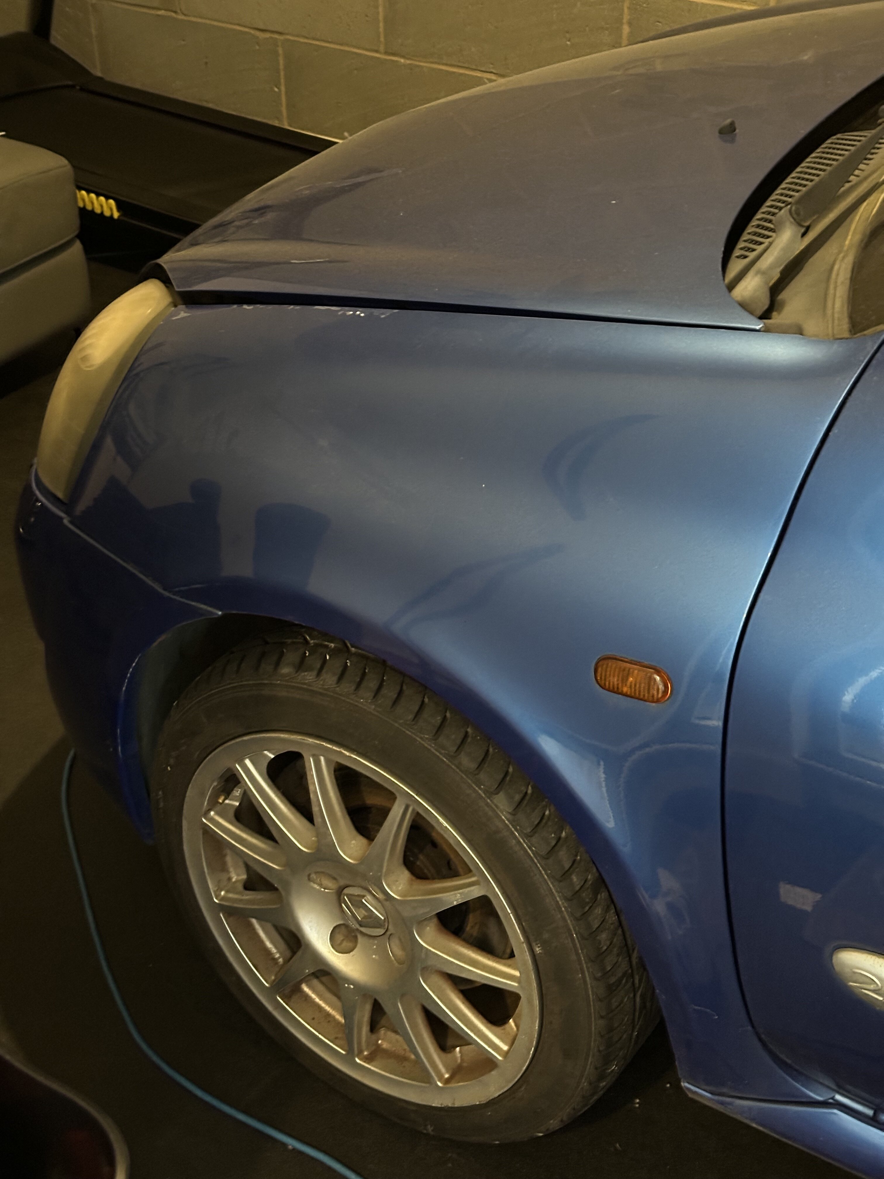

First post on here, been a long time lurker as I always fancied a 172 / 182, earlier this year I had a rather unplanned, rather unloved one owner 172 cup come into my life.
One of the main things it needs is tyres and the speedlines need a refurb, problem is I cannot decide on tyres - first issue is 195 or 205 (seem to read conflicting reports on how they drive on 205s) frustrating as more choice on 205s such as Michelin ps5.
Then there’s the loved Michelin ps3, by today’s standards a rather old tyre, likewise the Continental sportcontact 3. I’ve ran Avon zv7 on a previous car and didn’t hate them but didn’t think they were brilliant, mixed reviews on RainSport 5s in terms of feel, I’m going around in circles!
What are you guys running? I’m open to left field options. Car won’t see a track really and will be used for spirited weekend drives and cars / coffee runs. I’ll get a set of 15s if I use it on track.
I’ve done a search several times but only seem to get 15 year old threads.
Thanks
