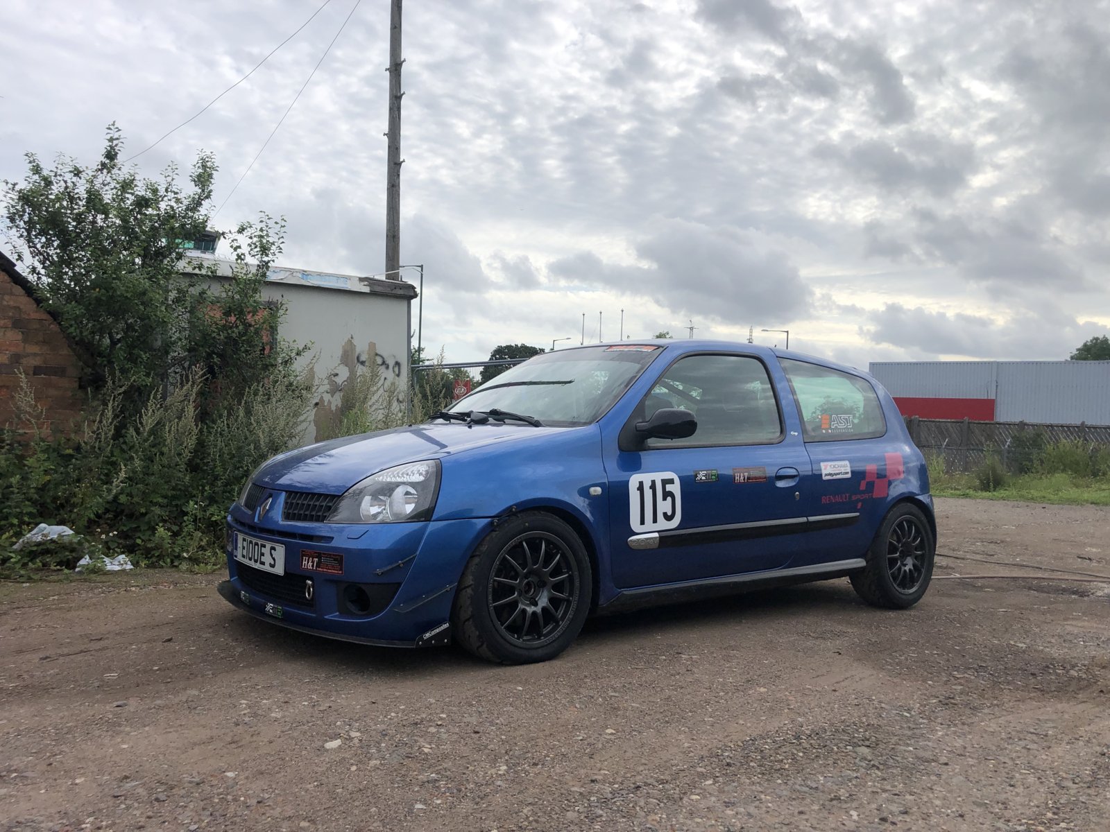

I run et 36 and et38. Both using 16mm front and 10mm rear spacers. 2.75 neg camber front 2.5 neg camber rear. No scrubbing. Running Ast5100 coilovers and set height at 300mm wheel centre to arch front and rear
