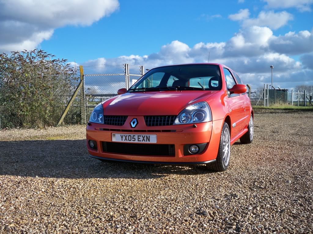

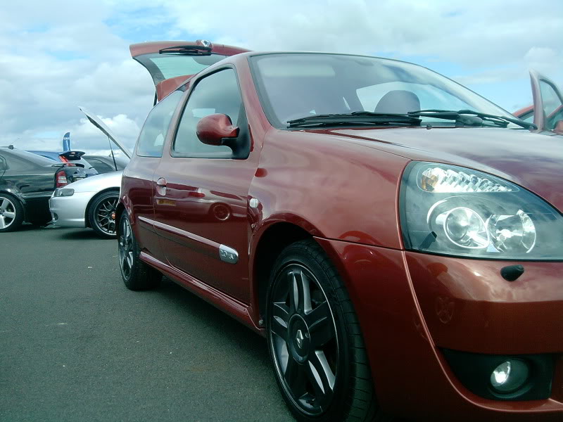

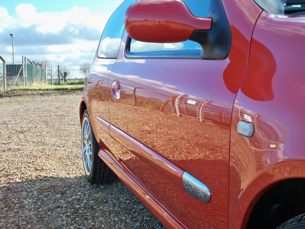

I've got the Pro Race 1.2s 16" et38 too and lowered about 50mm all round, no issues what so ever.
Sorry, haven't got pics that show off the difference much, best I have since fitting them. They do fill the arches much better than standard wheels.
IIRC 172 cups ran et38 as standard anyway. Quite a few on et38s on here with no problems either as far as I know. BTW I'm running, 195/45/16 tyres on the front and 205/45/16 on the rear.
