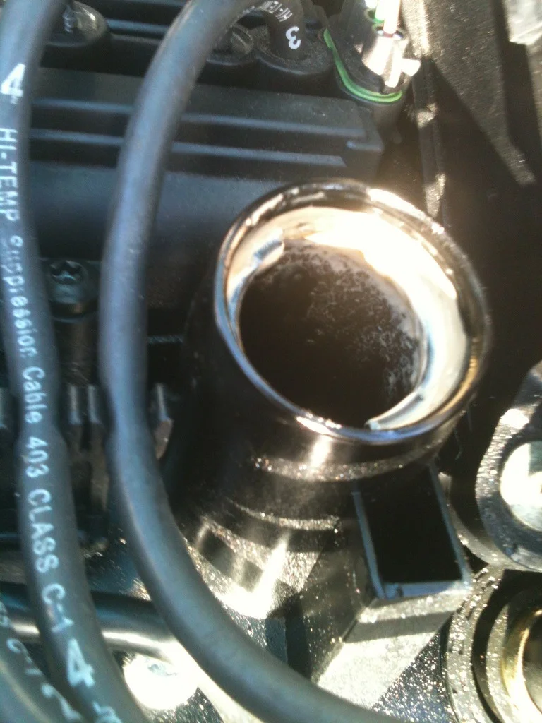

ImageUploadedByTapatalk1363017918.554509.jpg found this today, only a small amount of that gunk under the lid. Mechanic never mentioned it like..
Amos91
Honorary Member
Normal on the 1.2 because of the long plastic filler neck building condensation. If you are not losing coolant and there is no oil in the current coolant I wouldn't worry about it.
  1.2 16v
ah right sweet. well i checked the expansion bottle and it's now down to the minimum line... something wrong im guessing?
