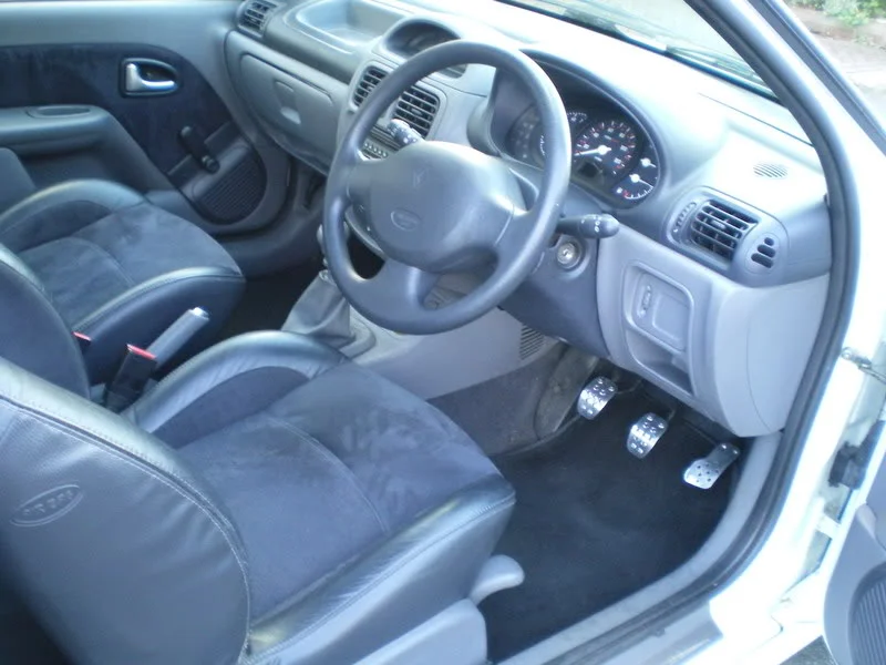

Are we looking at the Seats and Door Cards or what??

Where they easy to fit mate? and where did you get the material for the door cards? looksanayyyce

Didnt realise the early ones didnt come with a passenger airbag. Looks tidy in there though :)
RS seats make the std ones feel horrible too, I've just put some cup seats in mine!
Easy enough,once i knew what had to be done!Took about 30 mins.The material is from a local shop and cost about £4 a square metre.

Not too hard! Theres bolt through the pedals then the clutch is attached witha ball joint type thing which takes a bit of hard work to pull out and the brake has a special clip to remove the pin.
Thought id be more involved then that :(
Good work though :approve:

You say that about everything haha!Nah the pedals were easier than i thought.What do i need to buy for the Electric windows then?

To get electric windows to work in your clio, you will need:
Door wires - both side (for the plug - motor, switchs & maybe mirror
Window Motor - both side.
One or fuse in the rely fuse box
Door cards with window switch
Still use your same windows glass
I think ph2 wires will work on ph1 clio but remember the window switchs are diff plugs the ph1 & ph2. I did this in my old clio RN 1.2, it didn't have electric windows so I install them in & they work good! Oh I install electric mirrors, they work as well & got temperature show on the digital clock.:)

Ive got 2 complete electric mechanisms from my old car sat in the garage at home, infact the complete internals from both doors. Not much help to you while I'm living here though.
