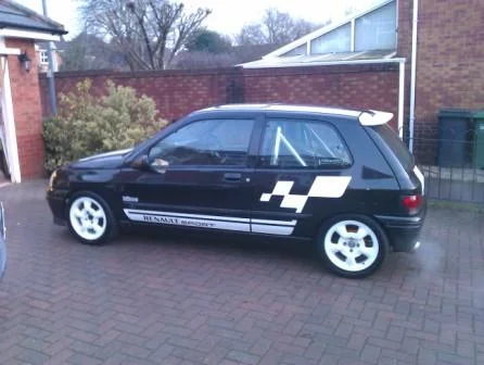

Very nice, but as stated, would look alot better without the white decals on the sides.

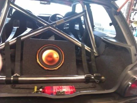

dislike pretty much everything about it, sorry. and agree with dan about the harnesses, do you want to die?
Nothing is bolted in yet as its off the road in my garage.. and seats are only placed in as im doung a lot of mechanical work in the car.
Please tell me you are going to put those harnesses in properly. For your own safety, DO NOT have them on a rear strut brace.
Don't want to sound rude, but bolted in ot not, those harnesses/seats/cage will not work together in a crash. I'd rather fcuk a corpse than be in an accident in that! lol.
Would it be rude if I said it was awful? Sorry I'm just not a fan of any of it.

front likes look awful,
and as said, show cages have no strength what so ever,
so in the even of a crash, the weight on those harnesses will bend the cage down as they go straight making them completely slack and allowing you to fly forward another foot into the steering wheel before jecking you to a spine shattering hault!
and thats only if at equally as week looking rear strut brace doesnt give way under the force,
you can hit 7G's of forward force in a accident, if you weight 75Kg's, thats 525Kg's pulling on those harnesses! for gods sake install them properly!!
think hes got the point about the harnesses, not into the valver really look much better without the white but hey everyones different
Really dont bother wasting you time telling him about the harnesses he doesnt listen. This was all covered over about 5 pages on c16v not so long ago, he didnt listen then, he wont listen now. I just hope his passenger know if they are in a serious accident doubtful they will be walking away from that with the curernt set up.
ZOMG those harnesses aren't fitted properly.

Dont get the logic in tearing out the back seats to fit a cage and buckets then adding a f**k off sub woofer to the mix but whatever floats your boat
He could fit NOS to counter the weight of the sub. Every hole...
