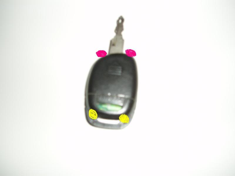

How the hell do you open it to change the battery!!! lol. Ive been pullin and pushing and bending and ripping but i cant undo it!!! It surely cant be that hard can it?

A bit crude , but there ya go .
Hold the keyfob in both hands , put your fingers on the red marks , next to the blade , your thumbs on the yellow marks and push the " whole " of the cover towards your fingers and it'll slide open .It looks like the cover is in 2 pieces because of the line in the plastic , but it's not , it's all one piece . Easy really ;)
