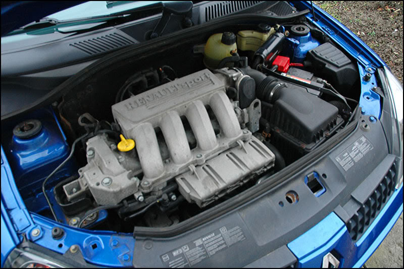

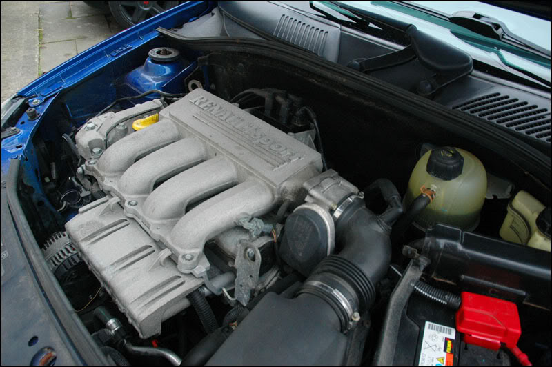

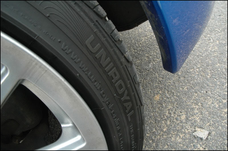

On hard acceleration theres a knocking noise sometimes, I guess it's the exhaust manifold, is this normal? (and no I haven't been doing wheelspins, not intentionally anyway) The tyres it's fitted with are Uniroyals are these any good? I don't think they are tbh as it seems a little unstable going round bends at speed, think the first thing is to get some contisports wrapped around the Turinis. :D

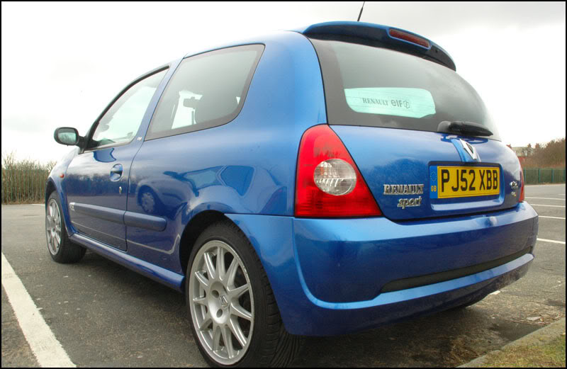

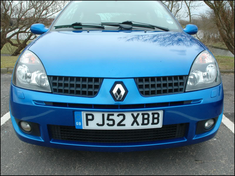

Looks decent, shame the factory standard splitter is missing :)
I know, don't worry I knocked him down for it, would be silly to walk away just for that reason though.

Don't go for cheapy coilovers, they really do ruin what the Cups all about. Been there done it. The knocking is usually the o/s engine mount. If you slacken on the x4 17mm and pull the engine (need a mate) as forward as poss, then adjust the mount to suit. Usually cures it.

Knocking noise? The 'dogbone' engine/gearbox mount flexing perhaps?
Uniroyals Rainsports i ran these for a year.
Great tyres imho...

Cheers for the advice Gaz I might just get the uprated K-Tec mounts if that's the case.

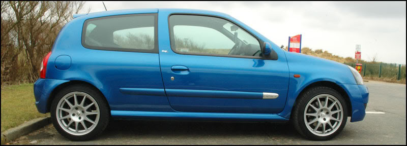

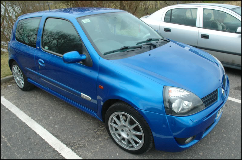

Looks smart mate but it def needs a little lowering. I'd only bother with coils if you intend on track work tbh. If not then some sportlines would do I'd say

Plans are to throw the back seats out so I need to be able to adjust to suit. Don't want a harsh ride so won't be buying cheap.

As said in the thread, the knocking noise will probably be engine mount related, common problem and normally is rectified by fitting fresh mounts. Also there's a guide on here somewhere for moving the upper engine mount abit.

The Eibachs sort that dodgy ride height out as well lol. Where the front sits higher than the back.

aye that pissed me off! lol. Back goes up a tad on them and front lowers quite a bit giving a nice nose down stance!

Those tyres are Uniroyal Rainsport 2's btw which get good reviews, I've found them to be great in the wet, but a tyre that works well on one car might not work so great on another.

That's what the seller said actually he said they were good in the wet, they don't feel that great in the dry though or it could just be because I'm used to driving a lowered clio? Think I'll get the coils before I make a final decision to keep them or not.

Very nice looking, maybe a bit on the high side but other than that its perfect ;), and I'll add in another comment about the rainsports, I found them to be a pretty decent tyre, like its been said they werent the best in the dry but good in the wet. all round pretty decent I thought :)

It's standard and I've only had it since Friday, give me chance!
