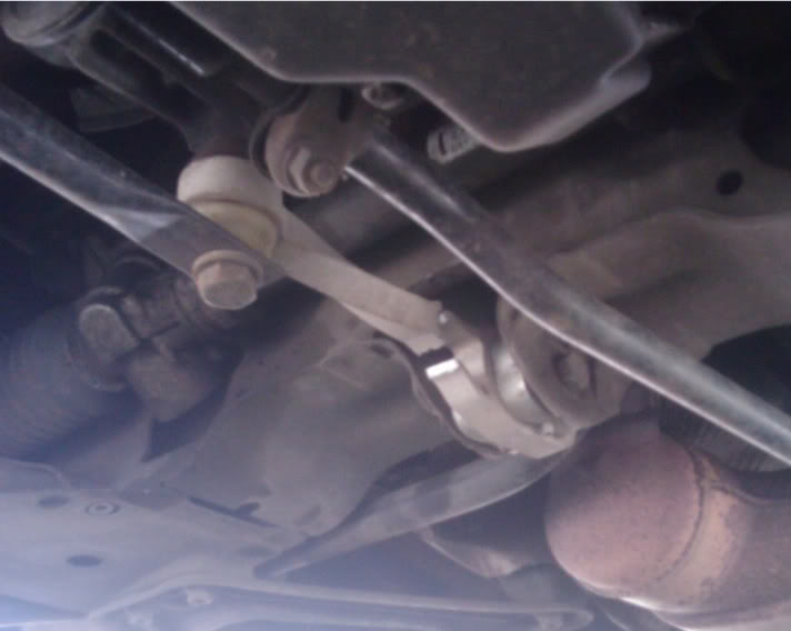

Went out for a quick blast today and it ended up proving to be a bit disastrous. Performed a really quick u turn in the road to get out of the way of oncoming traffic, when i put it into reverse and released the clutch there was a large bang coming from the engine area, didnt sound good at all, drove down the raod a tiny bit to see if i could hear anything else and the gearstick was moving all over the place and kept hearing banging. Didnt sound right at all so pull over and had a look under the car.
Found this:

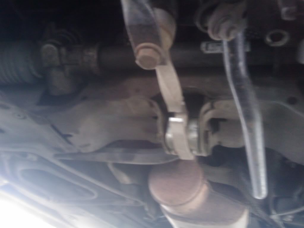

doesnt look too clever, completely snapped! guessing its some kind of engine mount?
any idea what i should be charged to get it replaced?
thanks

DOnt drive it like that. Not expenive or hard to replace on its own, leave it like that though and you could end up needed a manifold, shafts, other 2 mounts, rad etc etc
  Black Gold Trophy
yeah get it changed asap, as the gear linkage will be under a lot of stress that it isnt normally exposed to.

ok cheers guys, so if part is around £12 what should i be expecting to pay for labour etc? about an hours rate?

and by the looks of it a 17mm spanner/socket.
Approx 15 minutes work ?
  Clio S & VW T5
as above, it's a dead easy job, even for a complete chod.
Just don't take the old one off til you get the new one, then fit the new one exactly where the old one was, and the same way round!!!

im amazed at that one never seen that before like everyone else says defo dont drive it but when you get a new one you could do poly bushes in it to ;)

K-Tec sell them for the sports. Not sure about for the non-sports but I wouldn't be suprised if it was the same part.

Just get a genuine Renault dogbone. Dont bother with Poly bushes in the twisted type if you're running the other 2 as Renault mounts because it will ruin the gearbox casing.
