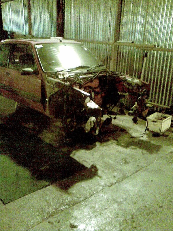

Changed gearboxes, engine swaps, cambelts ALL sorts on my set of axle stands, look like they were made in the war too :D
