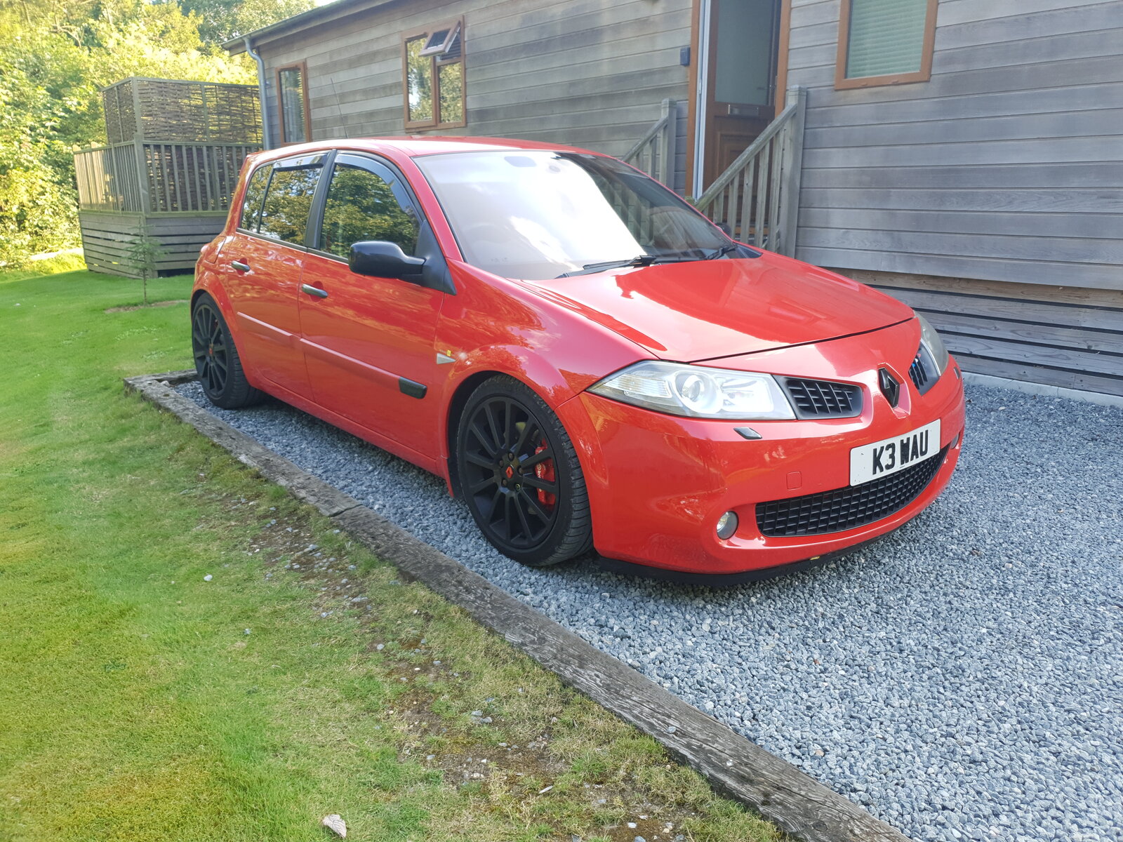

Krarl
Where do I start!🤣🤣
Check swivels, they knock, clunk and squeak when turning. The standard turbos on these are w**k, check for fin damage and if it sounds like a police siren then walk away or drop the price £500. Window regulators are an issue, check all windows work, make sure it boosts properly because they're common to have the plaggy boost pipe rub holes in it on the cold side of the cooler. Make sure everything on the squib works, if wipers are a bit funky then itll be the squib. Engine mounts are a bit issue on these too, the oil filled one is a fart for failing quickly. EGR's are gimps too, theres a lot of stuff involved with the emissions system on these
Theres a lot of issues with em but if you drop on the right one they're mint cars! Mines a LUX and CUP, easiest way to tell is turn the traction control off and if it comes back on over 30mph then it's not a cup and LUX pack is leather seats, keyless etc
Gimme a shout if you need to know anything specific about em, as @TomSx mentioned, I have mine apart quite frequently haha

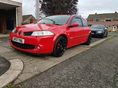

I like the look of them hate red car but like these in red.
