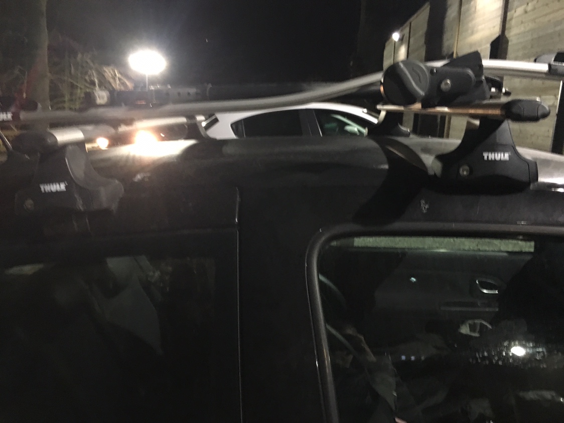

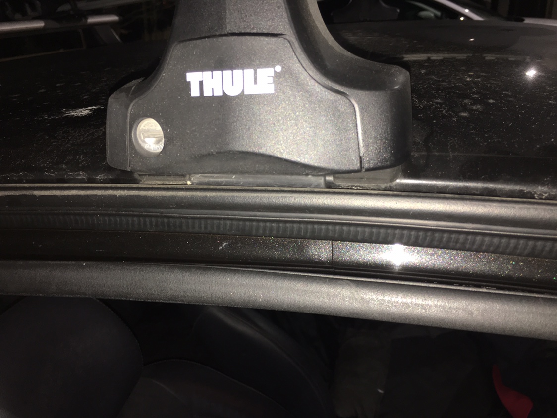

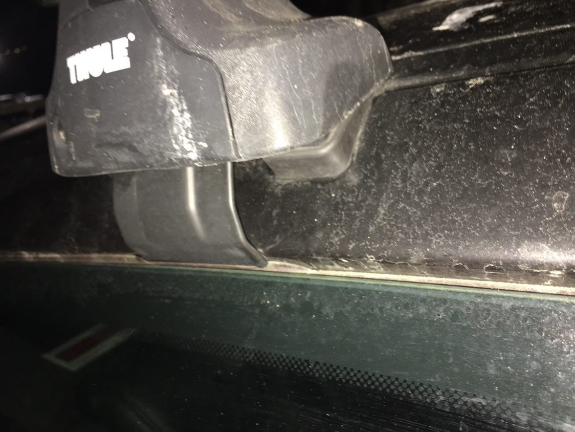

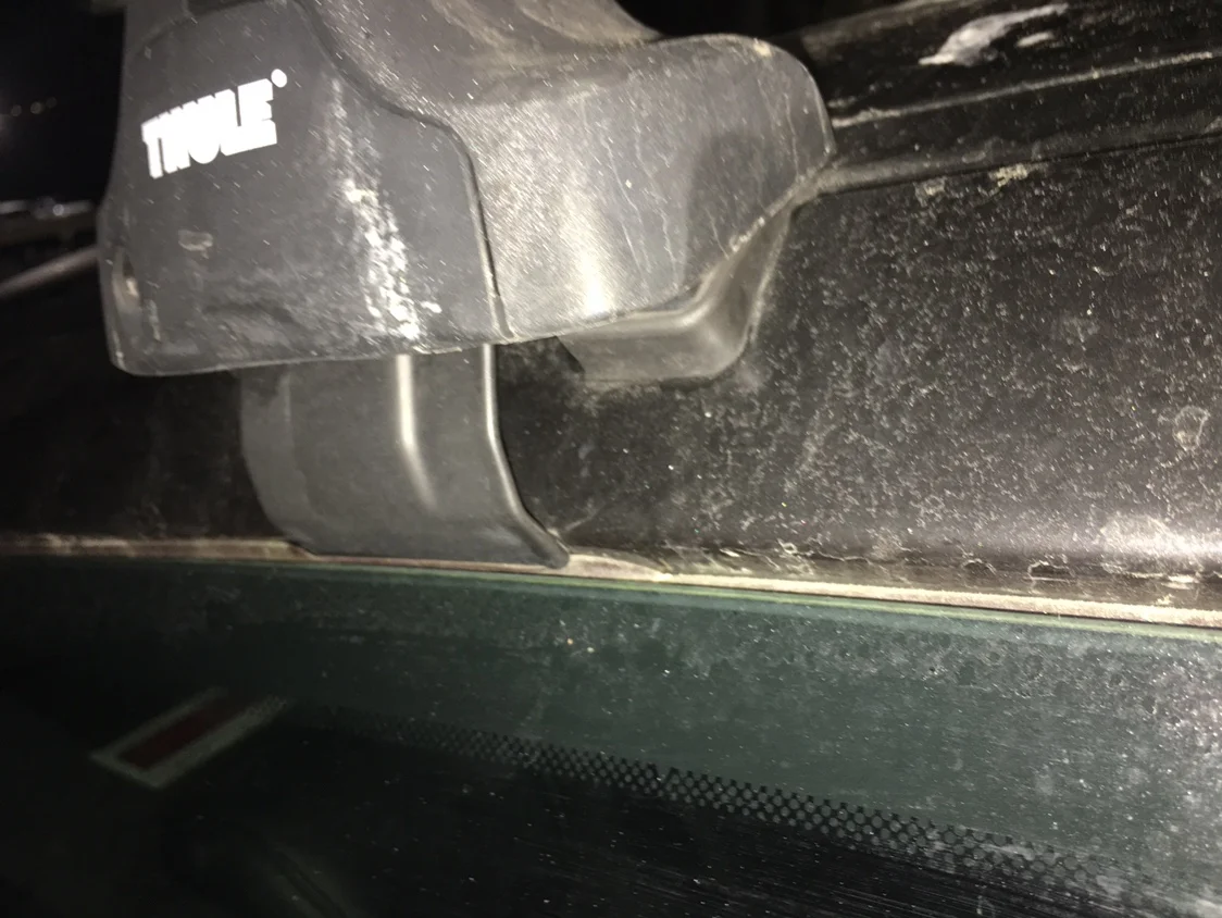

If I get chance today, I will get some pics of how they sit
