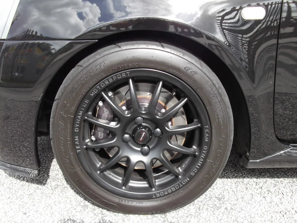

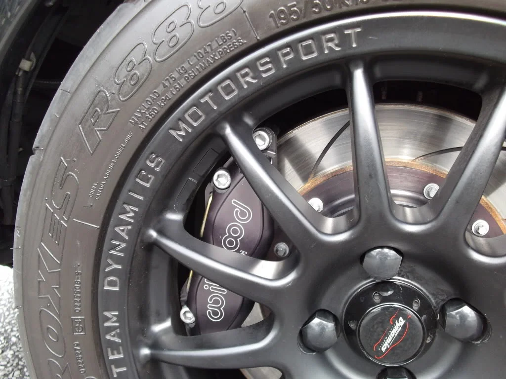

Got some Willwood 4 pots with AP discs last weekend off a member on here (thanks Mark). Fitted them this weekend and was a bit worried about them fitting under my 1.2s, but as you can see they fit... just, had to remove the inner wheel weights as they were catching so had to get them rebalanced with weights moved in a bit.

Hi Dom, glad they fitted ok and they look great! Incidentally I didn’t have to remove any weights on my F1's or 2118's - so may be the 1.2s have a fraction smaller ID. Mark
