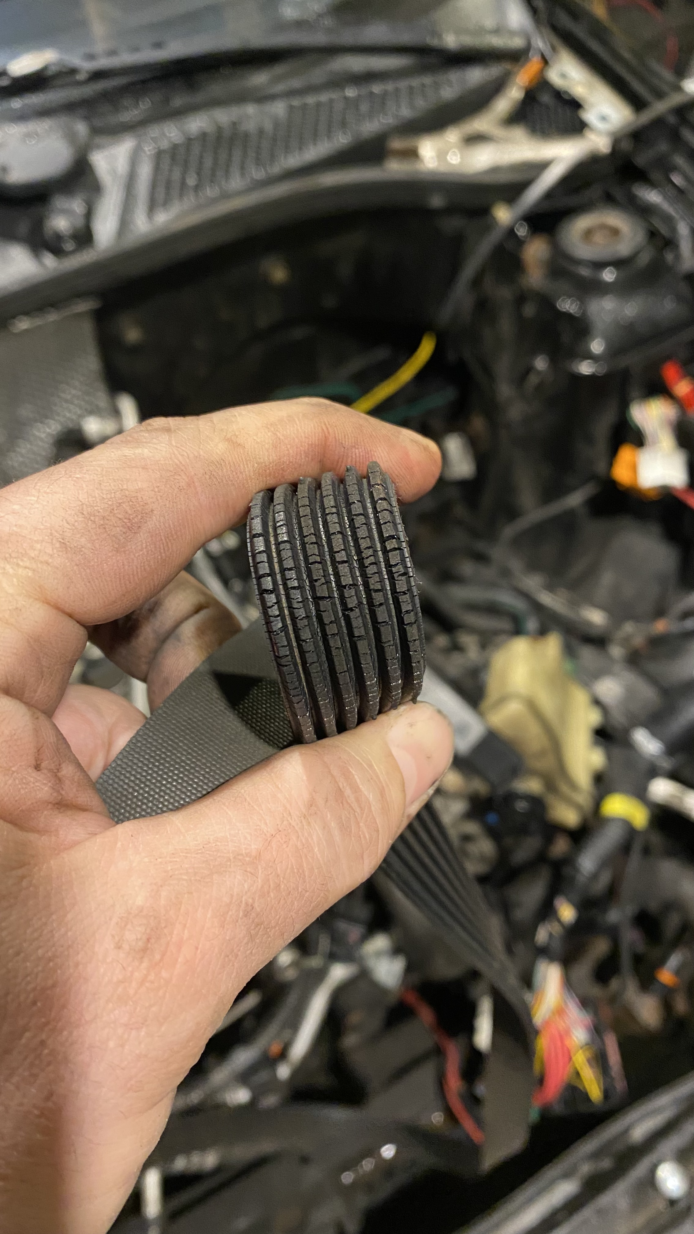

This was my aux belt at about 6 years old. As above, inspect that and change as needed. My timing belt is now about 8 years old but looks spot on and has covered about 8k miles. No chance is it being changed

As above, aux belt is the real enemy, also the aux belt tensioner seizing on its pivot. The aux belt snapping will kill these engines by wiping the timing belt out as they let go.

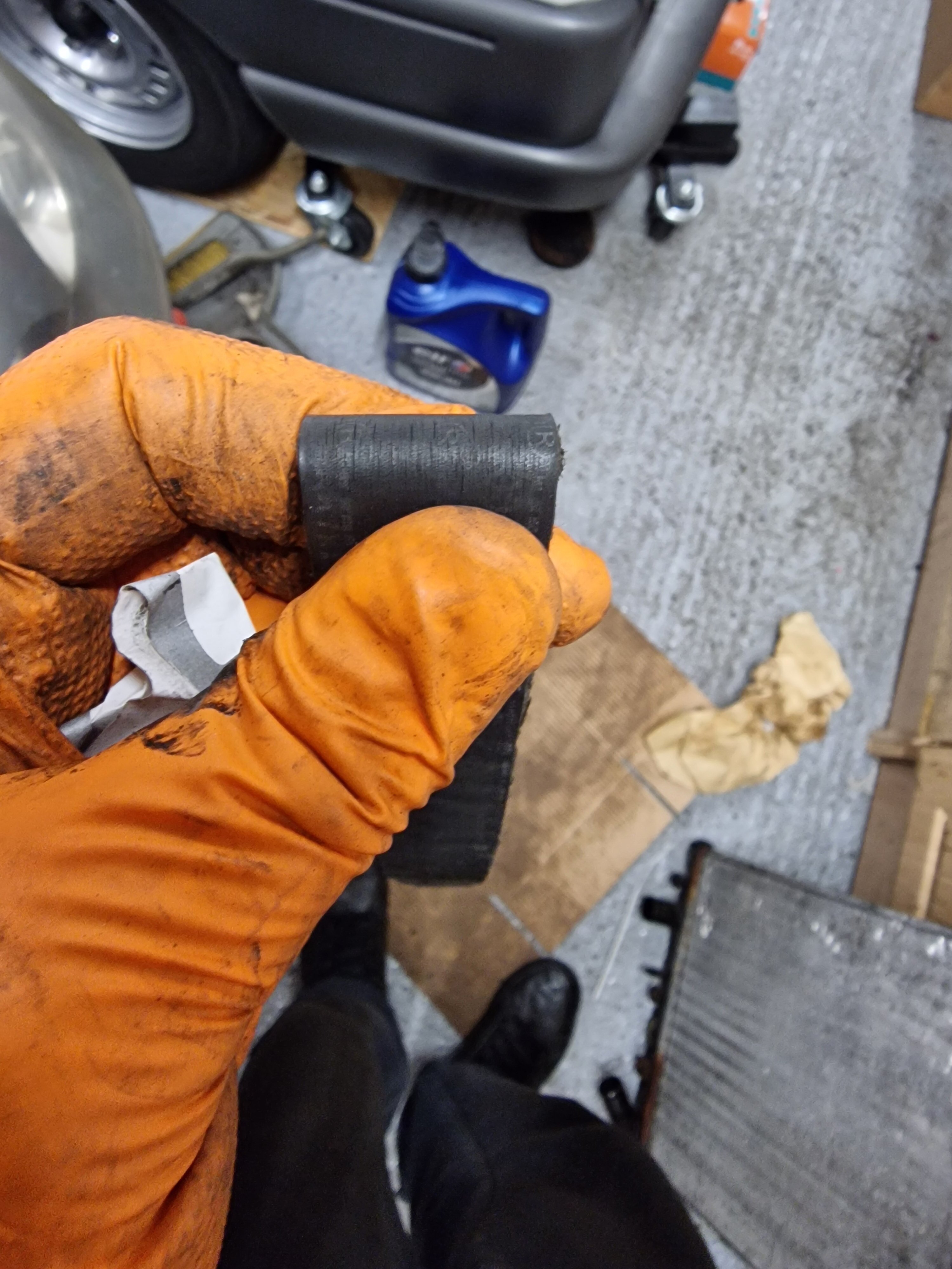

My 8 year old gates cambelt off my dci that had done around 40k looked ok when fitted could still almost see the writing.
When inspecting it properly, deteriorating/well passed its best. Tensioner still appeared to be fine.
i dont doubt they can run a couple of years longer if car is stored indoors and mileage low, but how long do you push it for is anybodys guess.
