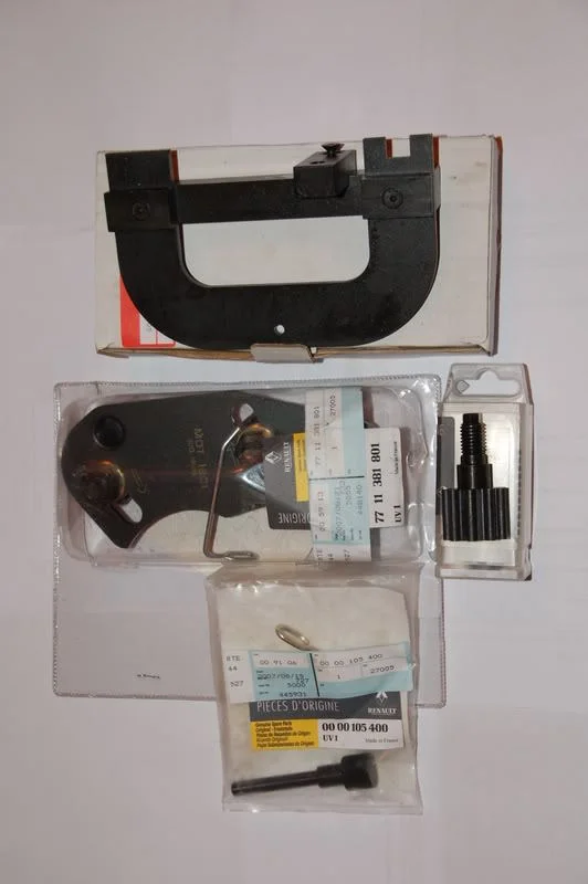

timing belt tool kit
yes. u also need a tool for taking the tension off the aux belt, and the tool for locking the top pulleys, renault tool mot 1509
wont the top kit do the pulleys ? it looks as it has 2 pegs to push into the pulleys or is there a tool to hold the pulleys whilst undoing them ??
the pin lcoks the crank, the flat bar holds the cams in the tdc position. mot 1509 is used to lock the top pulleys so they can be slackened off. Your supposed to slacken the top pulleys, tension cambelt, turn the cambelt over to distribute the tension. then tighten bottom pulley on and tighten top pulley. some people probably dont bother but then you risk the timing moving slightly
this is everything

Yes thats the aux belt tensioner tool. That lot will set you back about 60 sheets for both, do a search on the part numbers you'll find a few places sell them on the net.
