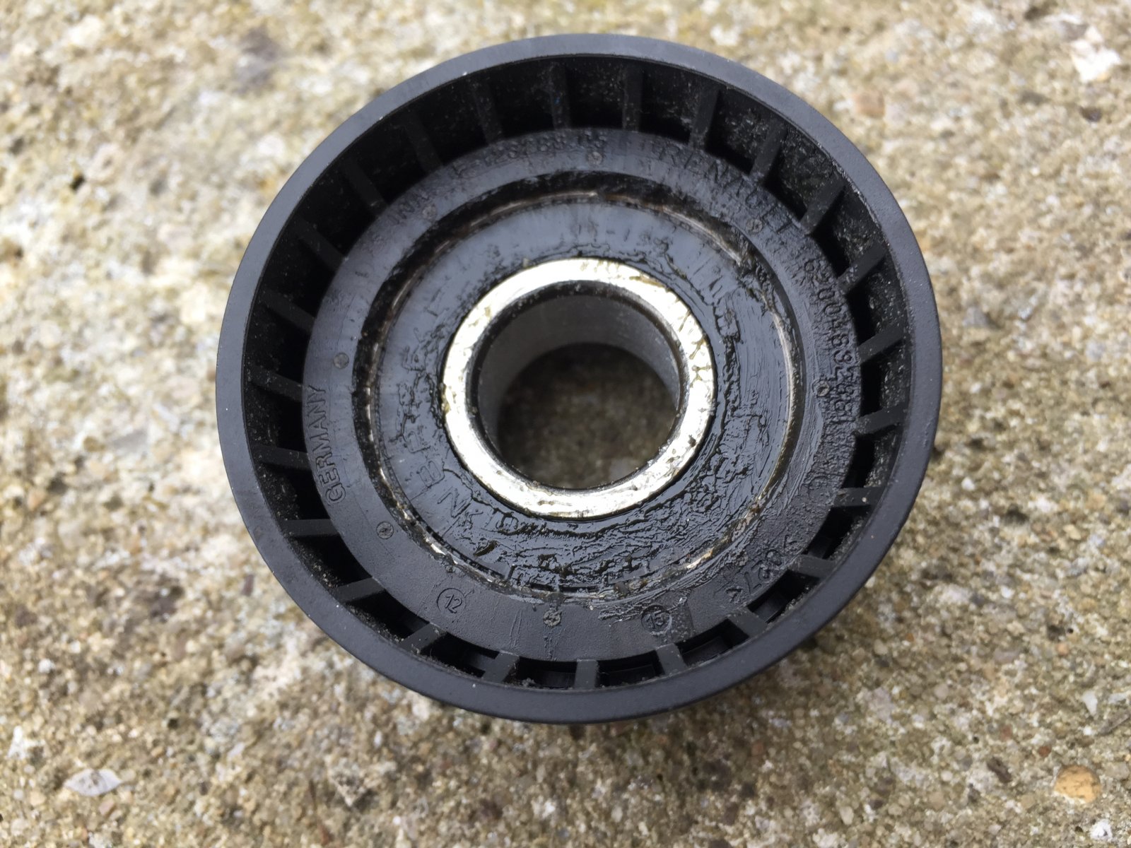

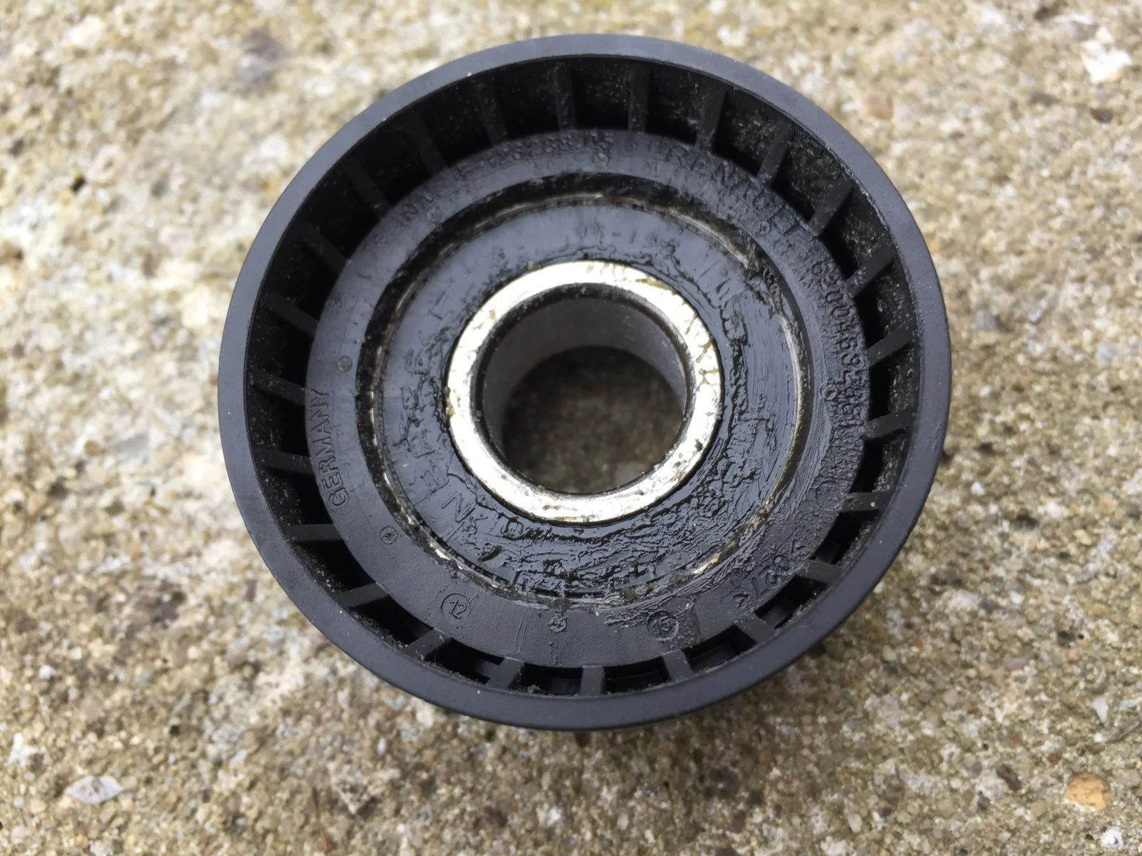

Bearings don't like being sat idle for long periods and I've seen plenty of genuine Renault timing belt kits with seal failure on the bearing as early as 18 months after replacement
