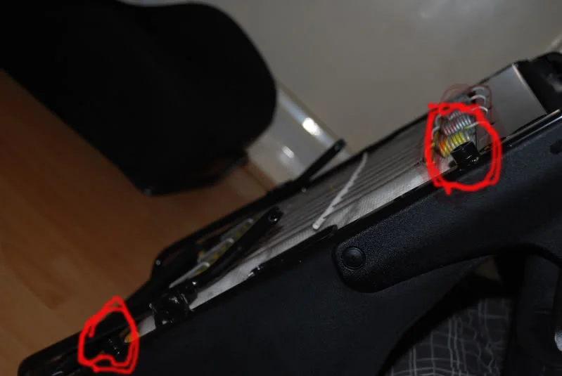

to fit my recaros
  laguna coupe
do i have to chop this bit of the evo seats so it is all flat
  e92 + E46 M3 + Cup
I take it there the Evo MR's, If so, Yes we chopped them off when we fitted them to tompoms 182, you will also have to open up the new recaro mounts subframes
yeah you need to cut the notches off, the recaro to clio frames need to sit on a flush face.
