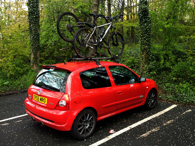

What's the issue with roof mounted ? My Thule kit is superb and had two bikes on the roof at Autobahn speed with no issues.
https://flic.kr/p/odQnRZ

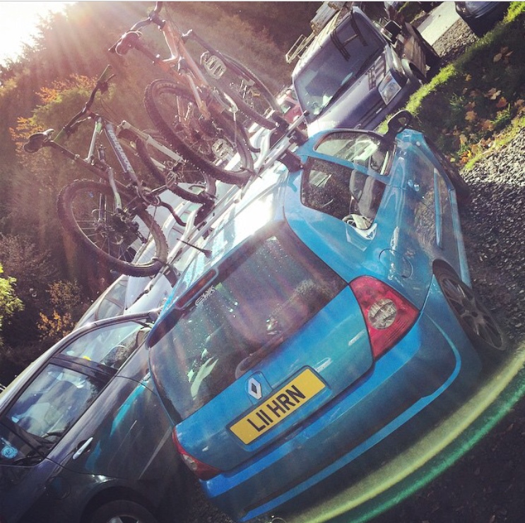

Err think I paid £180 for the bars for the Clio but already had the bike holders. These are the top Thule ones.. They're about £90 each normally but I think Ford do them for about £60..
You can buy the cheaper ones but I'm a tart and love the ali ones !
