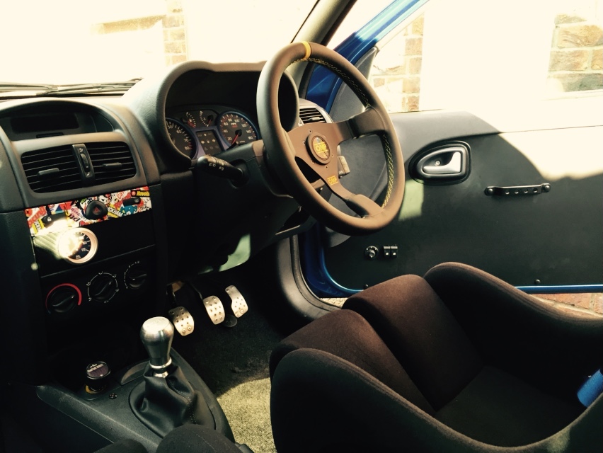

As above just go for it :) Mine's a 100% track car but I just don't like the bare metal strip it to hell look, so did my own version, most of it was probably just an excuse for something to do lmao but I'm happy with it. All under carpet sound deadening and foam removed but carpets back in :)
Door cards cut down ready for the cage

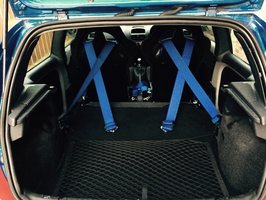

Acoustic carpet to tidy up the rear
Thanks guys, definitely a good plan to treat those bolts so I'll do that. Mark you said the door cards are cut down for the cage? I didn't realise that was required?
Also am I likely to stumble across any wiring challenges, or can I just secure everything down where it is?
The SD cage does fit with the standard door cards but it just touches where the arm rest is.
