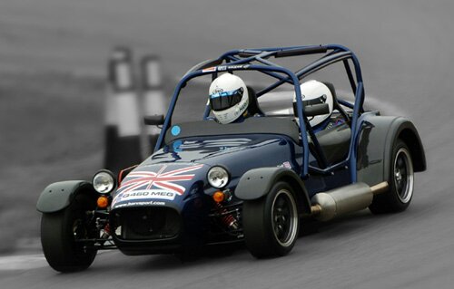

Because nothing touches a caterham with north of 500bhp/ton for fun
