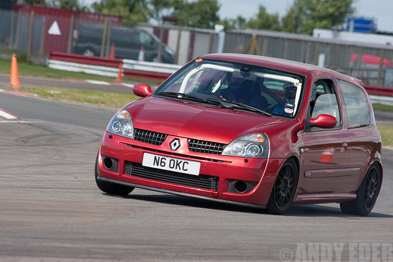

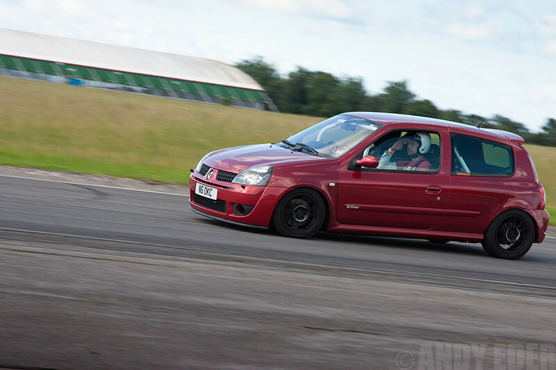

It is worth saying though, that my car wasn't exactly "slow" with the bilsteins on track. It kept up with most stuff and was great fun. But as you can see, there was a fair amount of compression;
