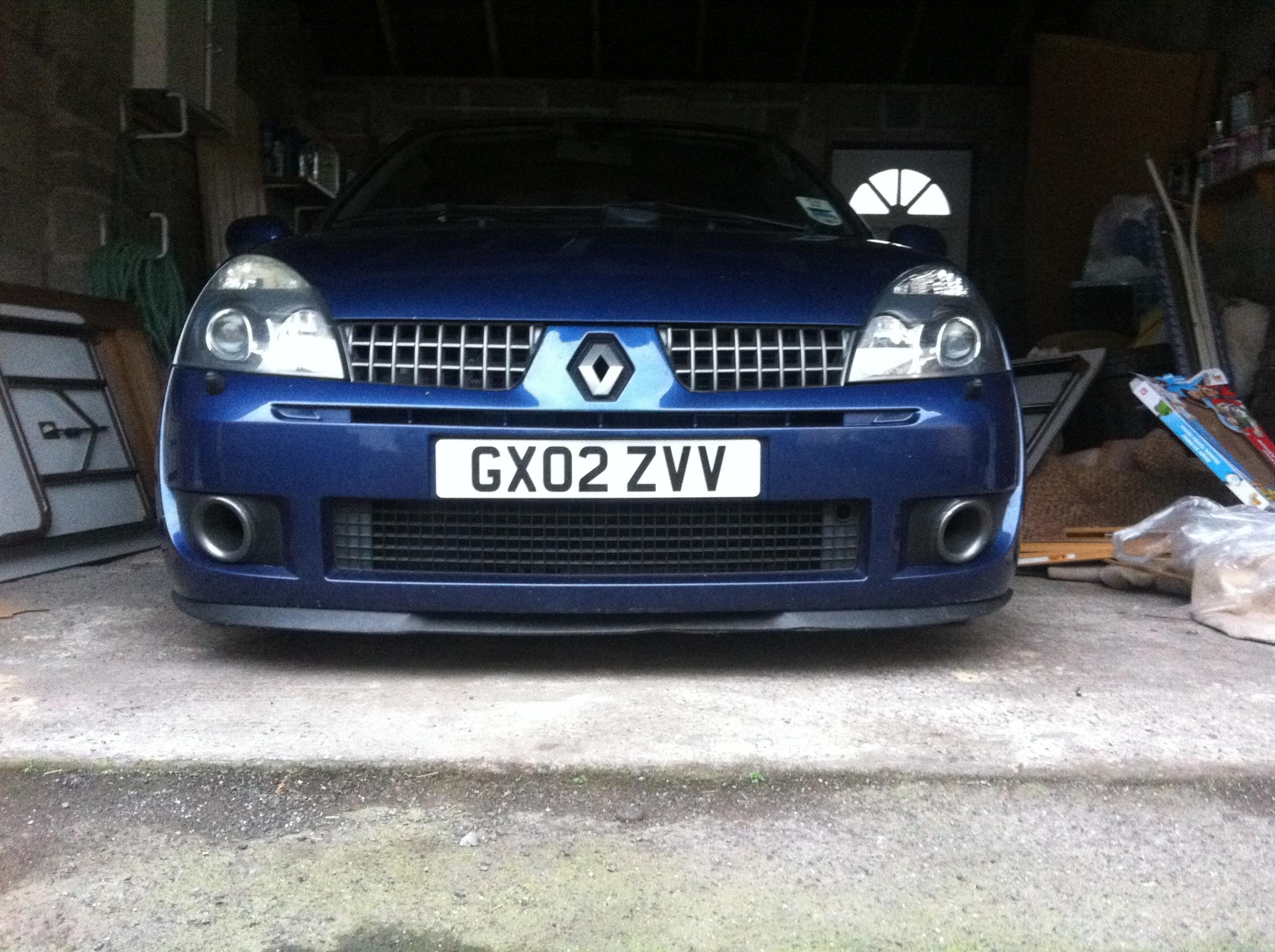

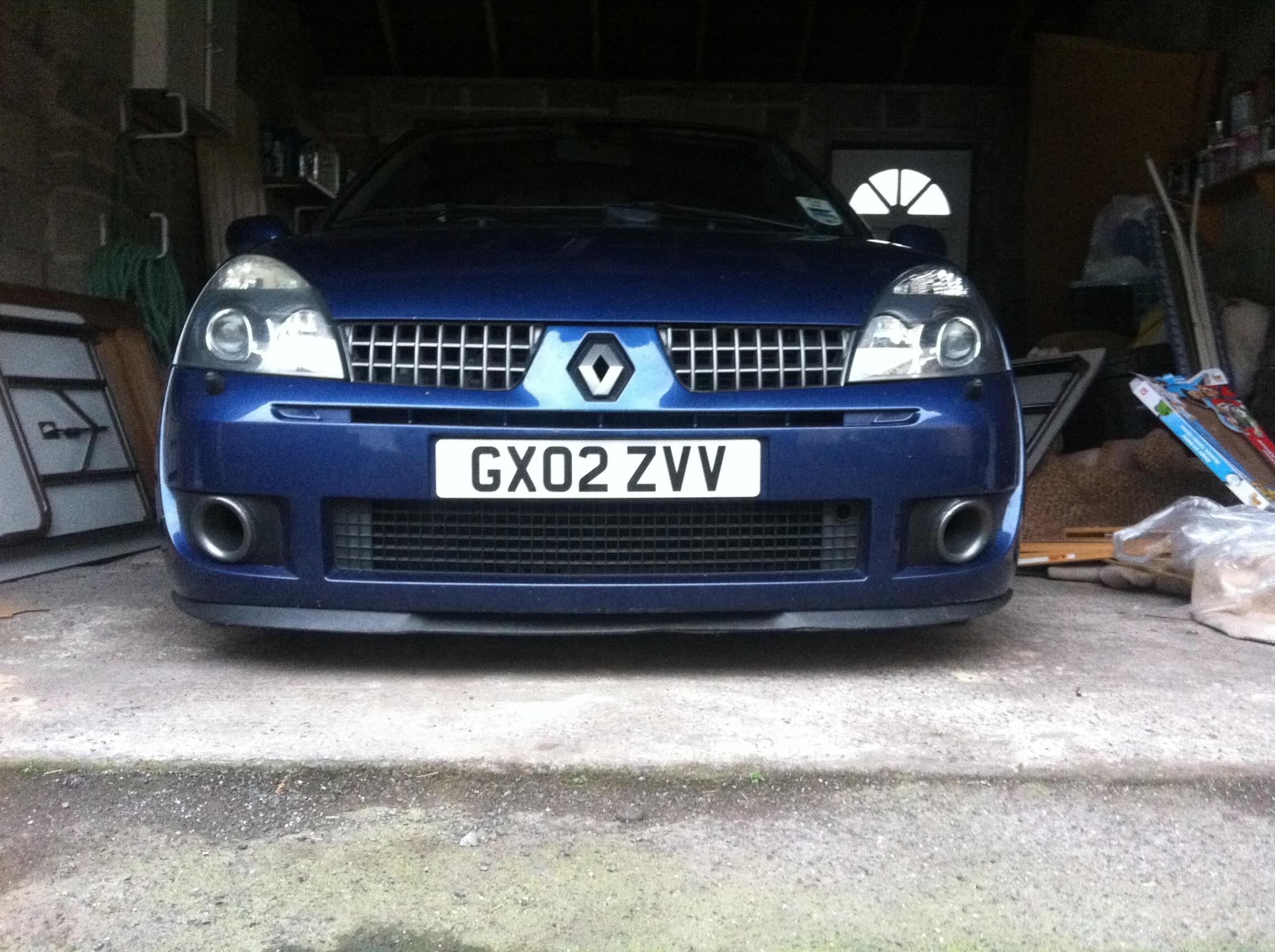

I have one on mine, taking it off today to put the fog light back though. It was on the car when i bought it.
[/IMG]
It had to be secured in place using zip ties but fits in perfectly.

Well the lip is bigger than the fog hole so the lip rests against the the fog surround. only a little bit though. at the back of the trumpet there are holes either side which i have used to put zip ties through and connect with the cold air feed going up to the air box!
Didnt manage to change it over today but itll be in the sale section soon if you're interested;)...

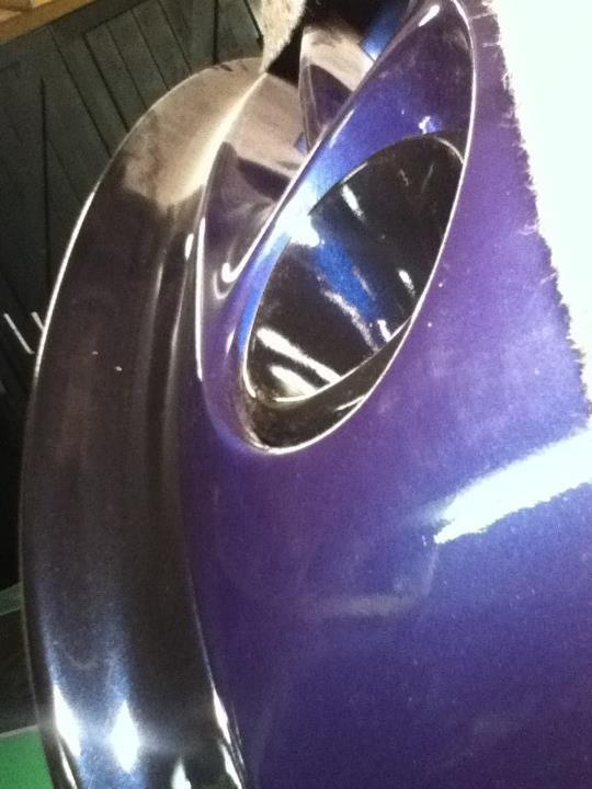

I made my own by sacrificing my fog lights lol...
Before paint
Diffrent car I understand but can easily be done on a Clio :)

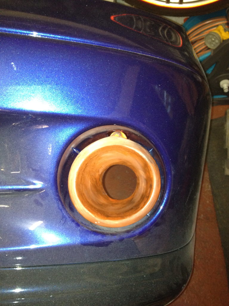

Here's the dims and web address for the ones I purchased on eBay. I had to bond them in but they've been in for 6 months now.
Outer Diameter Top of the trumpet: 110mm
Inner Diameter Top of the Trumpet: 80mm
Outer Diameter Bottom of the Trumpet: 66mm
